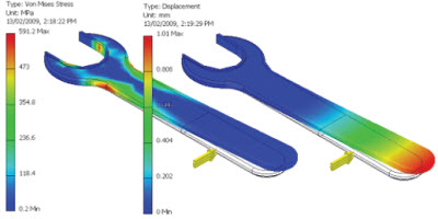

Ed, I didn't dream up the structural compliance theory out of thin air. Mechanical engineers routinely calculate the deflection under load of simple shapes such as beams and rods, be they made of wood, steel, cast iron, or whatever. For more complex shapes, they use structural finite-element analysis software. The software breaks the complex shape down into a "mesh" of elements with simple shapes, for which solutions are known. Then it solves a whopping big system of simultaneous equations to determine the deformed shape of the object.
Having originally forgotten that "if there's no pic, it didn't happen", here's a pic: :D
[ATTACH]26792[/ATTACH]
Both images show a model of a wrench under load. In the image on the left, the colors indicate the internal stress (i.e. force per unit area) of the material. Given the "modulus of elasticity" (sort of a 3-dimensional spring constant) of the material, then the deformation ratio of each element can be calculated. The image on the right uses color to indicate the total displacement of each element from its original unloaded position (represented by the line drawing).
Here's the site from which I stole that pic. It does a much better job than Wikipedia at explaining the concept, in something close to plain English.
Wrench FEA.jpg (18.61 KiB) Viewed 2739 times

BuckeyeDennis wrote:Ed, I didn't dream up the structural compliance theory out of thin air. Mechanical engineers routinely calculate the deflection under load of simple shapes such as beams and rods, be they made of wood, steel, cast iron, or whatever. For more complex shapes, they use structural finite-element analysis software. The software breaks the complex shape down into a "mesh" of elements with simple shapes, for which solutions are known. Then it solves a whopping big system of simultaneous equations to determine the deformed shape of the object.
