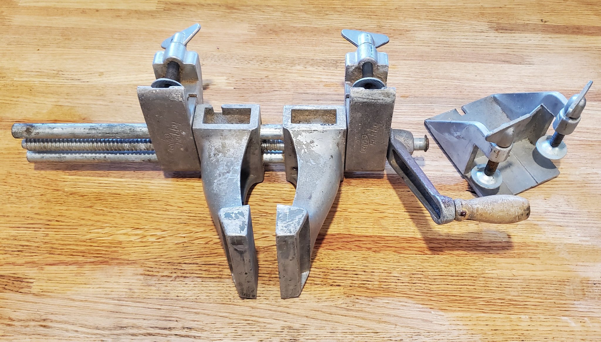

I continued my fascination with the Zyliss vice and its history by buying an original wood-handled model branded with earlier "Zylyss" spelling.
Lots of minor differences such as the design of the handle arm, lack of quick-release, and lack of notches in the base for mounting accessories such as "lower soft jaws". There are also spring pins holding the way bars to the right jaw.
The table clamps have a smaller mouth and the springs are much weaker. Once I got past the dirt, paint, and corrosion I found the overall original finish was not as refined as my later model. I smoothed some of that with progressive grits before polishing.
When this arrived nothing moved. It took me hours just to get it to move, and a few more to disassemble.

Paul- can you list the steps you take to clean up those surfaces? Your results are great and I'd like to
give it a try myself !

Hmmmmm. Typewriter, slide rule, zylyss vise.
Starting a museum?
Yes how did you get that shiney finish.
