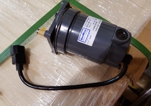

by everettdavis
Unlike in the U.S. the Feed Motor European 240v Model Planer has the Von Weise Label on the motor opposed to a less descriptive Shopsmith Inc one.
It doesn't answer the Brush Holder Question, but it is another piece of the puzzle.
Everett
