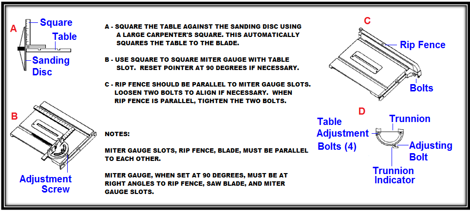

Honestly my way seemed logical to me. Last year when I was restoring the 10E and 10ER Manuals, I guess it seemed logical to the folks at MAGNA too as the conclusions I had come to, were recommendations they had made before I was born. See attachment FIG 16 which came from the 10ER version.
FIG 16.png (79.55 KiB) Viewed 23784 times

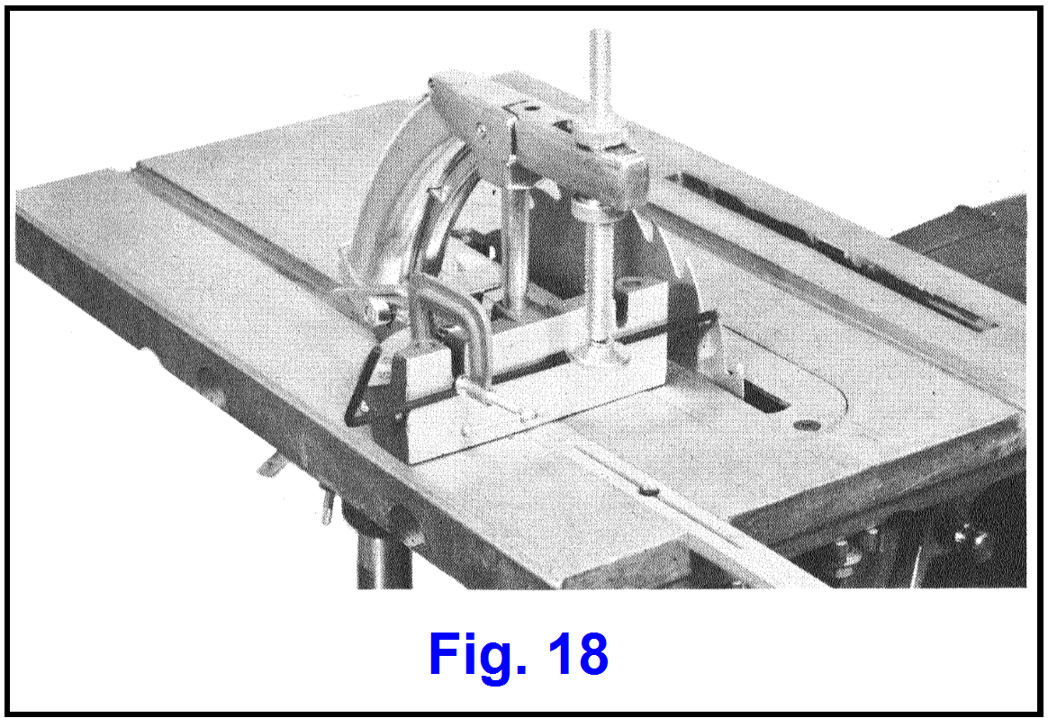

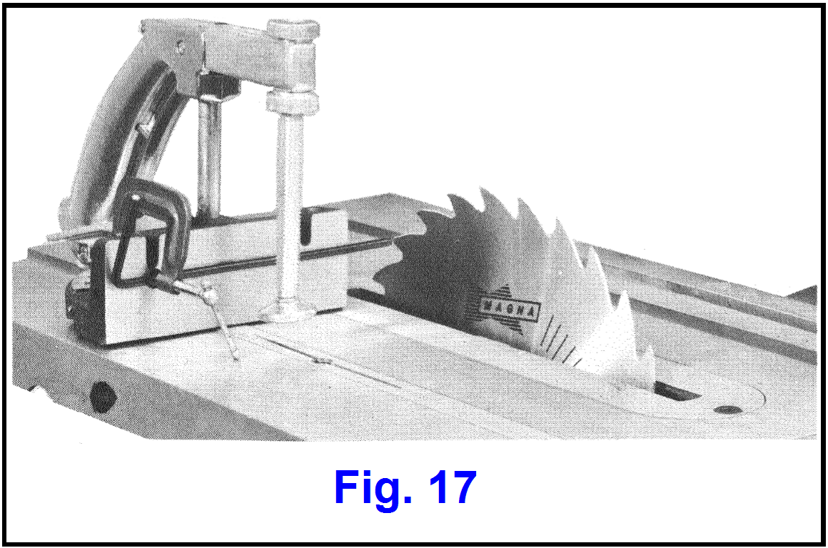

I have attached photos from the recent Mark VII manual I restored (FIG 17) that R J DeCristoforo prepared in the 1960’s where he shows a very simple method that would suffice in lieu of a Dial Indicator. FIG18 shows it slid through to the opposite side of the blade to verify it is the same.
While he shows using the Saw Blade in this photo (which has offset teeth) I prefer the Steel Sanding Disk (use the other Miter Slot) as I document in the document My Method to Alignment. You could easily use this method without the dial indicator to align it.

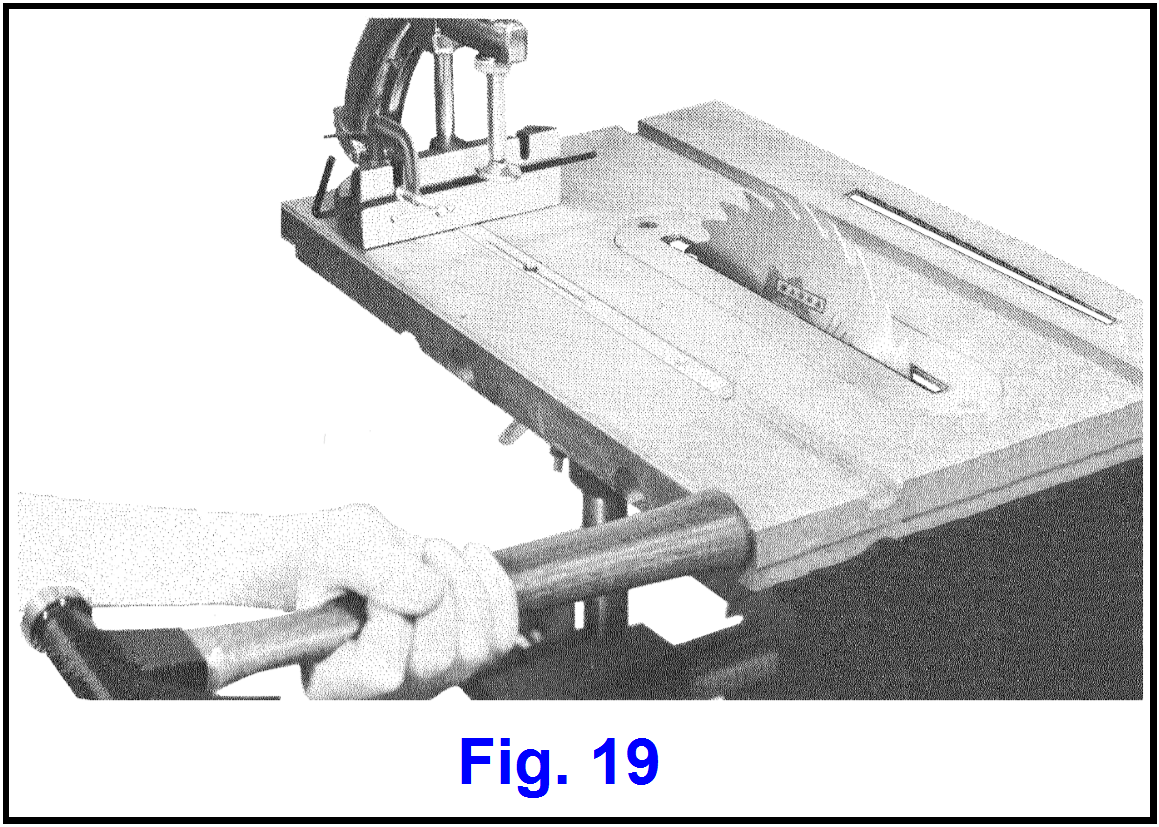

After loosening the Table adjustment bolts, FIG 19 illustrates R.J. gently enticing the table to move into alignment before tightening bolts.

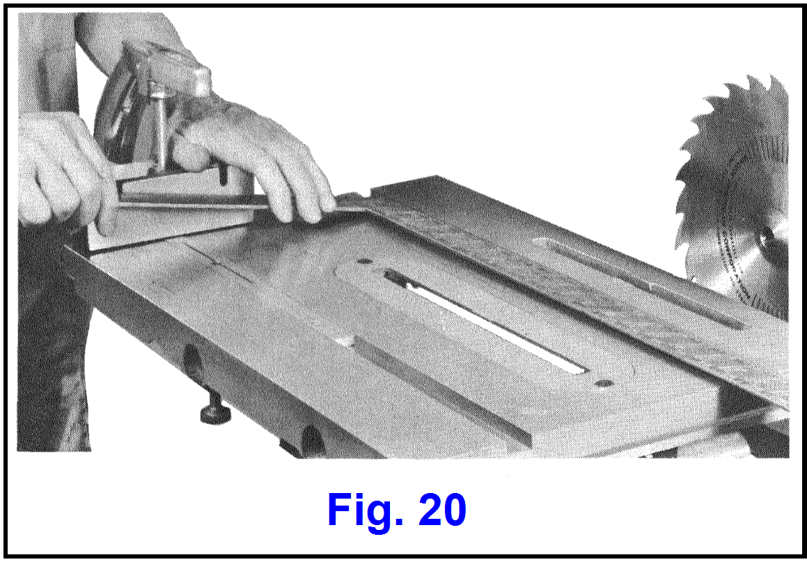

FIG 20 illustrates making the Miter Gauge at right angle to the Miter Slot to set the 0 reference point, and yes, those are his hands.

The "What can one crosscut tell you?" was a method to see IF your gear is aligned or needs adjustment. The "My method to Alignment" is a primer on how to approach it, to fix what is wrong.
