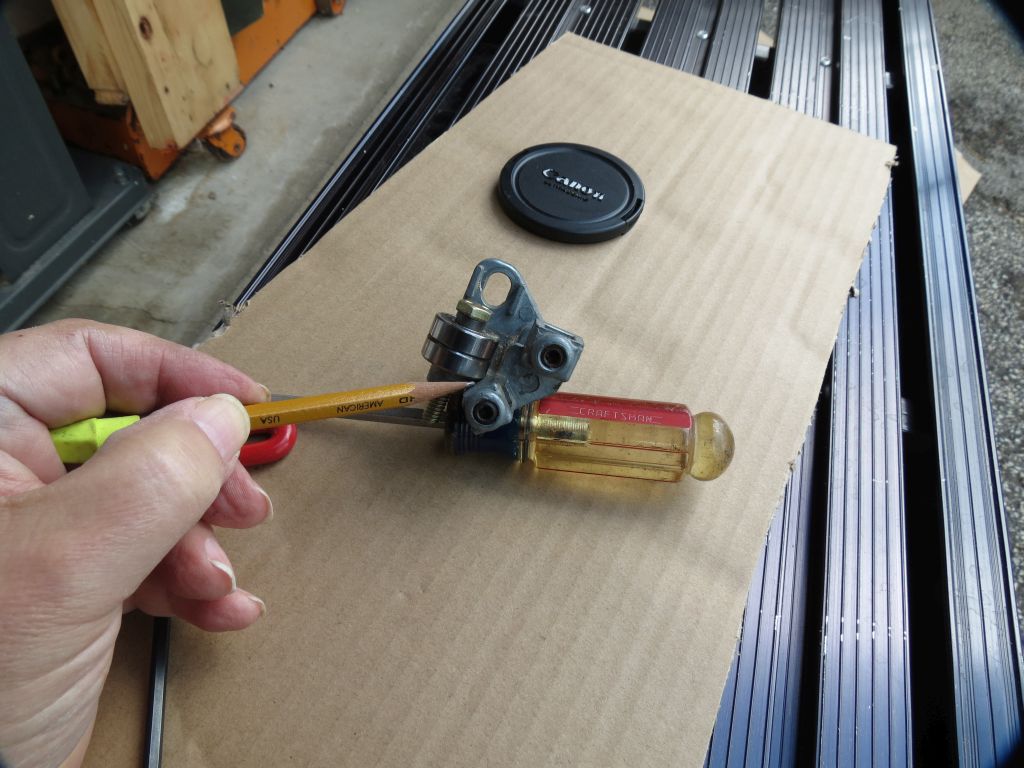

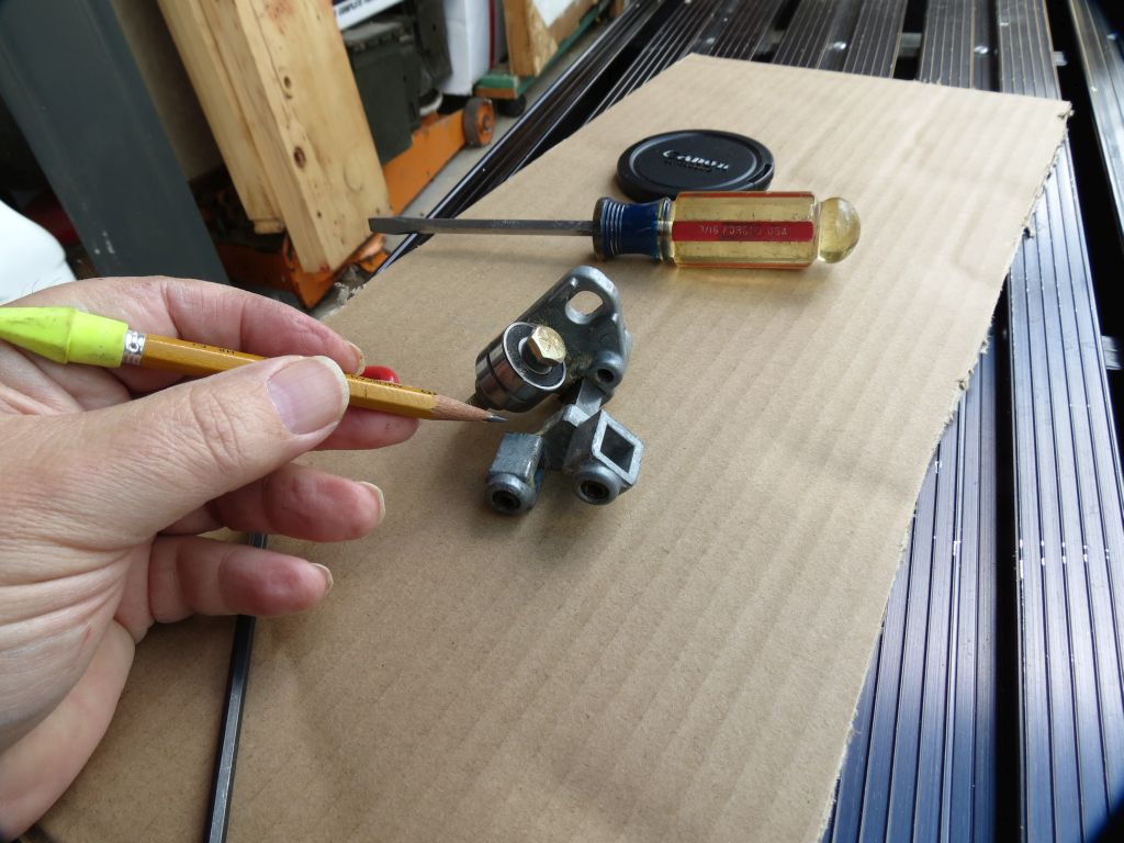

Second I found I had a minor issue with the lower bearing where when the blade guide is fully retracted (smallest blade) then the one of the bearings was contacting the aluminum of the housing. Since I normally don't use really small blades on this saw so I never saw the problem but wanted to fix it anyway. Here is a picture with the guide blocks out for say a 1/2" wide blade.

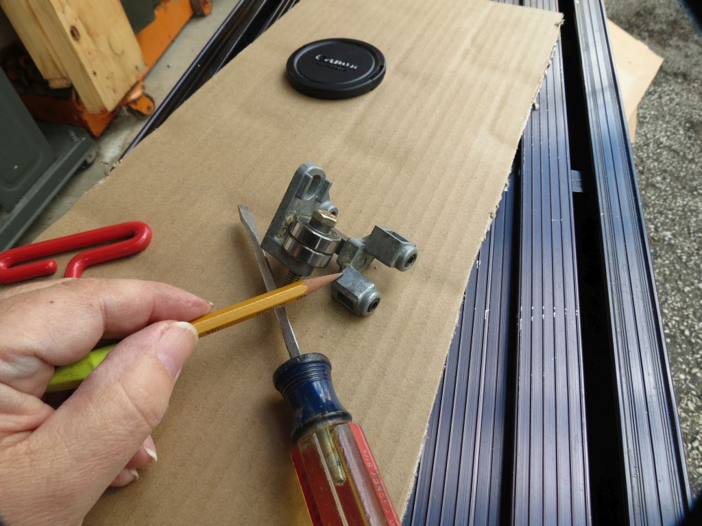

If the blade were very small then the adjustment would cause conflict as shown in this picture:
In this picture you can see where they contacted:

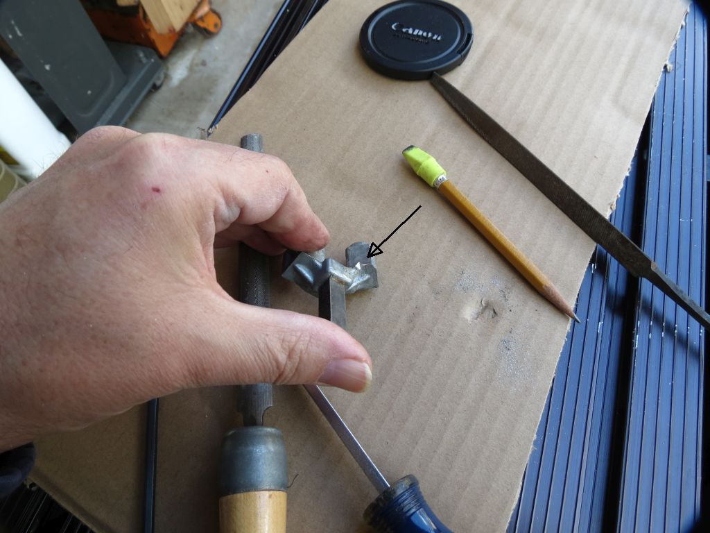

It was a simple fix. Used a file to remove a minor amount of material and tested to make sure the contact was gone. In my case the bearing needs to be positioned far to that side so that was about the only solution that made since. I hope you can see the shine of the fresh filing that was done, well that an the arrow should help.

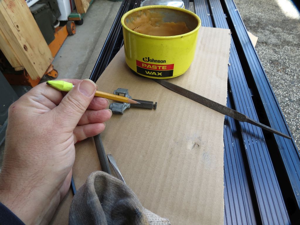

The whole purpose of this exercise started out to be a simple cleaning and waxing of the mounting post but then I got carried away. Here is a picture of the area I started out working on.
