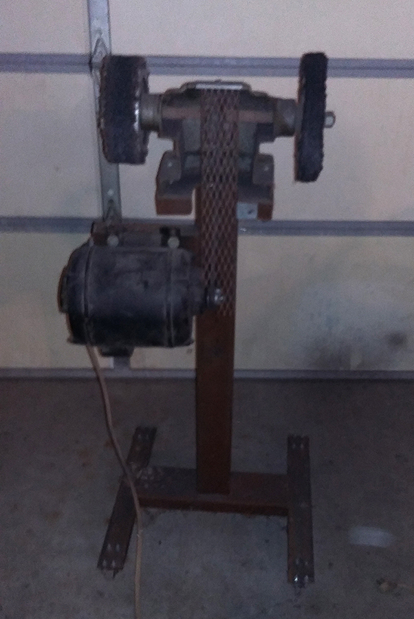

reubenjames wrote:Looks great--what was your process / equipment for your aluminum polishing?
When I was restoring cars I had a double Shaft grinder stand I built, I took the stones off and went to the local chrome shop and aquire several of his used and worn down to about 10" diameter buffs, to small for his use and got two sets, one for finish buffing and 1 set for coarse or initial buffing. I buy my stick compound from a hardware store, black for initial quick cut and red for finish buffing on aluminum. I think the small buff discs you can buy at Menards are too small to really do a good job. Anybody can do a good job of polishing with a similar set up.Here are a couple of pictures, quality not that good, but you can see my set up. I use 3 finish buffs and 4 coarse buffs.Hope this helps.
Buffing Stand.jpg (536.54 KiB) Viewed 4182 times
Buffing Stand Back.jpg (372.81 KiB) Viewed 4182 times
