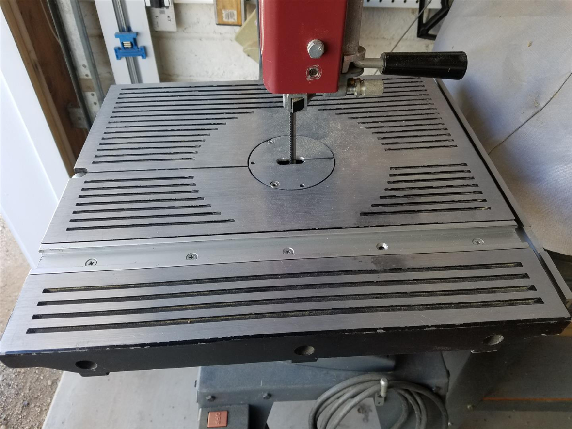

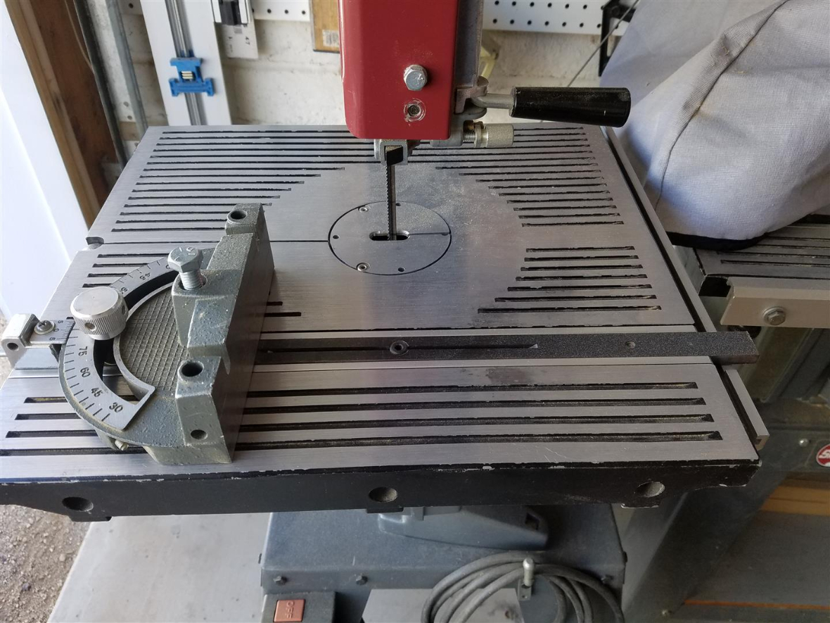

I received my "new" table today. The first thing I noticed was no envelope on the package for the shipping document and return label for the other table.
Inspecting the table I noticed that the back end of the t-slot extrusion was above the table. Ok, I grabbed my phillips screwdriver to snug down the 5 screws because they were all loose. Extrusion still above the table a hair.
I installed the bar for the fence and visually saw that it would work. I tried to run my miter gauge through the t-slot and it wouldn't even start to go in. I removed the extrusion to inspect it and noticed that the slot bottom wasn't milled. Just straight, black casting.
With the extrusion removed it slides along the miter gauge bar easily. I re-inserted the extrusion and the screws. It took some time but I had to find the "sweet spot" for the screws, which is too loose for me. The miter gauge slides through but the extrusion is still above the table in the rear.
The extrusion is about table level in the front, low in the middle and above table in the back.
Is anyone else's table slot not milled?
I'm feeling really irritated with this. Maybe prices are increasing to put more money into QC....hopefully.
Image"New" table on the left

Are you reporting that your miter bar will not slide into the aluminum extruded? miter track?
I don't believe that either of mine are milled. I have always assumed that that was part of the reason for the aluminum miter track insert.
Can you not secure the miter track in the groove by simply tightening the five screws?
Is the clearance issue eliminated if you shim the new table as you did the original one?

I am saying that the table slot is not milled flat. Casting irregularities in the bottom of the slot. When I snug down the 5 screws for the t-slot extrusion it is warping the extrusion so that my miter gauge bar won't go in, at all. If I back the screws out to "loose" the miter gauge bar goes in.

Is the aluminum extrusion that has the notch milled into it shown attached to the table on the left in your latest photo image? If it is, it is installed on the wrong end of the table.

dusty wrote:Is the aluminum extrusion that has the notch milled into it shown attached to the table on the left in your latest photo image? If it is, it is installed on the wrong end of the table.
No, the fence bar is on the right side/rear/backside of the table.

I installed the t-slot extrusion from my "new" table into my "old" table with milled slot bottom. I snugged down all 5 screws and my miter gauge bar goes in and slides just fine.
To me, the problem is the slot bottom on the new table is not milled flat. The t-slot extrusion is still above the table in the back.
