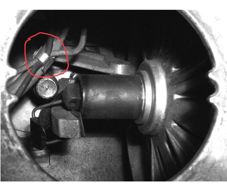

Found this pix in the "google Drive" Buying a used shopsmith.roneg wrote:
Couple of things I noticed, with the parts exposed upon motor removal. The switch wires have been coming in contact with some moving object (rubed through insulation)..I'm guessing Main belt. Is there some diagram, or routing..wire clip, or suggestions? Also since there is no color coding on my motor wires, and none on the pig tail what is the proper way to wire the (new switch), to motor? I will be installing a new/used pigtail with quick dis-connect connectors Blk, Wht, Grn also.
I have seen no other reference to it it's not in the parts explode.
- wire clip.JPG (72.6 KiB) Viewed 13425 times

There is actually a clip that attaches to one of the control quadrant screws. I don't see it on the parts explode. I noticed it on a 1989 machine I just bought. Anyone know the part number?
I could try and "jimmy rig" something, but prefer the OEM item.

There is no vintage accurate item. I would 'settle' for using plastic cable tie(s). That 'clip' was a thin piece of aluminum with a slot in one end for the other end to be inserted after wrapping around the wires. I consider the plastic wire ties to be an improvement.

Hum..that would serve to gather them together but not much in the way of keeping them away from moving parts.
The newer model 510 has a retainer clip that seems to screw in along with one of the three speed control assembly screws..thereby pinning the wires to the side and away from afore mentioned moving parts. Have no clue what the part number is.

Cable ties with a mounting hole do exist.
Re: V-belt replacement
Oh yes, of course..some reason my mind went to standard "wire ties". Sorry JPG. That was actually a brilliant suggestion. Sometimes..the simplest things elude me!
