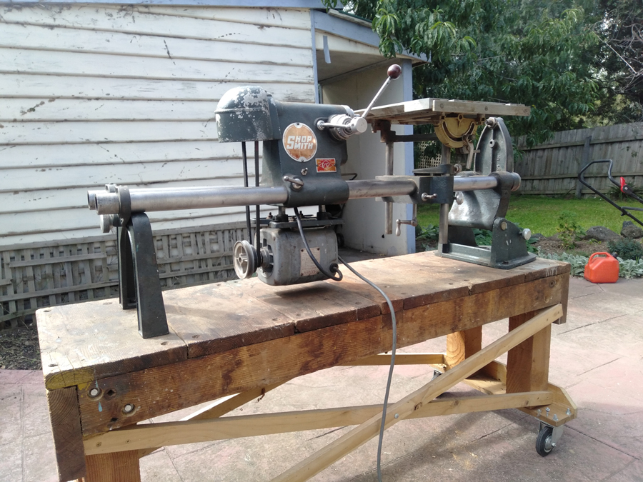

Identifying the version of the parts will help in telling when it was made. I do not know if entire tools were made in the US and than shipped the Australia but there was a company licensed to make and sell them there. There are Shopsmith tools around the world and have gotten there by many means. A Scroll Saw I once owned is now in Australia.
Below is a picture of Shopsmith Model 10E S/N 899 from Australia also without the A prefix. It has Model 10ER parts but is referred to as a 10E in Australia. There is an additional plate on the headstock for the company that made them in Australia.
Australian 10E S-N 899.jpg (475.36 KiB) Viewed 36830 times

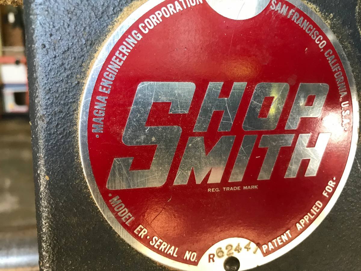

One of the things I take note of now when looking at Shopsmiths is any anomalies I see. Sometimes an anomaly turns out to be a change in the tool as I find it more times. The brass spacer I found on serial number 1077 on the drive sleeve assembly behind the pulley is an example as I found it again on S/N 1033. Originally, I thought someone had simply added it to their Model 10E S/N 1077 to keep the pulley from being set to close to the headstock casting. Since I found the exact same brass sleeve on S/N 1033 it was apparent that was a part included on the original Model 10E’s that was later discontinued. I didn’t find it on S/N 4708 or any later 10E’s.
Other anomalies can be more perplexing. Previously I talked about Shopsmith Model 10ER serial number RX5010. The X in the serial number is one anomaly there. The others are the position of the numbers not being in a straight line and the size. I saw this again recently with Model 10ER serial number R62441 for sale. Again, the numbers are not in a straight line and are a different size. See the picture below. The normal Logo/Serial Number Plates look like the numbers are machine stamped but in these rare cases the numbers appear hand stamped for some reason. Out of more than 300 Logo/Serial Number Plates I have seen for Model 10’s these have been the only two stamped that way. Could it be the machined stamped plate was damaged somehow during production and it is a replacement? That seem to be a reasonable explanation but still doesn’t explain the X in the serial number RX5010. It makes me wonder how many Serial Number Plates have this hand stamped anomaly.
10ER R62441 Shelton WA.jpg (201.09 KiB) Viewed 34585 times
Picture added back - lost during Forum upgrade
