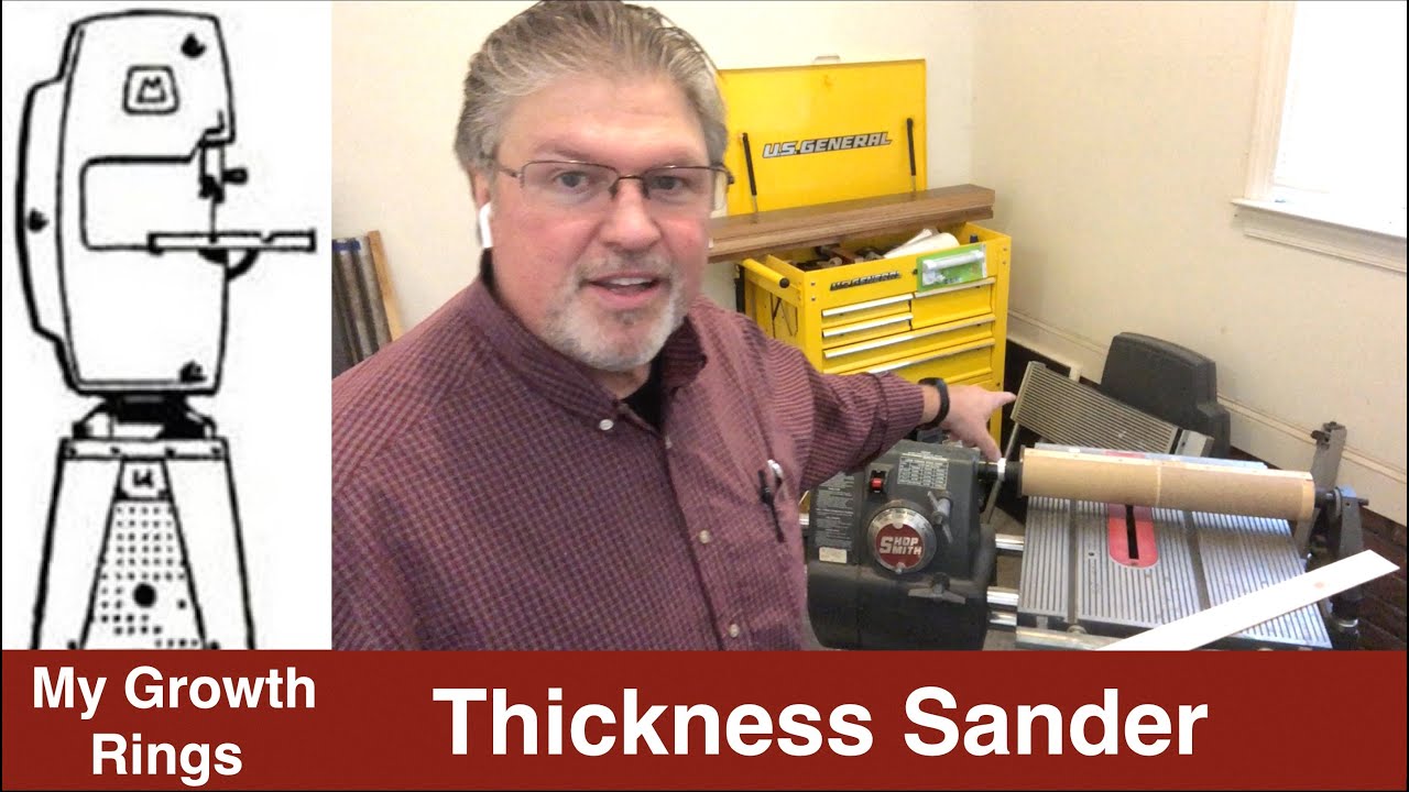

Homemade Shopsmith Thickness Sander, AKA: Lathe-Mounted Surface Drum Sander
Post by Chad »
maxresdefault (2).jpg (120.48 KiB) Viewed 3667 times
Watch it here: https://www.youtube.com/watch?v=y-Eittj38IA
Building a surface sander for your Shopsmith (or any wood lathe) is pretty simple and straight forward project. Several people on the Shopsmith Forums https://www.shopsmith.com/ss_forum and in the Shopsmith Owners Facebook Group have shared their versions so I figure it's time to share mine. I started with the basic design shared in R.J. DeCristoforo's version of the book "Power Tool Woodworking For Everyone" (PTWWFE) but after building a segmented ring project from 3/4" lumber that required sanding, I learned that I needed to take a different approach. That's where this video begins.
Don't forget to leave your questions, comments, and Cheap-shots below and we'll address them during our mid-week video.
0:00 - Intro: Why you might need a surface sander
0:46 - "Power Tool Woodworking For Everyone" (PTWWFE)
2:15 - The basic design
6:00 - The improved design
7:03 - Using the sander
8:40 - Adding a cover and dust collection

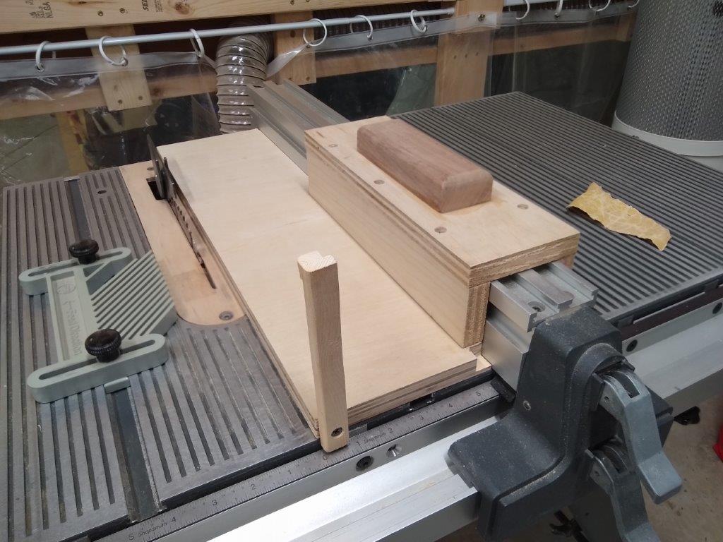

Scott- Thanks for Jack the Ripper - I built something like this to try out. It certainly feels safer than pushing thru the narrow gap...however I'm not 100 % on its safety .
I've noticed on a few passes that once the guide board is sliding along the fence, the guideboard itself will sometimes begin to drift away from the fence behind the cut. This makes me think it could become a kickback item if it were to drift off the fence enough.
Some of this is reduced by the addition of a featherboard on the fence itself pressing down on the Ripper, but it seems like there might be a solution using sliding T-nuts which would still allow for the Ripper to slide along the fence, but disallow any drift away from the fence.
b

I've never had that experience. Is the fence set with a little "lead" to it?

Well- last I checked fence was square to the blade-probably should check again.
I made the spacer board from 1/2 Birch ply- or maybe 3/4 birch ply...its flat and straight.
I guess I should check that it is also square to the blade.
b

STUMPED? Q&A from "Homemade Shopsmith Thickness Sander" and PLANS to come?
Post by Chad »
Watch it here: https://www.youtube.com/watch?v=r81JEkYH7MQ
In this episode of STUMPED? Q&A we get deeper into the details of the "MGR Drum Sander" which we introduced and used in the previous video: found here: https://youtu.be/y-Eittj38IA
There WILL be plans, so stay tuned, or better yet join our mailing list on the blog http://www.MyGrowthRings.com
0:00 - Intro
0:42 - Retraction of criticism of PVC drums
2:25 - Plans are in the works!
3:05 - The Mark VII, Mark 7 and PowerPro can run in reverse
4:11 - Drum diameter 3 1/4"
5:40 - How to round the drum
6:44 - How to true the drum to the table
7:30 - But what about the tolerance?
7:54 - Anti-kickback?
8:34 - Why plywood for the drum?
9:09 - Some close-up details
10:38 - Table hight adjustments
13:09 - A look at the bottom clamps
14:03 - Mounted to the left end of the Mark V
14:48 - Follow for plan details

Dang, Chad. Those thumbnails just keep getting bigger and bigger! Thanks again for the support. Do you ever have a need for a sander like this one? The more I look at it the more I want to change it! Scott
Chad
Posts: 608
Location: West Milton, Ohio
Re: Scott's My Growth Rings youtube channel & website
Post by Chad »
I've always wondered if I could modify and make a wide drum sander with an old Shopsmith planer. The adjustable power feed would be nice. But, if I went through that much trouble; then I might as well buy the real thing. I'd rather make one like yours for as little need I have for a wide sander.

I didn't find any offsets on the fence or the guide board..so i proceeded to over design a solution. Complete with Walnut handle hehe. For me - this keeps the guideboard from drifting away from the fence behind the saw.
b
