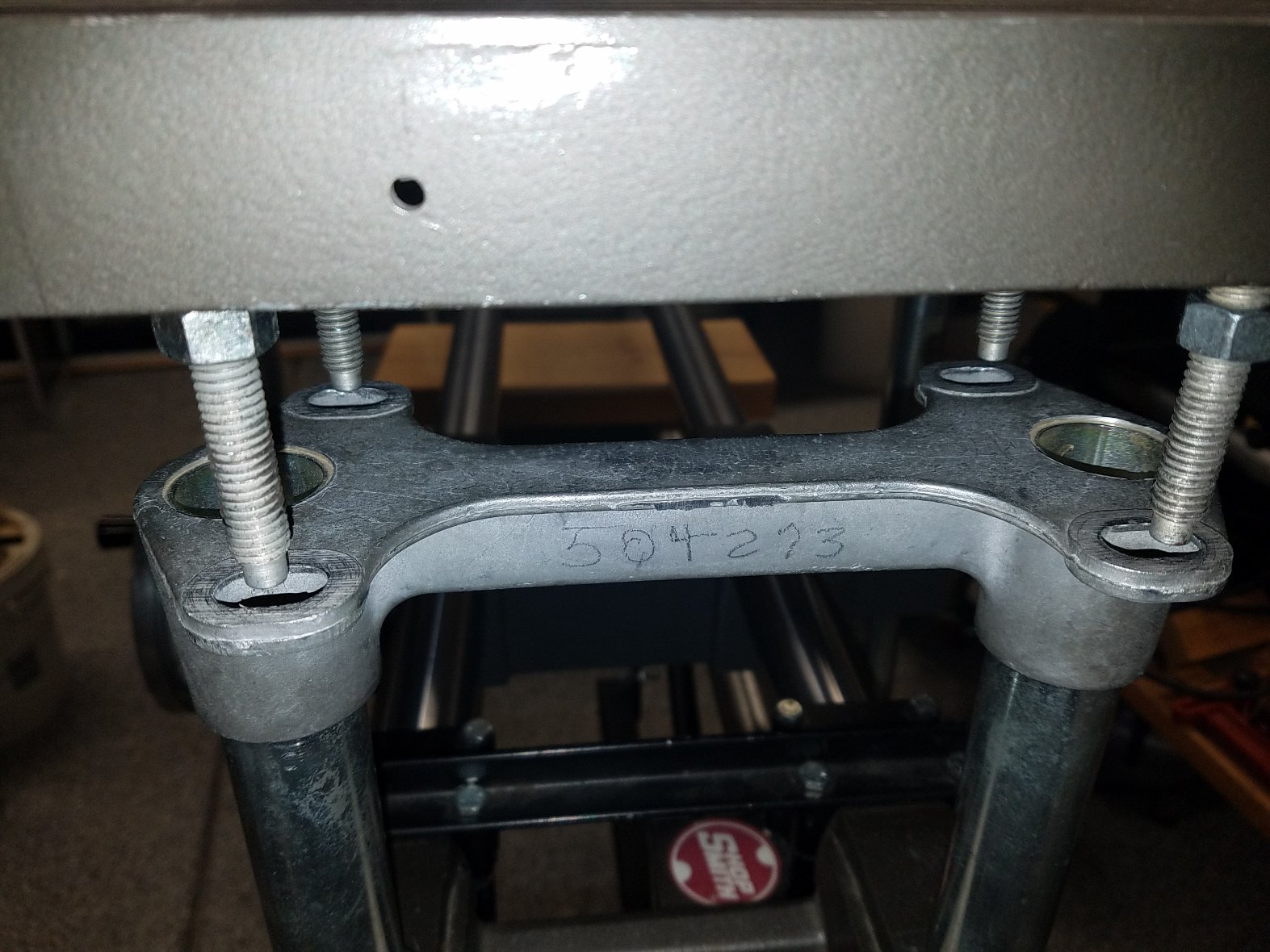

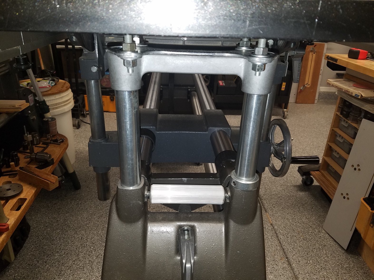

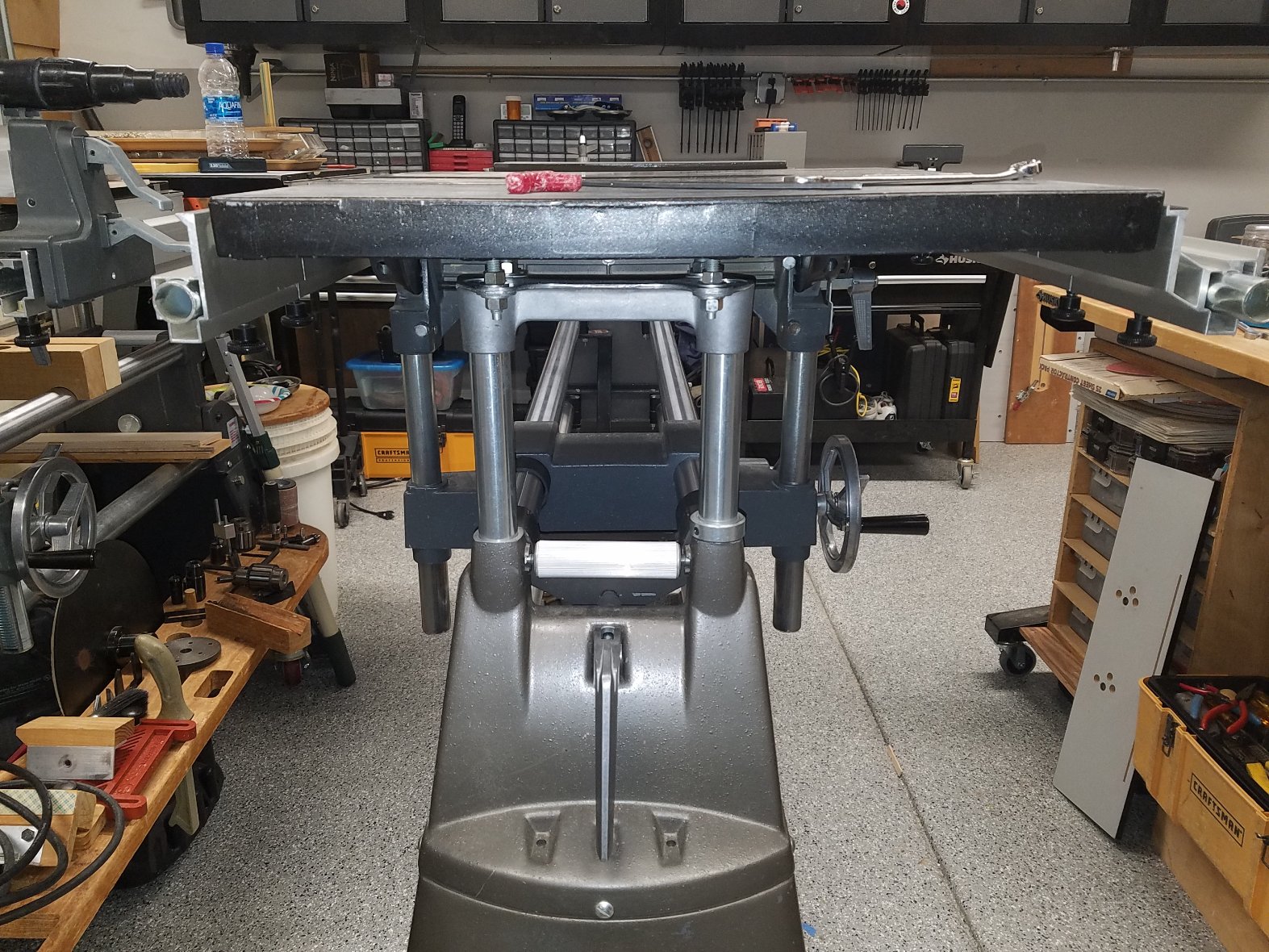

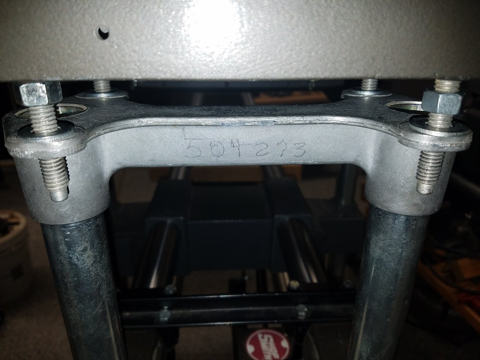

After posting this next set of pictures I must take a break from this effort. I have to get the shop back into a condition where it is safe to walk in.
After my efforts yesterday I was very disappointed on the swaps of my "Swap the Tables Test". I decided to go back to square one and do both tables over again. I am now ready to do the swap but I wanted to show a copy only vaquely related pictures.
I start by removing the Extension Table Legs from the table and put the table on table tubes mounted to the Main Table. The carriage is then slid toward the Table legs to achieve vertical alignment. Then I lay washers in place and raise the Table Legs to engage the studs on the table. Add the other washers and nuts and finger tighten starting with the upper four nuts. Then finger tighten the lower nuts then gingerly tighten the nuts with a wrench.
If the Extension Table was square with the Main Table to start with, I should now have a perfectly matched set of tables. Check the rails to see if they slide smoothly and move to the other end.

algale, No there is really no difference other than both Extension Tables are physically in contact with the Main Table. Diagonal Measurements of the two can be compared where as the other way that can not be done. At this point nothing new has been done toward achieving the objective of understanding.
I drug my feet today and have not yet done a swap of the tables.
I did use the AngleCube today to check all of the vertical involved and the Table tops and a number of different locations. All observations were as expected except the vertical measurements of the extension table legs. They were not quite the same as when the table tunes were not involved.
I need to record the various measurements with and without the tubes to see if this is meaningful.
