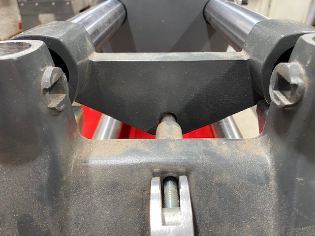

RFGuy wrote: Mon Feb 15, 2021 6:54 pm Thanks David. Manufactured on 3/23/1998
Does the Headrest have the asymmetry where the SPT lock goes as shown in this thread: viewtopic.php?p=264538#p264538 ?That was on '04 but I have since seen it in an earlier one, '01 I think. That would appear to confirm a different casting in comparison to ~ '91. I for sure have one of those I can look at, it is no longer mounted to anything.
- David

David,
Thanks. It looks like I do as well. Below is a picture. I tried to measure it with my calipers, but it is awkward since the calipers don't fit between the two. I get a depth of 0.1725" on one side and 0.1550" on the other.
📶RF Guy

dusty wrote: Tue Feb 16, 2021 7:49 am It seems to me as though two different locking methods are being discussed.
We weren't discussing SPT locking, just using this to identify the Headrest in question. RFGuy suggested the possibility that his Headrest tie bar lock might not perform as well as the older ones. My first thought that was that the Headrest hadn't changed in a long time, but I remembered this asymmetry which suggests to me that at a minimum a new casting was created, and that there is a visible way of identifying the newer ones. You are right, the asymmetry itself has nothing to do with locking the tie bar but can impact locking accessories. Users may need to change how they preset their SPT locks, creating a bias to offset for the asymmetry.
My thinking was (is) to see if RFGuy has this version of Headrest (now confirmed) and then see if there are any differences that might have something to do with tie bar locking.
