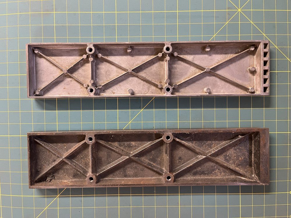

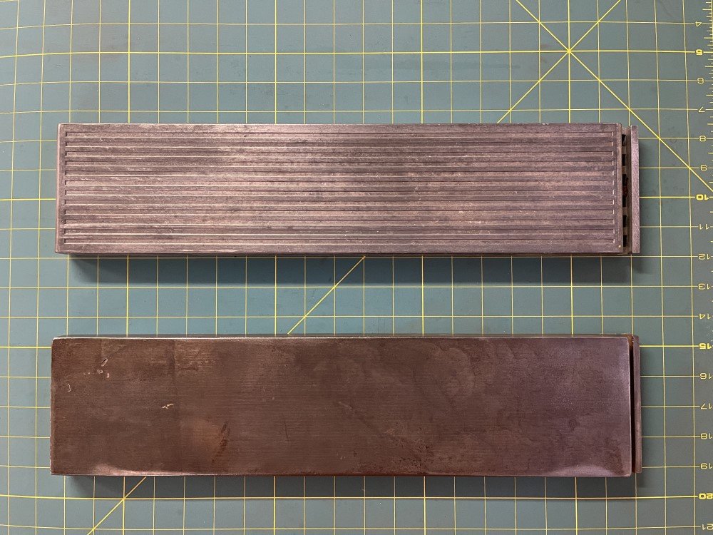

It is hard to believe but I have found more to talk about relating to the Mark 5. Very recently I found and purchased a Cast Iron Extension Table similar to ones that were made for the Model 10ER. This is the only Cast Iron Extension Table I have seen for a Mark 5 and even the ones for the Model 10ER are very rare with only about 4 that we know of. So why were these Cast Iron Extension Tables made and when? Today I added this to my Thread Shopsmith Model 10’s What When and Where since they seem to relate to each other.
The Mark 5 was in design, engineering and testing for some time while the Model 10ER was still being made and sold. Very recently I found and purchased a Mark 5 Cast Iron Extension Table. It is the only one I have seen although there are around 4 of the Model 10 Cast Iron Extension Tables we know of. I now believe that during the testing of the Mark 5 some Cast Iron Extension Tables were made and the ones for the Model 10ER were also made as a test in the table design around that time. Most of the Cast Iron Extension Tables for the Model 10ER came with the longer bracket which was a later change for the Model 10ER. The bracket and the existence of a rare Cast Iron Extension Table for the Mark 5 lead me to believe they were both made at that time. This is only speculation and I could be totally wrong but based on what I know it is my best explanation.
As to how these Cast Iron Extension Tables got out into circulation is anybody’s guess too but here are a couple possibilities, over the years the Shopsmith line has changed ownership and they may have come from clearing out extra stock. Another is they may have been on demo units that were later sold. Of course, these are only guesses and we may never know the real way they became available.
In the pictures below of the Extension Tables are the Aluminum on top and the Cast Iron on the bottom.
_
CI and AL Extension Tables top.jpg (161.92 KiB) Viewed 71250 times
CI and AL Extension Tables bottom.jpg (185.89 KiB) Viewed 71250 times

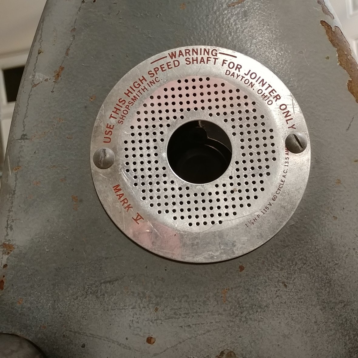

I recently aquired an older SSmk V in fairly rough condition that I intend to rebuild with a variable speed DC motor. It has a gilmer drive; nameplate says it has a 1 1/8HP motor (motor draws a hair over 7 amps so I guess it is a 1 1/8HP) and looks like original gray paint under the cover.
The nameplate has NO serial # (see pics). I didn't read anything in this thread reguarding no serial #'s. I'm guessing this is approx a 1962?
Any thoughts?

lahola1 wrote: Wed Feb 09, 2022 12:09 am I recently aquired an older SSmk V in fairly rough condition that I intend to rebuild with a variable speed DC motor. It has a gilmer drive; nameplate says it has a 1 1/8HP motor (motor draws a hair over 7 amps so I guess it is a 1 1/8HP) and looks like original gray paint under the cover.
Any thoughts?
Maybe some mix and match parts there? The Gilmer drive means 50's or very early 60's, but as far as I know also means originally 3/4 HP and originally Greenie or Goldie (much less likely) color scheme. The nameplate says Shopsmith Inc, which means 70's or later and means not Gilmer. The lack of a SN on the plate suggests even later to me, when they started using a separate sticker. Which would only mean the nameplate is newer.

David's comments about the Vent Plate are correct. It would be from a Mark V made after Date Coding replaced serial numbers in December 1987.
Since it has been 68 years now since the first Mark 5's were being made it is not surprising to find mixed and matched parts on these tools.
My now Mark 7 is on a November 2001 Model 520 frame with a headstock Date Coded 09-11-01 on the Belt Cover but the main headstock casting is from a different "C" Headstock along with the Motor Pan. I purchased used headstock parts to make a complete one when I did the DIY Power Pro upgrade and kept the complete original Headstock as a spare. The seller gave me the date of the Headstock casting and motor pan so I could use the correct paint formula. Since I added the Double Tilt Upgrade those parts are a year newer than the Power Pro Upgrade. Even the front Fence Rails are newer than 2001 since I purchased the Rip Scale upgrade kit.
When restoring older tools that need replacement parts because they were either missing or damaged can be a challenge to find close matches. For some just finding a part the fits and works is enough. Admittedly the Mark 5 "Greenie" I restored serial number 351689 was not that serial number originally. It was close to that serial number based on the changes made to the Mark 5 in those early years but when it was given to me it had no Vent/Serial Number Plate. The person who gave me the Mark 5 said it was left in a rental house of his, so any history is unknown. I bought a vent/serial number plate with a serial number in the proper range to give it an identity and complete the restoration. Waiting to get that vent/serial number plate was the final touch in that restoration.

The name plate is sold separately as a service part. See ref #101 so it might have been replaced at some point in the past, though it has been there a long time.
