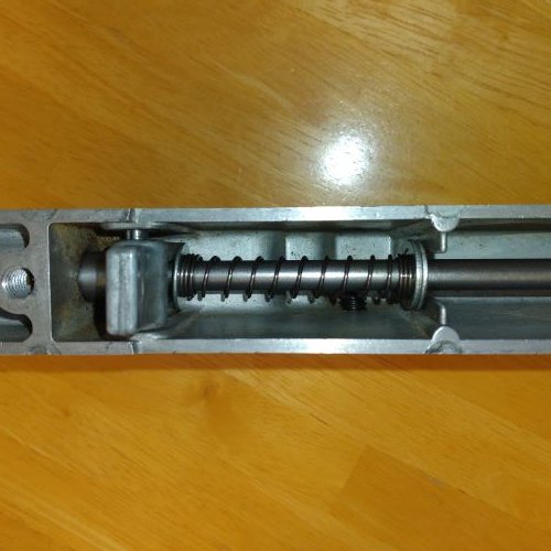

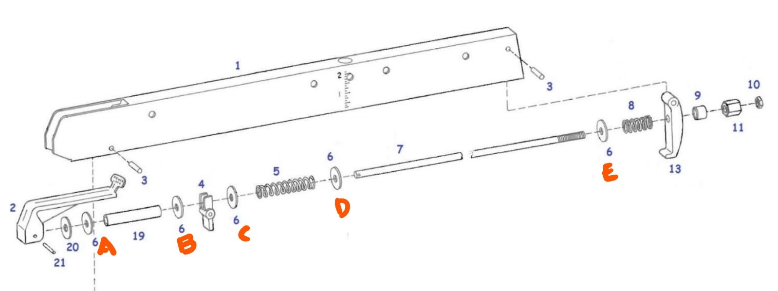

So, starting from the cam lever. I have washer 20, I appear to be missing washer 6A, I have item 19, but missing 6B, I have 6C, 5, and then I have two washers in the 6D location. I have 6E and the rest appear to be in their correct locations. I think missing the two washers prior to the first clamp is likely where the slack is. I will disassemble and get this correct and report back.

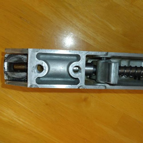

Back off the nut at the rear end of the operating rod. Causes the rear clamp to open further.
As another 'simple' test, with the fence off the table and upside down, close the lever and observe the front clamp moving(or not moving?)
Look into the bottom where the lever/cam is moving a washer that bears against the sleeve. That sleeve motion should cause the front clamp to close. Ignore the rear clamp fer now.
Posts: 35430
Re: MAG-DRO Alignment Tool Option
JPG wrote: Mon Apr 19, 2021 5:00 pm Fer sure missing 6B will make the front clamp inoperative. Move one of those 6D to 6B.
I do not think the missing 6A is causing an issue. 20 might be bottoming against the fence rib anyway.
The washer between 9 and 11 is not helping it work properly.
I like to have a washer between 8 and 13.
When removing the operating rod from the springs, a temporary rod to hold the spring and washers in line MAY help when reassembly takes place.
P.S. I prefer a jam nut in place of the wing nut. Once adjusted properly it should not need to be moved.

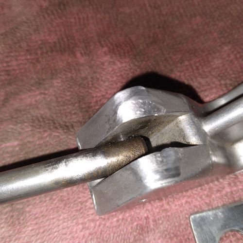

Ok, let me start by saying it is dramatically improved! It will now center-up prior to the outfeed clamp locking. The cam on the lever was worn to match the round washer at location 6 (hard to explain, see pic). I made a 15/16" square washer to fit in place of 20. This forces the cam to use the unworn parts to contact the washer. I moved the washer that was between 9 and 11, to be between 8 and 13. I moved one of the washers that was at 6D to the missing 6B location. I put it back together and could instantly see that it started gripping the infeed clamp and centering-up the fence as intended, but I noticed at the very end of the tightening the outfeed side of the fence would move to the left, toward the blade. I thought I needed more front clamping pressure, or sooner front clamping action, so I added a second washer at 6B. It now seems to lock the infeed, then the outfeed appears to clamp straight without noticeable sideways movement. I aligned the fence dead-nuts to the miter slot and tightened the bolts. I am not sure what to really expect for accuracy here but I am getting between 0.006 to 0.009 + or - at the outfeed end after moving the fence location and relocking. That is less than 1/64th inch. Should I expect any better?

Atlas 7B Metal Shaper
Posts: 35430
miken wrote: Mon Apr 19, 2021 9:17 pm Ok, let me start by saying it is dramatically improved! It will now center-up prior to the outfeed clamp locking. The cam on the lever was worn to match the round washer at location 6 (hard to explain, see pic). I made a 15/16" square washer to fit in place of 20. This forces the cam to use the unworn parts to contact the washer. I moved the washer that was between 9 and 11, to be between 8 and 13. I moved one of the washers that was at 6D to the missing 6B location. I put it back together and could instantly see that it started gripping the infeed clamp and centering-up the fence as intended, but I noticed at the very end of the tightening the outfeed side of the fence would move to the left, toward the blade. I thought I needed more front clamping pressure, or sooner front clamping action, so I added a second washer at 6B. It now seems to lock the infeed, then the outfeed appears to clamp straight without noticeable sideways movement. I aligned the fence dead-nuts to the miter slot and tightened the bolts. I am not sure what to really expect for accuracy here but I am getting between 0.006 to 0.009 + or - at the outfeed end after moving the fence location and relocking. That is less than 1/64th inch. Should I expect any better?
Correction, after more testing it seems to be pretty consistent in the -0.005 to -0.008 range. If I continue to adjust I should be able to move that to the + side eventually. :)
Thanks, Mike -
That last pix indicates a nylon washer may be desirable.
