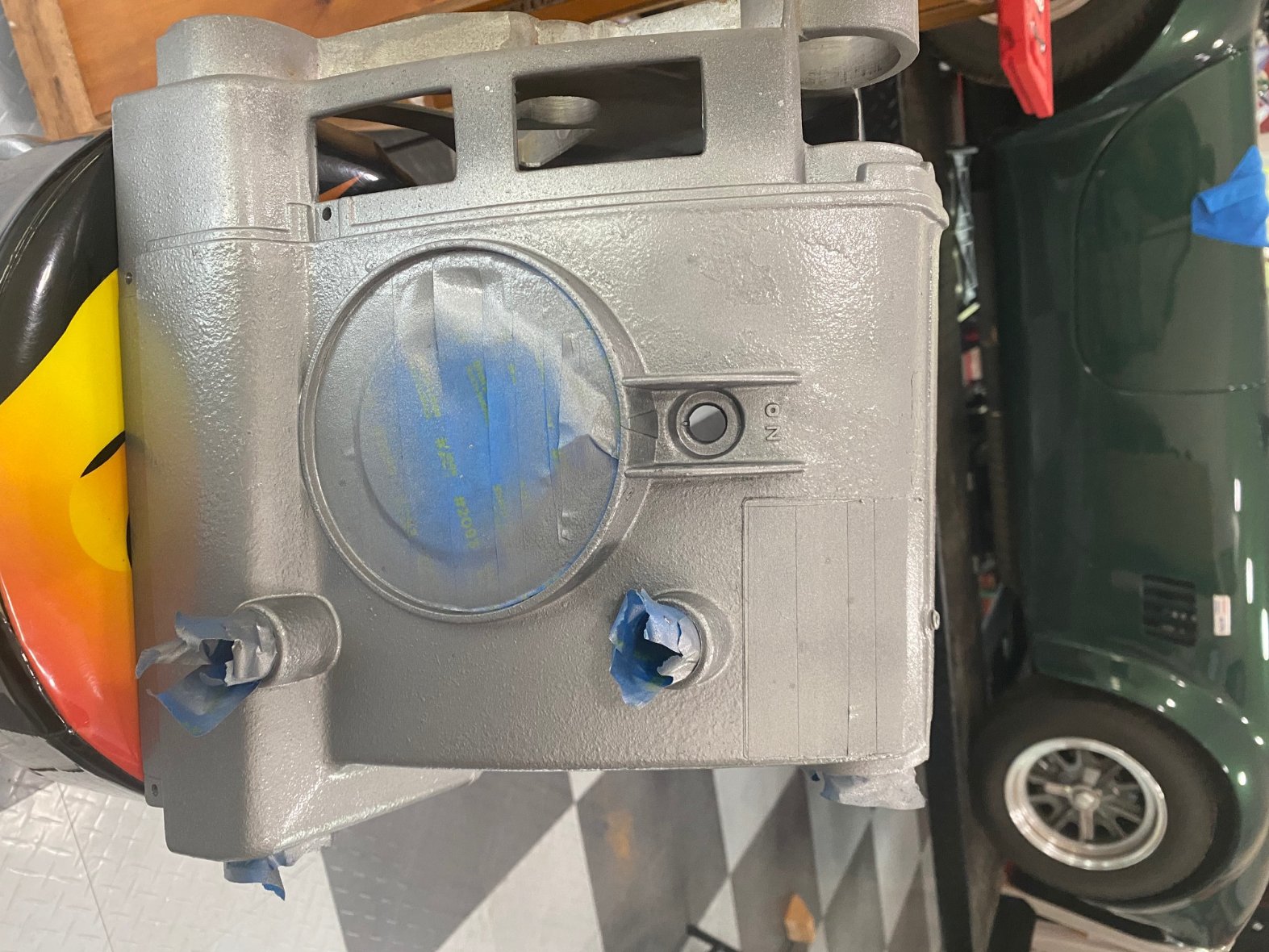

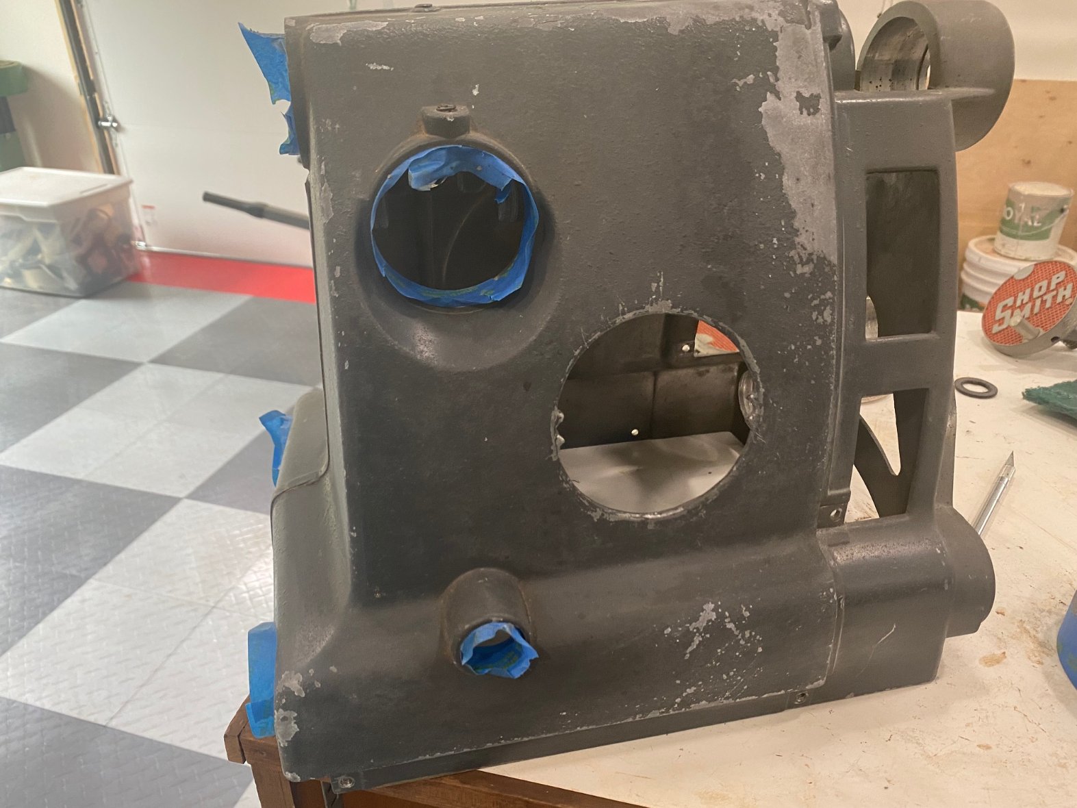

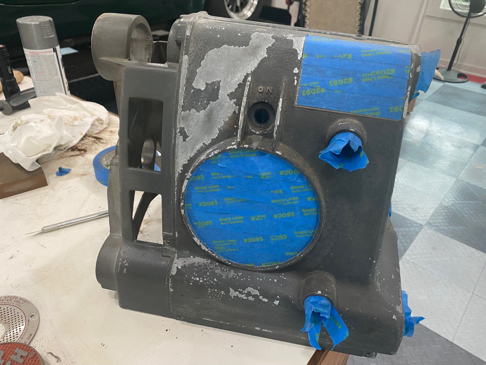

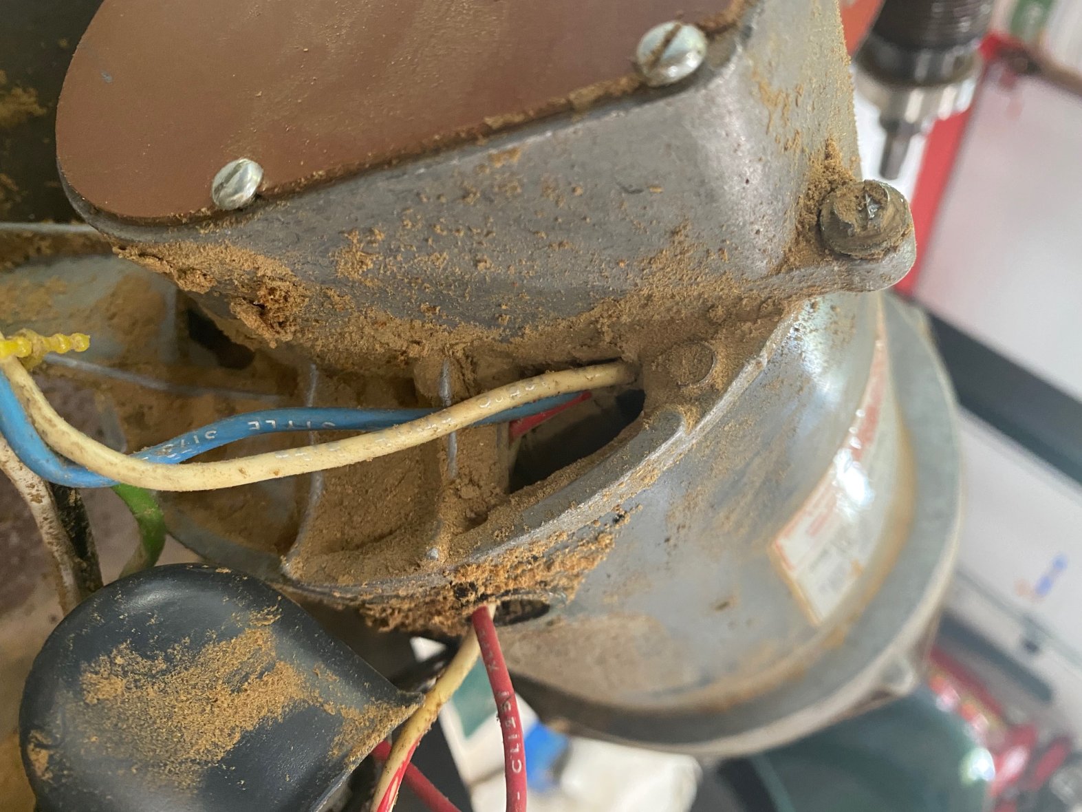

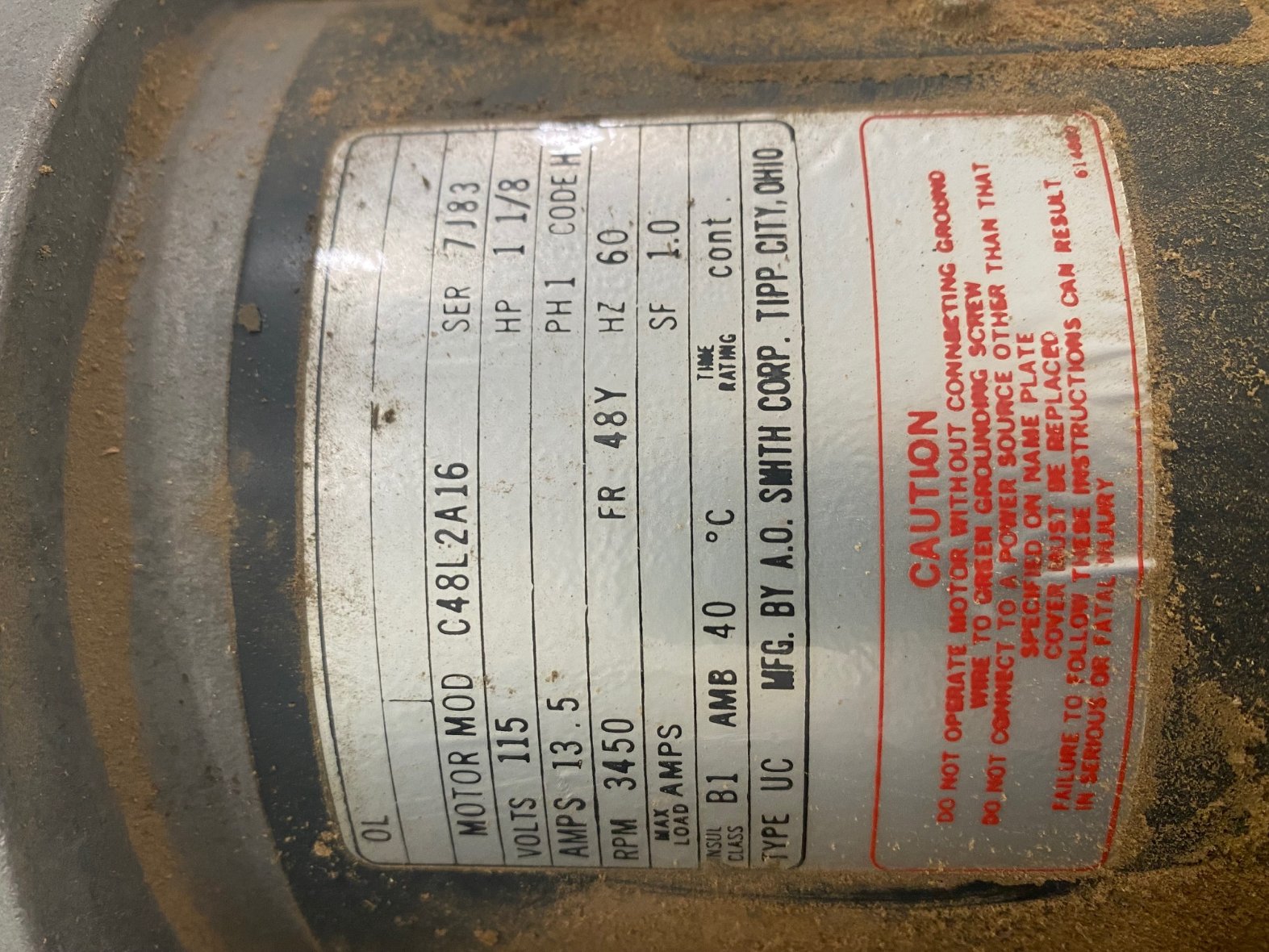

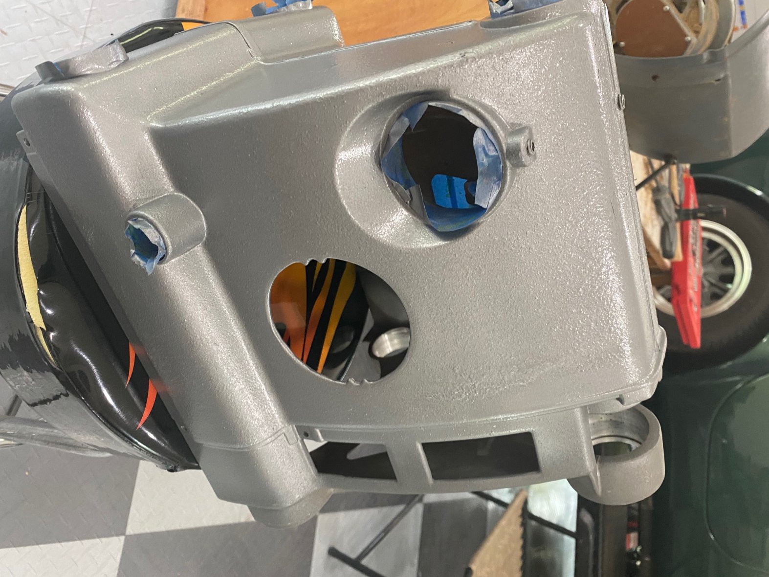

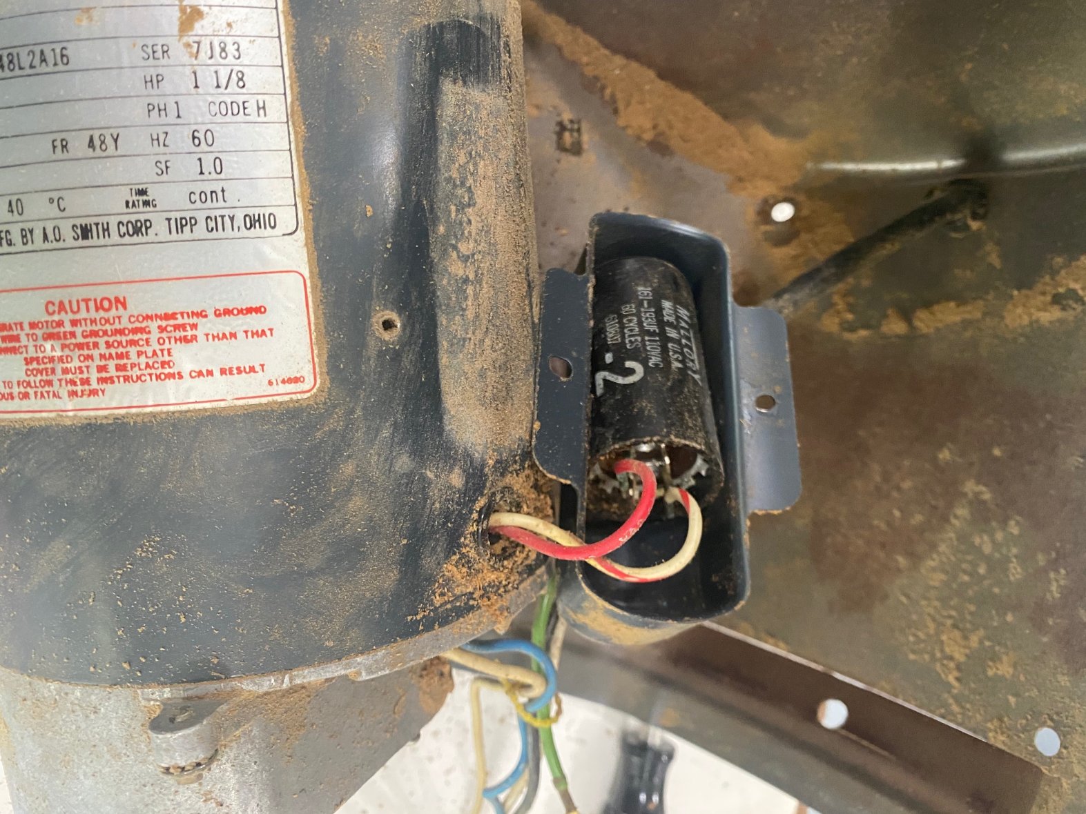

Well, the case has cleaned up nicely, working on pulling the motor now.
Headstock 9.jpg (243.81 KiB) Viewed 1122 times
Headstock 91.jpg (306.54 KiB) Viewed 1122 times
Headstock 92.jpg (302.37 KiB) Viewed 1122 times
Headstock 93.jpg (340.21 KiB) Viewed 1122 times
Motor 5.jpg (369.1 KiB) Viewed 1122 times
motor 6.jpg (345.57 KiB) Viewed 1122 times
motor 4.jpg (197.59 KiB) Viewed 1122 times
motor 7.jpg (308.19 KiB) Viewed 1122 times
Posts: 21481
Re: Refurbishing a MkV 510
What paint are you using. I like the color and the rough surface.
I have a pair of legs that need some TLC.
John4337
Posts: 96
Joined: Sun Jan 07, 2018 11:05 am
Location: Copperhill, TN
Post by John4337 »
dusty wrote: Sat Sep 18, 2021 12:28 pm What paint are you using. I like the color and the rough surface.
Its Rust-oleum Hammered in a silver/grey. Its concealing the roughness on the castings pretty well.
Posts: 21481
John4337 wrote: Sat Sep 18, 2021 12:32 pm
I have a pair of legs that are smooth and I want some texture. That looks like it.
Posts: 35453
I think the 'texture' is from the original paint(splattered). The areas where it was removed appear 'smooth'. I do not see the 'hammered' look?

Ok guys, goofy question, what's the secret method for releasing the strain relief on the power cord?

JPG wrote: Sat Sep 18, 2021 1:44 pm I think the 'texture' is from the original paint(splattered). The areas where it was removed appear 'smooth'. I do not see the 'hammered' look?
its hard to see in the photos and it is smoother in the areas where the corrosion was worse and more of what I assume was the factory finish came off, but it does have a texture. I suppose that I could have wire wheeled the entire thing to take it all off.
DLB
Posts: 2218
Location: Joshua Texas
Post by DLB »
John4337 wrote: Sat Sep 18, 2021 1:52 pm Ok guys, goofy question, what's the secret method for releasing the strain relief on the power cord?
They are not all the same. Looking at the clamp from the inside of the motor housing, you'll probably see it has two flat sides and two rounded ends. If yes, then squeeze the rounded ends together (hard) while pushing in and/or pulling out from the out side. At least that's how I do it.
- David
John4337
Posts: 96
Post by John4337 »
DLB wrote: Sat Sep 18, 2021 2:36 pm
- David
Thanks, that got it, just took alot more pressure that I thought it would take
