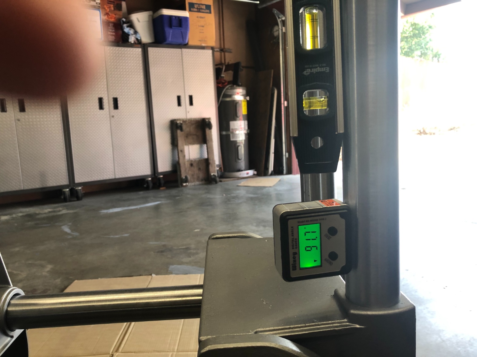

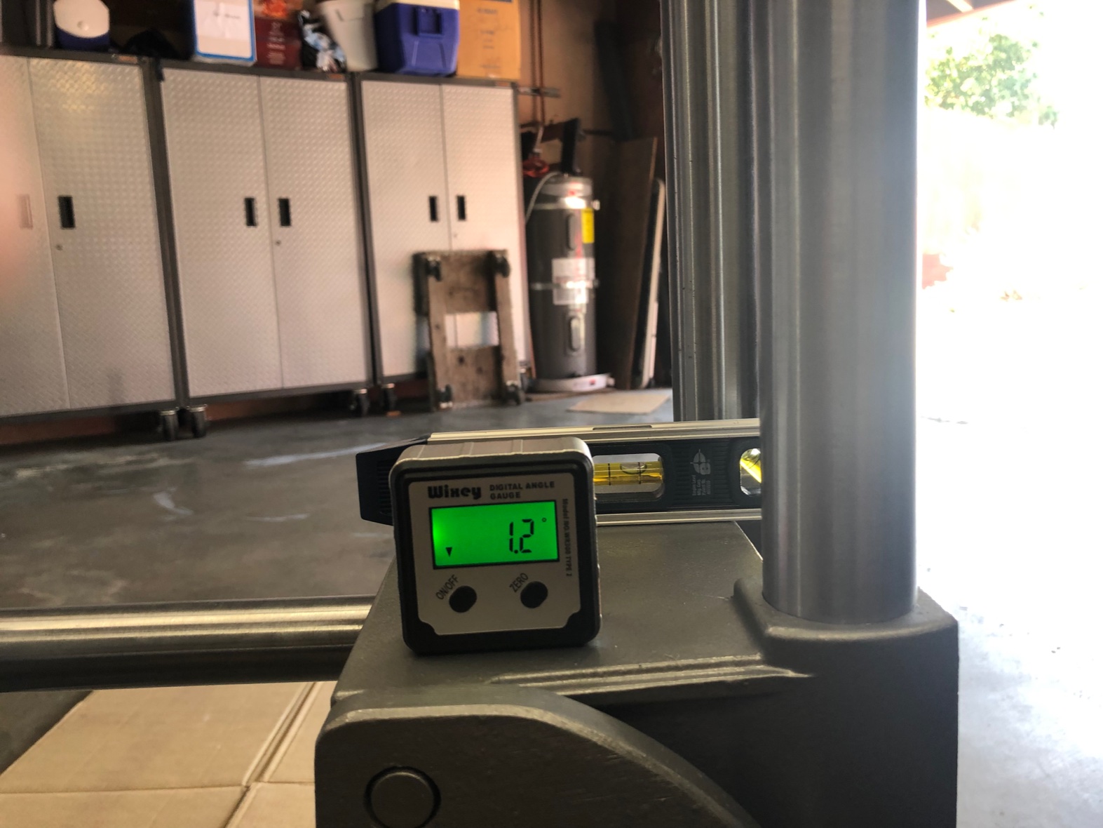

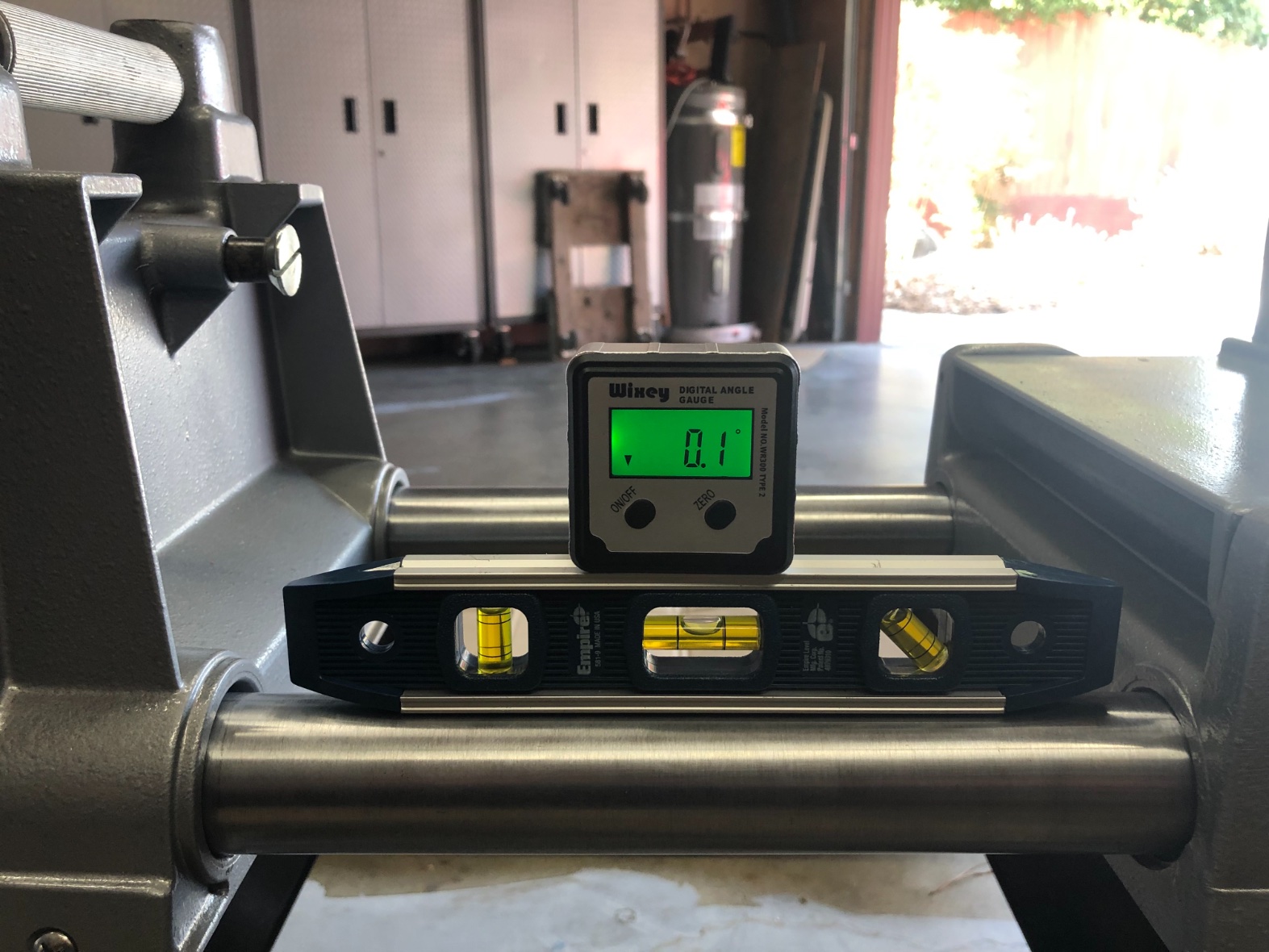

That is exactly what I did. Zeroed the Wixey on the bench tube and measured on the same side way tube.reible wrote: Wed Sep 08, 2021 2:23 pm As I recall there has been at least three threads on the subject here at this forum but if you want to do it again by all means go for it.
But, the only accurate way to do so is to have the shopsmith in horizontal position and zero the gauge then go to vertical. There is no way of knowing for sure the bench and way tubes are actually level with each other so you have to use the same set of tubes to measure from. Even this could have some errors if the tubes have even a slight bend in them.

Took everything apart and back together, very little change so will figure out how much to grind to get it closer to a permanent 90. This will allow lock to line up and sink in deeper for a more permanent lock. I know many will disagree and I very much respect your opinions.
