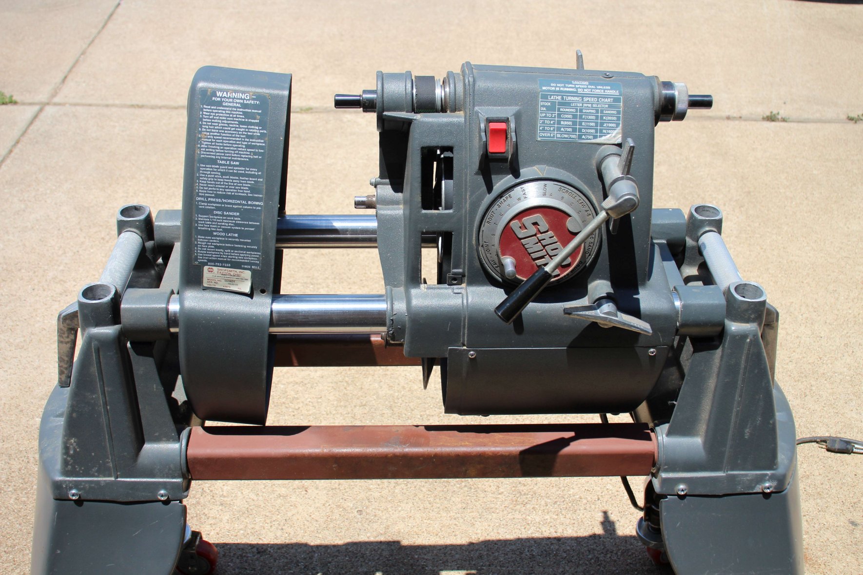

Here are some pictures of my Mini, taken with the speed set all the way to the slow stop:
Mini Mark.JPG (360.11 KiB) Viewed 3265 times

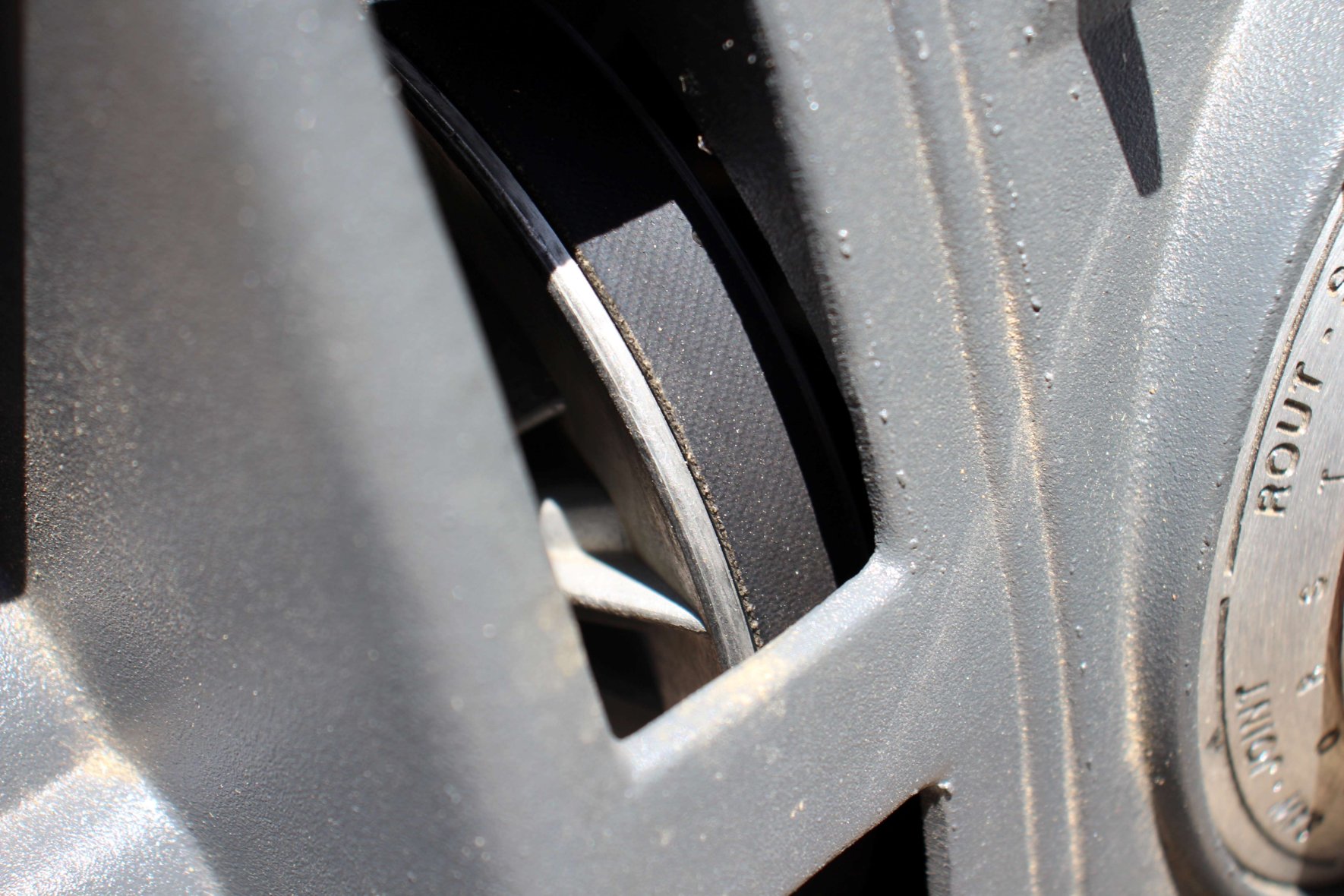

The belt, located at the maximum diameter of the Idler sheaves:
Mini Idler.JPG (308.21 KiB) Viewed 3265 times

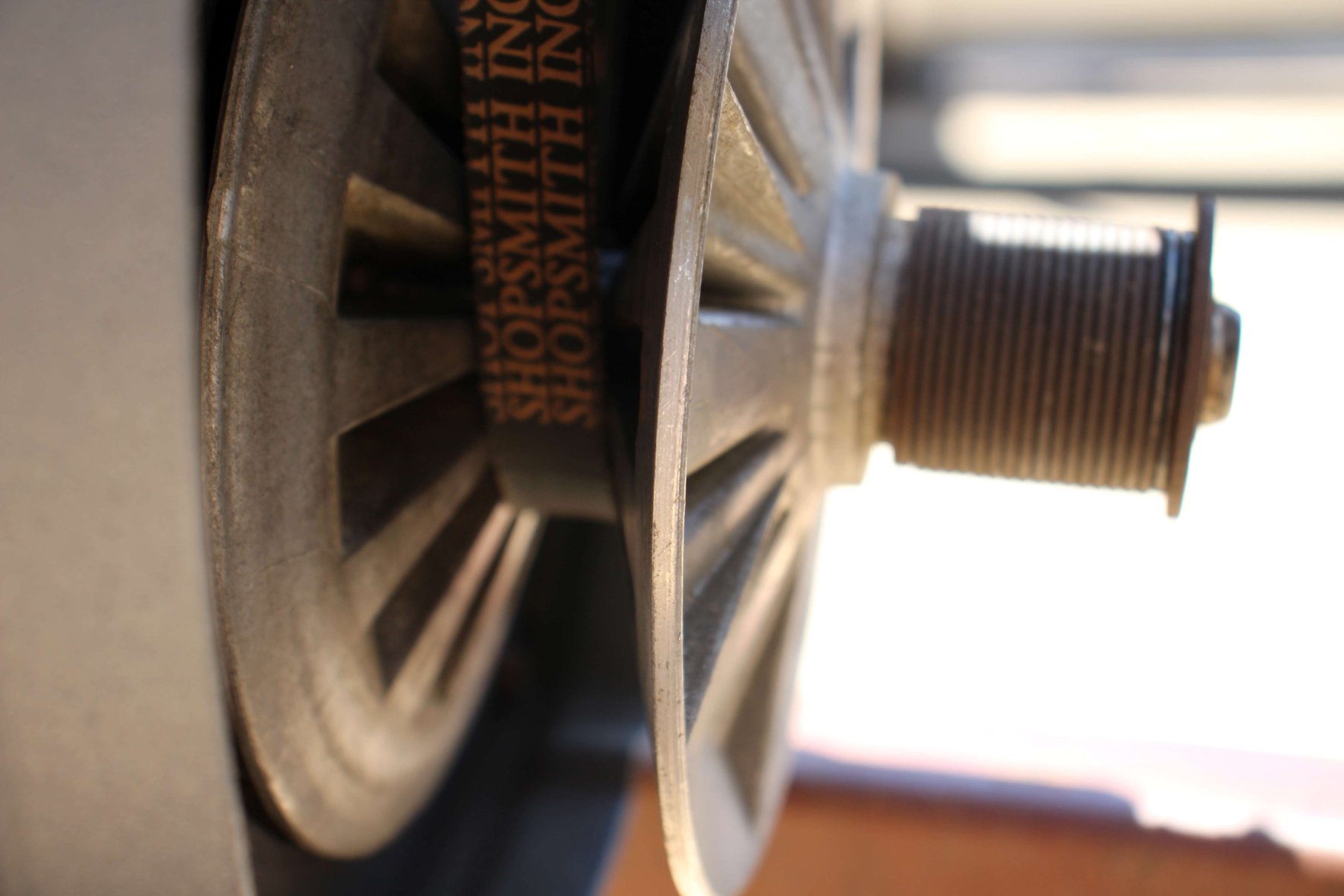

Belt location and spring compression showing it is at the minimum diameter for the motor sheaves:
Mini Motor.JPG (140.98 KiB) Viewed 3265 times
To me, this suggests that the factory belt is very close to the optimum length. From optimum length, I think slowest speed increases with either a longer or shorter belt. High speed operation is different, especially in that we adjust the stop for a specified belt position on the motor sheave. Which therefore is not going to close all the way to give max diameter.

I don't know that these neccessarily optimum but it certainly is consistent with what I consider normal.''It would be interesting to see the belt position at the opposite speed extreme.
Does the belt, when at high speed stop, ride the rib of the floating sheave the same?
At the high speed stop the positions are, of course, opposite but also a little over 1/8" less extreme on both sets of sheaves. Depends entirely on how you set the high speed stop.
Note - The comparable 1/8" less extreme for slow operation occurs, on my machine, at about "C." The slow stop is essentially coincident with "SLOW" on the dial.
