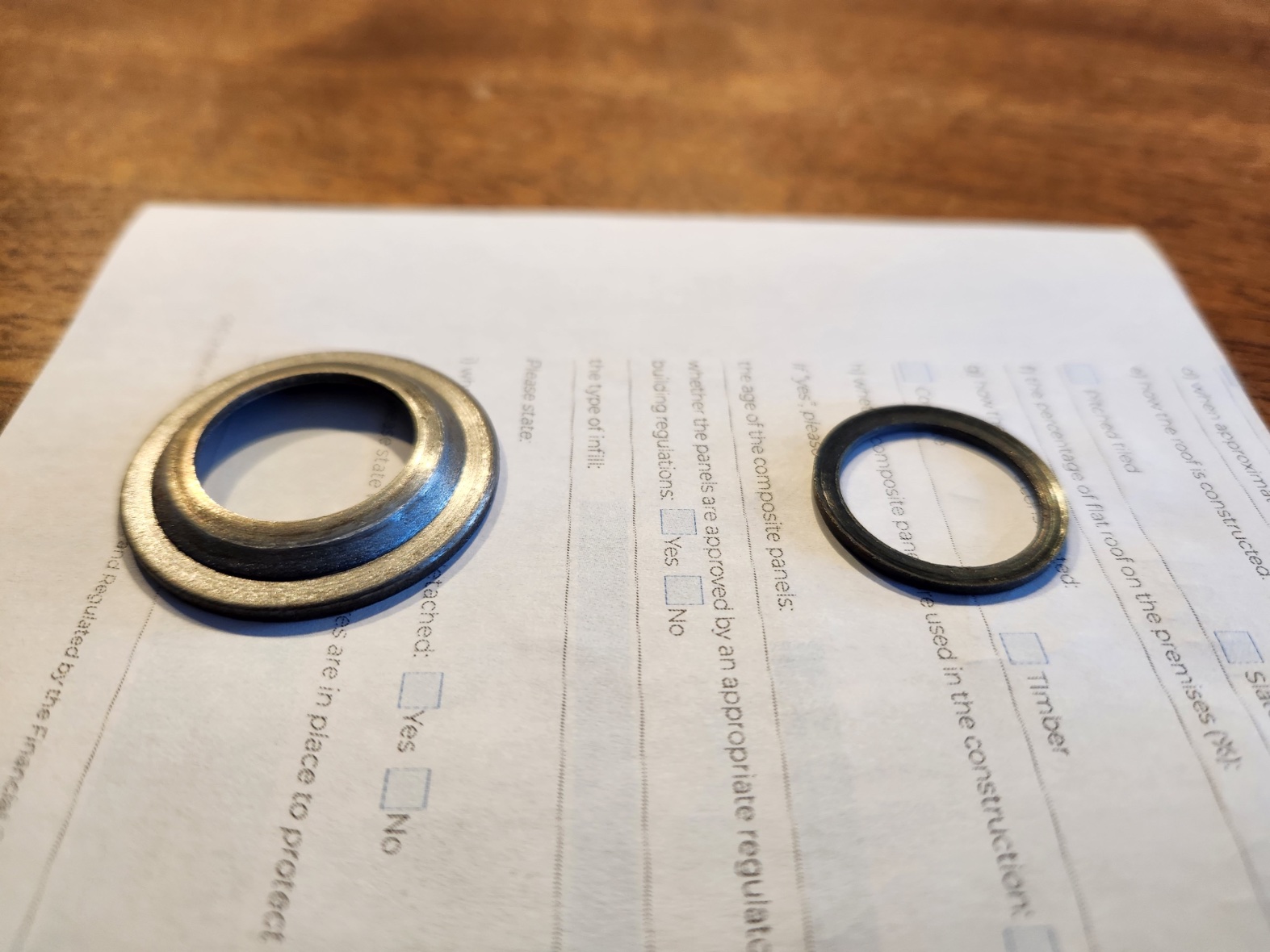

I stand corrected. It is in fact a wavy spring washer, albeit a pretty flat one. The greenie on the other hand has a very interesting one.
….on the left.
….on the left.
- 20231008_163354_Original.jpeg (341.1 KiB) Viewed 3605 times

Haven’t had that one apart yet but this looks like the cup washer we were talking about inside, right?
I wonder how many different people have had that headstock apart since 1957.

Maybe I’ll find the wave washer inside where the cup washer should be.
- Posts: 35598
Re: Mark VII “Project Machine”
Maybe in the bottom of the motor pan.

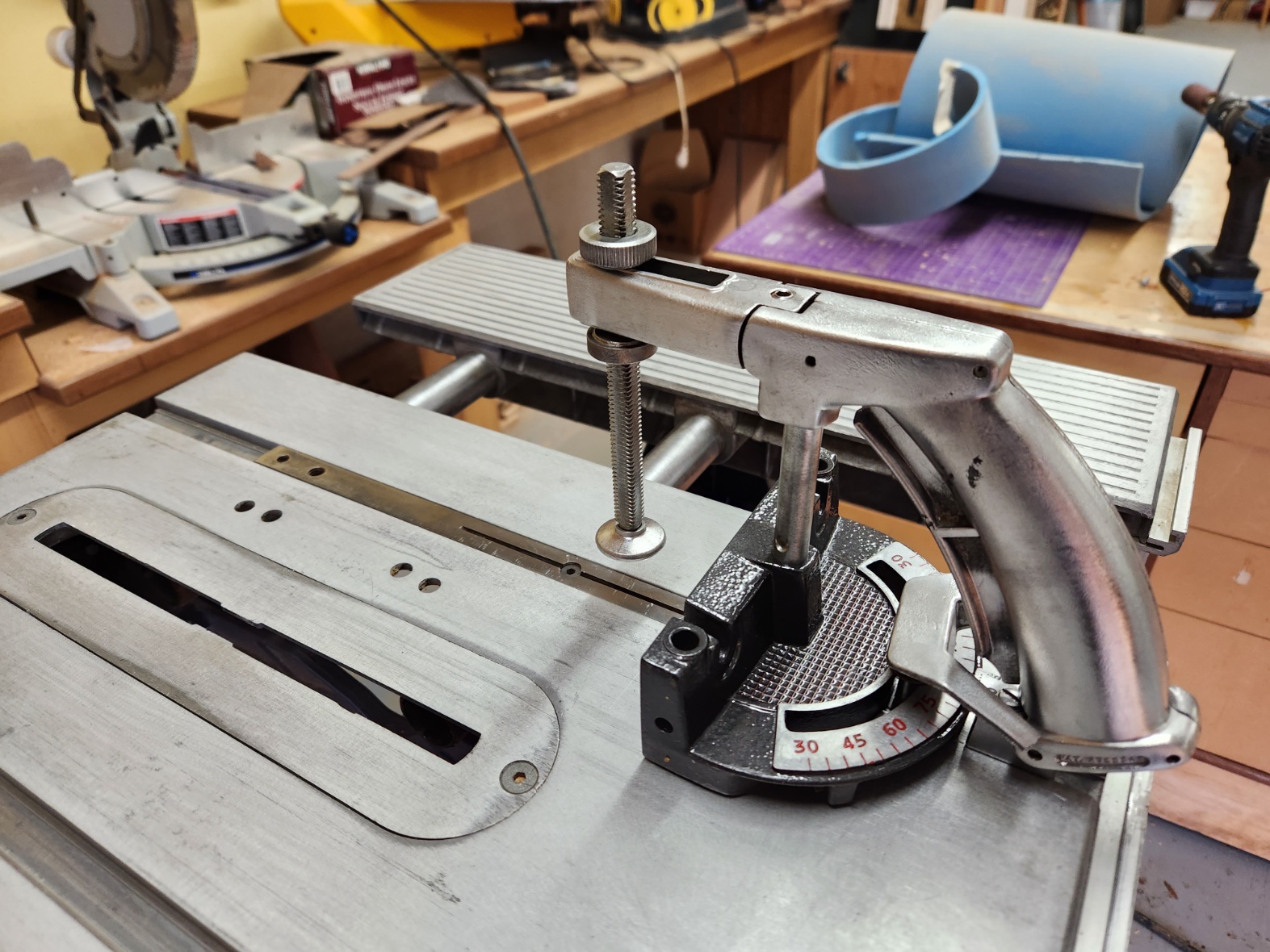

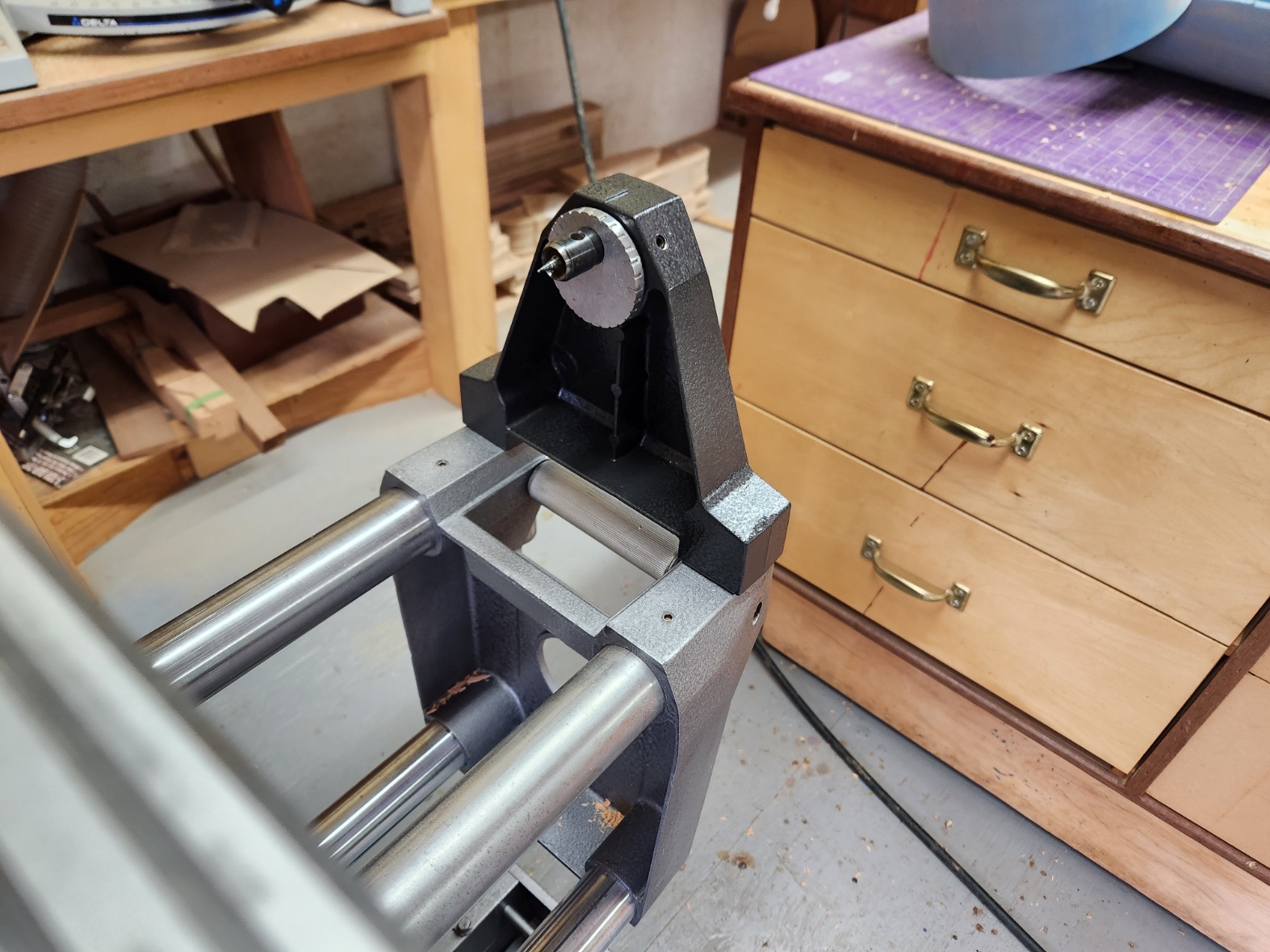

Today while waiting for the “new” sheaves to arrive I went back to the cosmetic refresh. This is not a show machine, just a user but it still deserves a cleanup. The bare aluminium parts are just cleaned up with a wire wheel and the rest painted. I’m using black Rustoleum hammered finish as an accent colour to break up all that grey.
I added one pic to show the before condition of basically everything.
- Posts: 35598
Adjusting the rip fence clamp can be a bit tricky. It needs to be just tight enough. Too tight and it is hard to clamp and put on/off the table as well as increase wear on the handle cam.
All looking good by the way!
P.S. DO back out those off set set screws.
