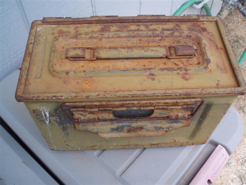

Given these road blocks - the next test will be to determine if the current changes (and how much) if the size of the rusty item changes. I have a couple ammunition boxes that I want to clean up.

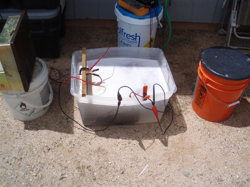

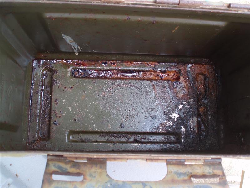

The electrolysis process is underway once again. This time on an old ammunition box that got left in the same leaky shed.
Once cleaned up I'm going to use it for my "Woodshop Piggy Bank". I'll deposit ALL of my pocket change each time I come home from any sort of shopping trip. This will result in a "slow draw" that will likely go completely unnoticed.
OBSERVATIONS:
1. The tub is bigger; holds twice as much water.
2. The rusty item is BIGGER.
3. The same power supply is outputting a lower voltage level (10.556 volts).
4. More current is being drawn (3.95 amps).
5. WRONG SODA [ACE is supposed to have the right stuff tomorrow]

What appears to be 'suds' is a surprise! Is this because of the 'wrong' product, or are you getting that much bubbling?
You will need to move/rotate the box to get it working on both inside and outside and all sides. It does work around corners somewhat, but the further from straight line, the slower it works.
Nice meters! Really like the simpson! Do not drop it!!!!
JPG40504 wrote:What appears to be 'suds' is a surprise! Is this because of the 'wrong' product, or are you getting that much bubbling?

What are you using for your anode(s)?
What's the ratio of laundry detergent to H20?
You'll notice that the amperage will drop after several hours to somewhere around 1-2 amps (at least that's what happens with my battery charger).
Sunny San Diego
mickyd wrote:What are you using for your anode(s)?
Anodes? I have only one unless to which you refer is the rusty item. Right now the positive lead is connected to a piece of flat iron that is about 5"x7".
The other lead is connected via the ammeter to the item being treated (the rusted ammunition box lid).
I mixed the WRONG SODA on a ratio of 1 tablespoon per gallon of water. The container would hold 58 quarts (14.5 gal) of water. I used 1 cup of WRONG SODA . A bit strong since the container is not full to the brim but close.
The amperage does tend to go down with time but I am not certain why. I have concluded that it is not a direct indicator of progress.
CAUTION: Don't stick your finger in the bubbles. They have something to do with the current. Really dumb, especially for someone who has worked on hot circuits for most of his life.
