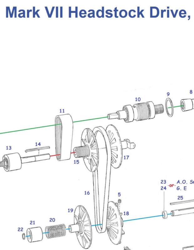

That is a good point. I haven’t “finished” cleaning it yet so I’m not ready to start lubricating. The quill is a bit stiff and doesn’t return on its own so I still have that to figure out.

There should not be a 'pork chop' inside a Mark VII.
The speed control knob rotates a cam which moves the control sheave.
Perhaps a pix is in order.

I might be able to get a picture later tonight. It may not be a “pork chop” but more like a snail shell.

Re: Which ShopSmith model do you use in your shop
From the google drive documents in the repairs section:
#17 is the piece that fell off and #16 (second image) that I called a pork chop or snail shell.
- A5E9F19B-0CDA-46E2-8426-1EBB433B2B77.jpeg (166.62 KiB) Viewed 16330 times
- 6605D695-417E-472C-A8D7-D308F0A5020B.jpeg (207.99 KiB) Viewed 16330 times
IIUC the #17 that 'fell off' is the cam follower that resides in the 'snout' of the control sheave. Check the 'snout' for cracks. It should not be loose enough to 'fall off'.
It may have done so while loose if the speed was increased too quickly. The cam would have pulled it out.
The control sheave and follower are unique to the MVII, so take good care of it! The cam(snail shell) is also both unique and rare.
