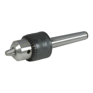

terrydowning wrote:But Art does bring up a good point to be cautious of. Not everyone has a nice 4 jaw chuck not to mention the morse taper to mount the drill chuck into the tail stock. Perhaps if a had a couple hundred bucks laying around with nothing better to do (At least in the financial manger's eyes).
So in the mean time I use some 1/4 inch rod mounted perpendicular to my disc sander that I can hold the blanks onto to ensure the blank is squared to the tube. I have a separate bench mounted disc sander I use for this.
One method I have seen is to use the cut off rod from the miter gauge and the disc sander. Now if I could only find my miter gauge and cut off rod which I lost during my recent move. I've been searching for months. I'm sure it is "somewhere safe where I won't lose it!"
I did pickup a MT #2 with drill chuck at Harbor Freight for $9.99 a few months ago. So that cost is not too prohibitive. (http://www.harborfreight.com/1-2-half-i ... 42340.html) I also agree that even if you use a 4-jaw chuck, you might have sides of the blank that are not running parallel to the bore. I frequently use scraps of hardwood cutoffs from guitar necks, and use them as they fall off (just cut to length). The sides may be curved or angle any which way - who cares!! The chips come off just the same on the lathe. So perhaps using a drill rod as a center pin guide for end sanding is the better way to go. I use the Woodcraft bore reamer & facing die, but the darned thing will heat up the tubes and cause the glue to slip; then I spend a few aggravating minutes removing the tube from the reamer. But I also use CA Medium Viscosity Glue.
