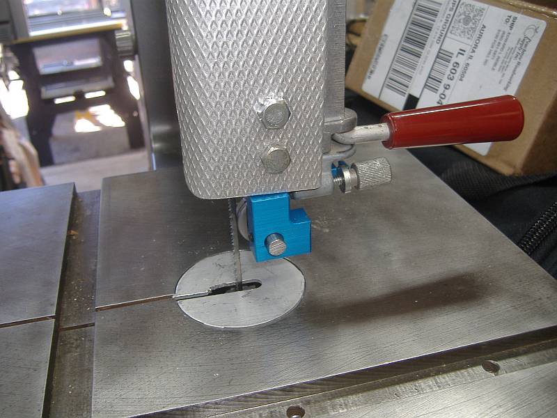

This what it looks like when you have it installed and ready to go.

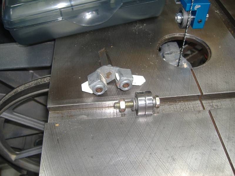

Keep in mind I have done an upgrade to the bearings and have ceramic blade guides installed so your shopsmith may not look like what is pictured but you should be able to follow along anyway.
To add this system you start by removing the blade. You will then remove the bearings and the guide block holder. The (blue) Carter guide then is mounted.

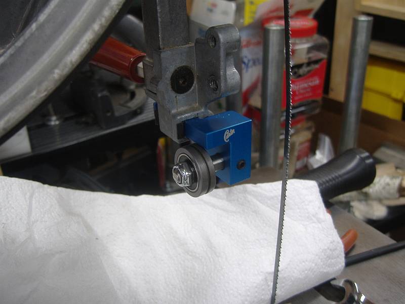

This guide system is designed to be used with thin blades, here you see a timberwolf 1/8" blade getting ready to be installed. The guide/bearing needs to be back near the post to start with.
[ATTACH]18246[/ATTACH]

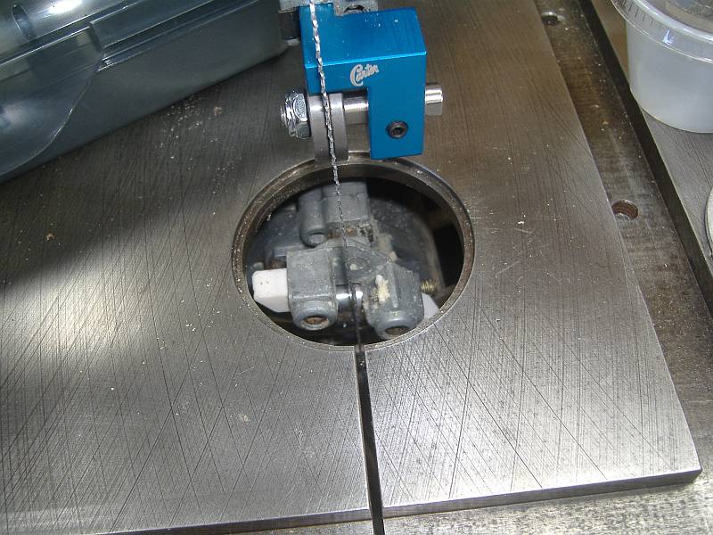

The below the table adjustment is backing the blade guides out of the way as seen here.
[ATTACH]18247[/ATTACH]
After the blade is tensioned you then need to align the bearing with the blade. A set screw allows the shaft to be moved for this alignment. Next the bearing is brought up to the blade and adjusted to force the blade slightly forward. I just do this by eye and feel.
[ATTACH]18248[/ATTACH]

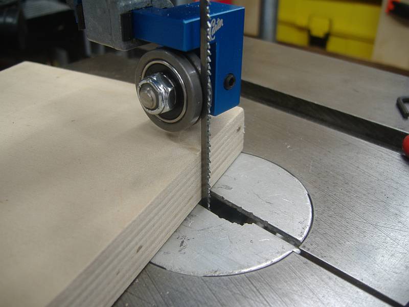

This next picture shows how close the bearing is to the work piece when adjusted correctly. This is also one of the reasons it works so well.
[ATTACH]18249[/ATTACH]
