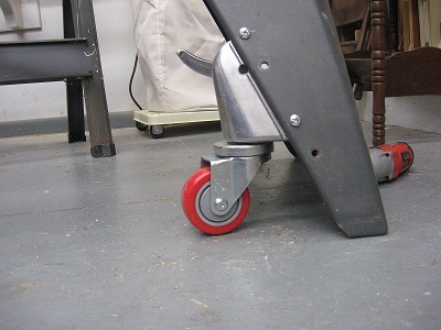

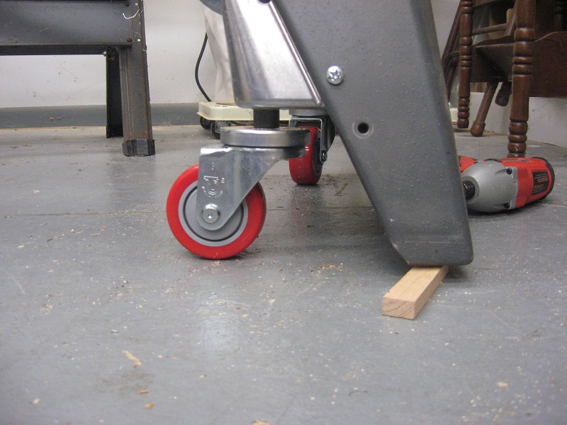

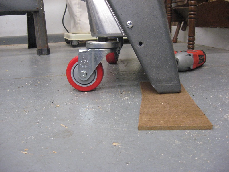

[ATTACH]14420[/ATTACH]
[ATTACH]14421[/ATTACH]
[ATTACH]14422[/ATTACH]received shopsmith ones this week. finally around to put them on today.
I installed new casters (shopsmith) into the lifting mechanisim then slid into leg with machine in normal position. gave it that 1/8 inch clearance from floor so caster floats from floor..... measurement that i have to raise the holes 1 5/8 inch which i did and drilled holes and installed bolts.... I have a wooden floor that is quite level and in down position casters just barely float.
So, if you are on any kind of uneven floor that 1 3/4 inch measurement that the shopsmith templates are , is probably the measurement to use. otherwise the wheels may not float in the down mode.
will try to attach pictures.... one is down, one is one click up 1/4 inch mdf is just a little loose. one is second click up 1/2 inch piece of oak is just a little loose........
that is all the height you can get with the cam setup and still have wheels float in the down position[ATTACH]14420[/ATTACH]

After rereading all the posts on this subject i think some are thinking that bigger wheels will lift the machine higher off floor. If you have eight inch wheels the cams will still only lift the macine 1/2 inch off floor.... But, be careful it rolls sooooo much easier. no more tugging to get it rolling...
