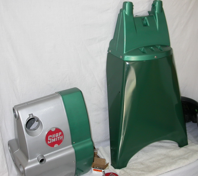

The executive decision was green case and side cover, silver pan.
I also feel the color patterm of MickyD's is the most appealing.

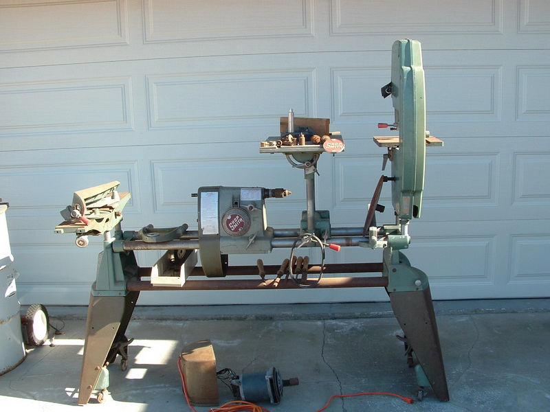

my version of the Greenie as it comes together. Going to make a tube polisher today out of some 10ER parts and two 10 foot 1 3/4" conduits.
I've got piles of tubes to sand and polish. I'll take a pic or two when I get it assembled.
The assembled complete pic is what it looked like when it I got it.

wiredone wrote:my version of the Greenie as it comes together. Going to make a tube polisher today out of some 10ER parts and two 10 foot 1 3/4" conduits.
I like your "Bam" green! It makes a statement.
Very nice work sir.

Upon reassembley, and specifically preparing surfaces ect. I'm guessing to wax the holes in the headstock for the tubes. What is best on all the other "hole" surfaces? I have a spray lithium Mr. Wrench greese?

The green, like any other color, is a matter of choice. What is really outstanding, by my way of thinking, is the paint job. It looks like it was done by a paint professional. Exceptional.
