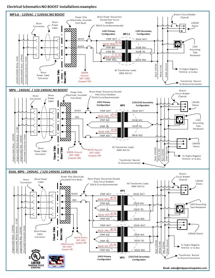

The Bridgeport Magnetics isolation transformers arrived, and they're WONDERFUL (mostly).
I now have a functioning alternating current electrical system. I've got 240VAC to the distribution panels, and there was zero smoke or drama when I powered the system up. This is almost, like, a disturbance in The Force. I thought I was destined to experience tragedy when I delved into powerful things I know not enough about, even when I follow the schematics...
Anyway, my boat doesn't hum anymore when shore power is plugged in, and the output is perfectly balanced 250/125VAC. It's astonishing!
1969 Chris Craft Roamer 46 Refit: Installing 12kva Bridgeport Magnetics Marine Pucks!

Re: Using a Shop Smith Mark V on a Chris Craft Roamer refit
Posted: Mon Dec 05, 2022 11:32 pm
by JPG
I be guessing the 'unused' orange wire is a 208v tap. It may be advisable to make it accessible/swappable with the striped red wire.
I do not know IF 208v/115v is a common thing at boat docks. It is a 3 phase source thingie. 240/120v is a single phase source thingie.
Posted: Tue Dec 06, 2022 8:06 am
by roamer46
I've never heard of a marina with 3 phase on the docks. The Pucks are UL registered in the US and Canada, but the sticker also indicates they work with 50 or 60hz. Add that to the sticker schematic showing a neutral and 240v single line, and I wonder if that's not a European spec. But then, the EU uses 220v.
Either way, the places my boat will go will almost certainly not have only 3 phase on the docks.
Posted: Tue Dec 06, 2022 9:33 am
by RFGuy
roamer46 wrote: Tue Dec 06, 2022 8:06 am I've never heard of a marina with 3 phase on the docks. The Pucks are UL registered in the US and Canada, but the sticker also indicates they work with 50 or 60hz. Add that to the sticker schematic showing a neutral and 240v single line, and I wonder if that's not a European spec. But then, the EU uses 220v.
I couldn't say how common it is, but 208V power is possible at some marinas, particularly if they employ a "split phase" source according to the article linked below:
https://gilwellbear.wordpress.com/2014/ ... e-marinas/
Also, the solid orange wire looks like the CT of the isolation transformer and should be unused in this configuration, I believe.
