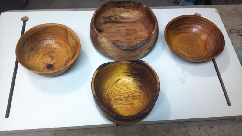

Tonight I finished turning the last 4 bowls that have been in bags for several months.
[ATTACH]21355[/ATTACH]
Three of these bowls are from the Bodark (from Bois d'arc (AKA Osage Orange) wood that I received from a friend several months ago. The top center bowl is the last pin oak bowl which came from the same log as all my previous bowls displayed. These didn't have any cracks but they were out of round which shook all my fillings loose when I was sanding them
My next experiment will be to turn green wood down to the final size before bagging them so I won't have to deal with out of round issues.

You know those bowls are GOING TO WARP and be OUT OF ROUND. You WON'T have a chance to return them back to round.fredsheldon wrote:My next experiment will be to turn green wood down to the final size before bagging them so I won't have to deal with out of round issues.

Bob, I guess what I meant to say was that I don't need to remount the dried bowls for the purpose of additional turnings. I will just sand and apply finish and let it go at that. I know the final product won't always end up round, but I guess that will give them character.beeg wrote:You know those bowls are GOING TO WARP and be OUT OF ROUND. You WON'T have a chance to return them back to round.![]()

This is when turning bowls starts to become art.beeg wrote:You know those bowls are GOING TO WARP and be OUT OF ROUND. You WON'T have a chance to return them back to round.![]()
It is only our modern paradigms that dictate a bowl must be round and symmetrical. The best part about turning green wood is that every piece is different, not two are ever the same so each blank is a new challenge.
Turning to finish size and letting them "do their thing" is just allowing the wood and mother nature to play their part in our craft.

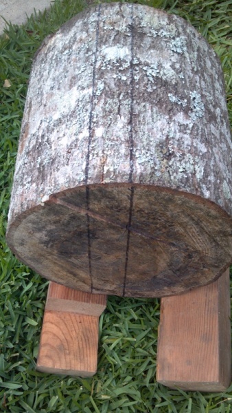

First I cut out the heartwood and create two blanks.

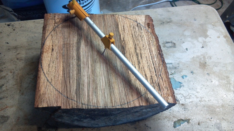

Next I draw circle.

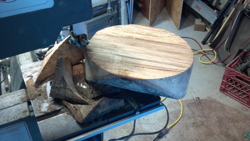

Then I trim it close to round on the band saw.

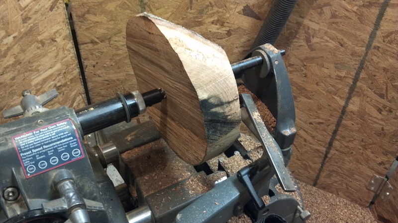

Then I mount it on the lathe and turn it round.

Here is the finished product turned to it's final size. This will be my first attempt to turn a green bowl to it's final size before beginning the drying process. The total time from start to finish was 4 hours. This included rolling out all my tools after moving my wife's car out of the garage, hauling a log from my backyard, adding oil to the electric chain saw, taking a couple of breaks, sharping my turning tools seveal times and then cleaning up all the shaving and sawdust before storing all the equipment and moving the car back into the garage.
So, if you were thinking about trying your hand at bowl turning, I say go for it. Just keep your tools sharp and use green wood if possible if you don't mind waiting several months to enjoy the fruits of your labor.

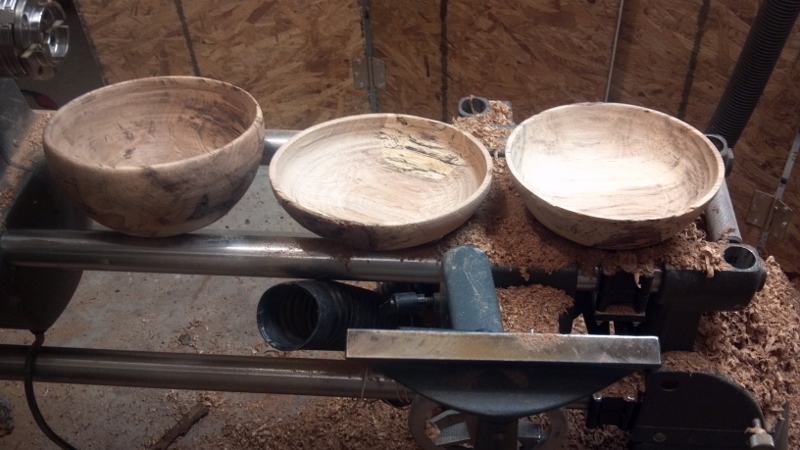

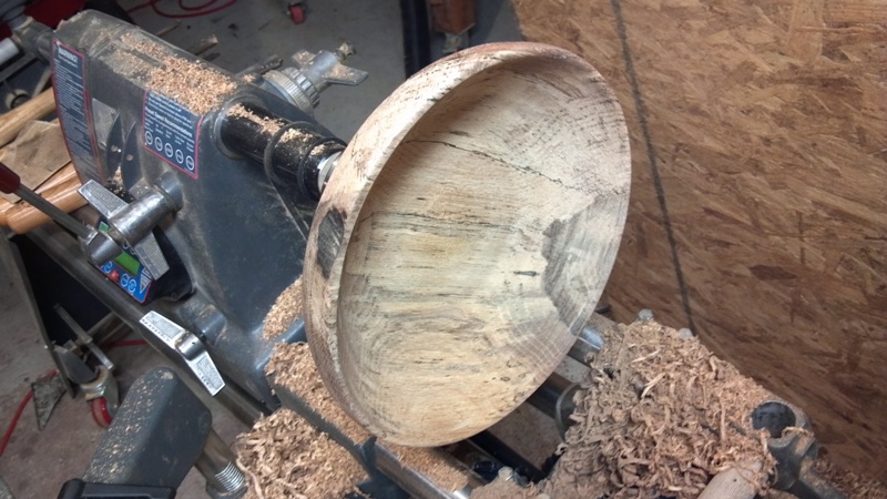

Three bowls turned in 4 hours.
Once you get the hang of this you can pop 1 of these bowls out every hour or so once you are all set up. These are from green wood and turned down to their final size before going into the bags for a few months. I'm hoping the 8 that I now have drying don't crack or warp too bad. I'm well on my way with my plan to make bowls for Christmas presents this year. I will need at least 12 bowls if I only give one present to each family rather then each member of the clan over the age of 18. That would require over 30 bowls like I did with the pen and letter opener sets last Christmas
[ATTACH]21610[/ATTACH]
I set up at noon today and just finished with the 3rd bowl at 4:30. If I wanted I could probably turn 6 of these out a day. That includes hauling a log from the backyard, cutting it in half and again in half lengthwise to create 4 blanks. I trimed all four blanks close to round on the bandsaw first. I attached a 3 inch faceplate and turned a tenon, then mounted in my chuck to finish the turnings.

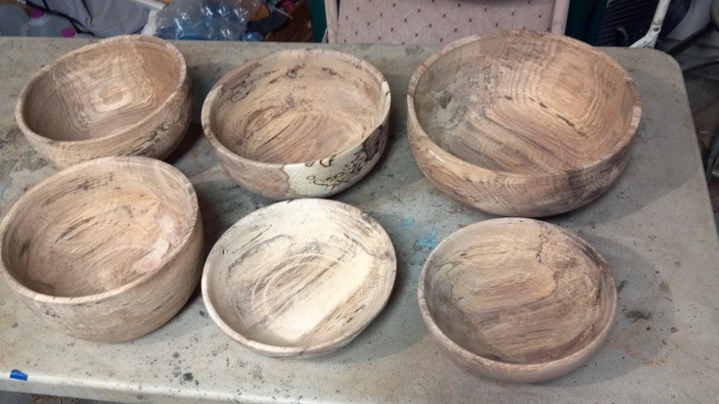

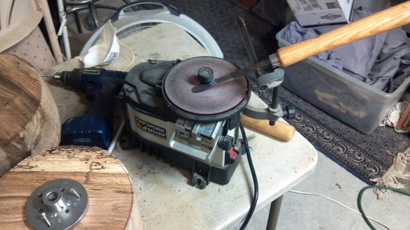

So far so good, the first 7 bowls that I turned from green wood all the way down to their final size before bagging haven't cracked or warped yet. I was encouraged by that so I turned and bagged 6 more today. I started at noon and finished the last bowl at 8:30 this evening.
[ATTACH]21786[/ATTACH]
[ATTACH]21787[/ATTACH]
The only tool I used to turn all 6 bowls was the 1/2 " Roundnose chisel. I found it does a great job as long as I keep it sharp. I usually have to sharpen it about every 15 minutes.

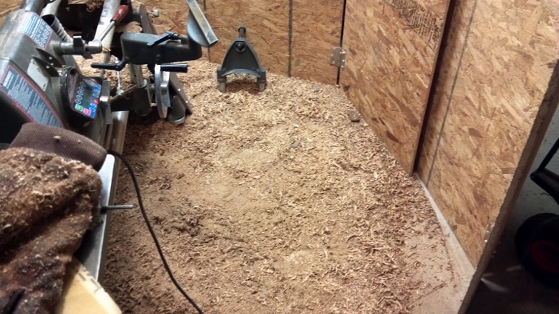

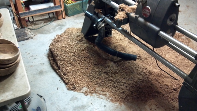

Generated two full 30 gallon bags of chips/shavings.
