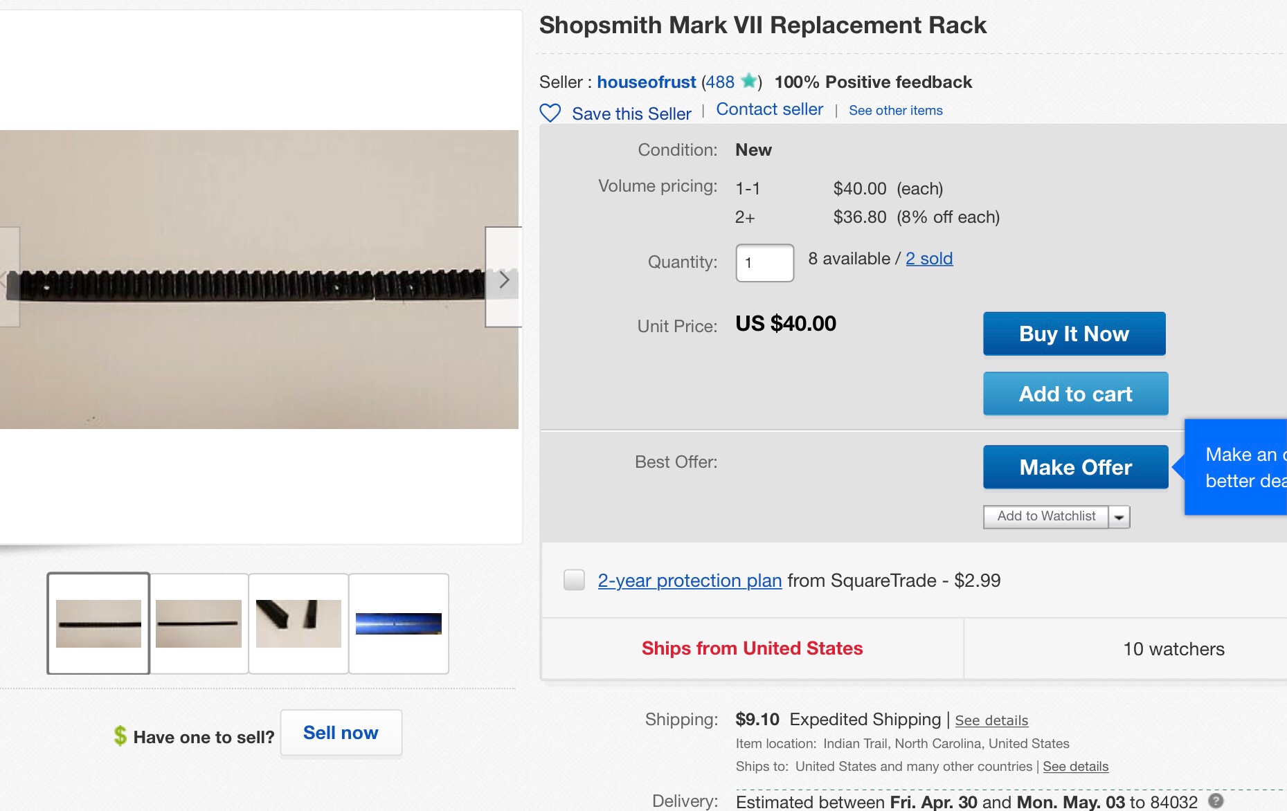

I am not very familiar with the Mark VII, but I did see an eBay seller (houseofrust) with a listing for what they were calling a “Shopsmith Mark VII Replacement Rack”. It looks like it is a 3D printed part. As I read the listing they are selling the replacement rack for one side for $40.
Re: Mark VII
The replacement part is half the length of the oem part.
Two oem parts are on the front way tube only.
So the e-bay pair for $40 replaces one oem part.
So to replace the entire rack costs $80.
The rear way tube has NO rack.
