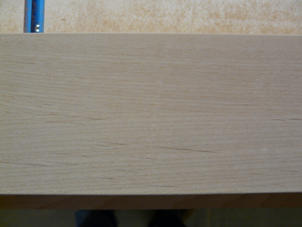

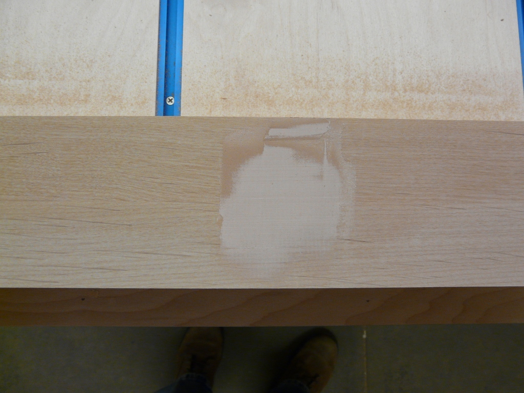

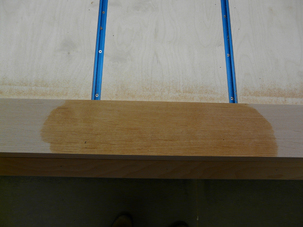

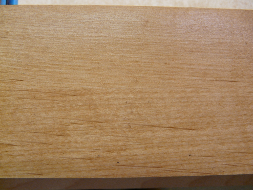

I decided to take another pass on the drum sander on all of the post using 220 grit paper.
I have sanded the putty off and soaked it with water once more to raise the grain. I let this dry really well and then sand it again.
The good news is that nothings shows up really dark. We can always make things darker with stain but the only way to lighten is to bleach.
While not totally gone I'm confident that my finish guy can shade this and make it disappear. Or at least blend in with the other character of alder.

Re: Occasionally In The Shop
This is the difference between myself and the pro. I don't see anything in that last image to hide.

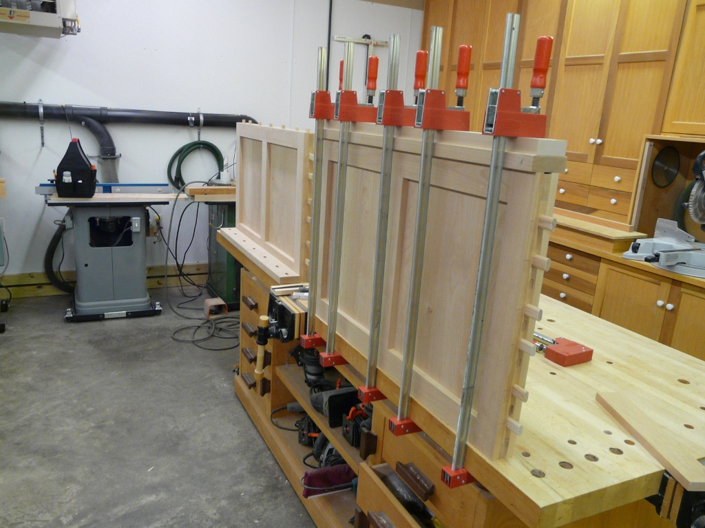

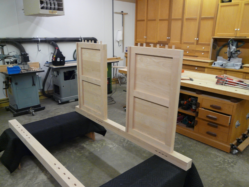

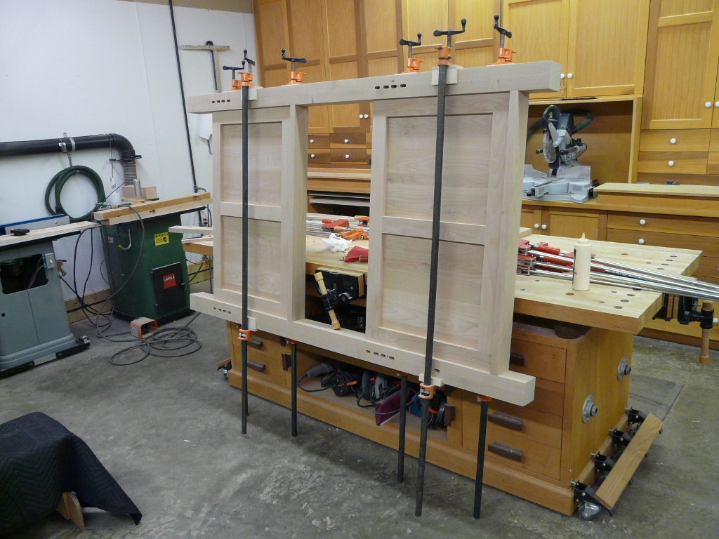

Time to punch and finish sand the caps.
Cap glued in place
With everything sanded it is important to protect from marring and clamp marks.
This if fun by yourself. :rolleyes:
Ok Im going to HD and get 2 more 6' clamps! ;)

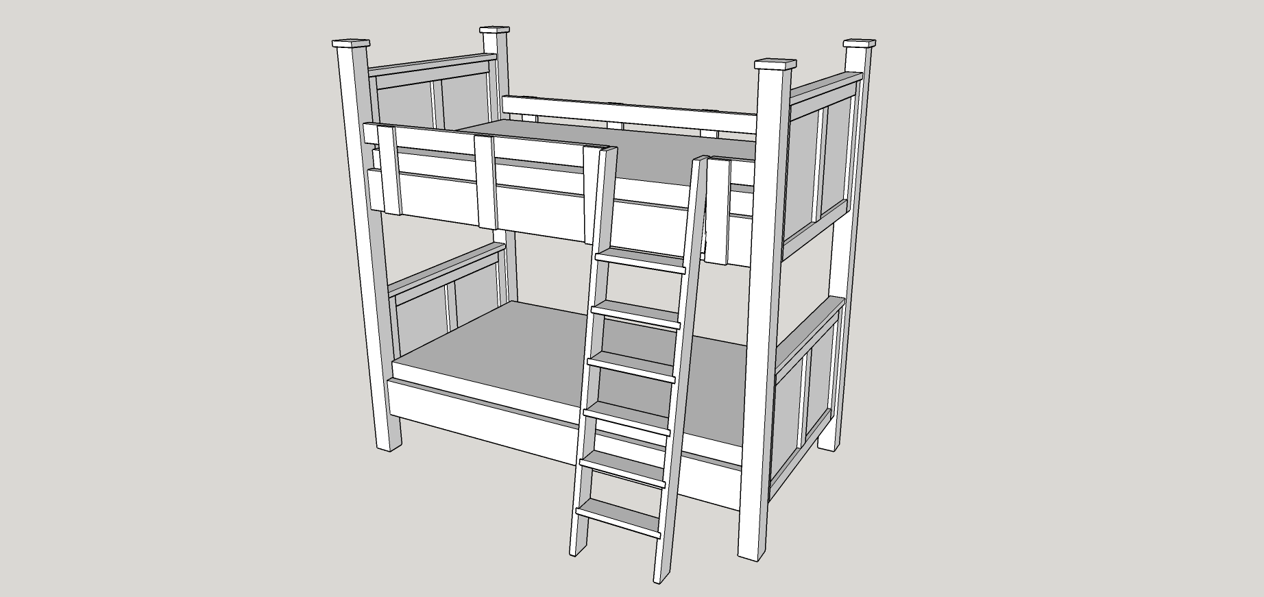

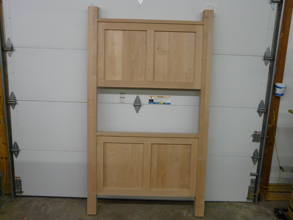

kablerj wrote:What are you making Mark? My guess is very sturdy bunk beds.
Jim
Congratulations Jim you win the prize! :)
Bunk Bed.png (50.2 KiB) Viewed 3441 times
Actually I am building 2 sets of these.

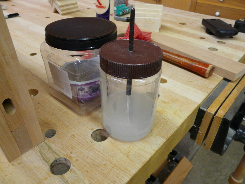

I drove all the way into town and HD was sold out of Pony clamp heads. I came back with a new glue brush. FYI the peanut butter jar is not included. :D
P1090439 (1024x768).jpg (355.8 KiB) Viewed 3441 times
Oh well one down. I will pick up some clamps at another HD tomorrow.
dusty wrote:This is the difference between myself and the pro. I don't see anything in that last image to hide.
Oh is is there alright. Like most things when one knows where it should be and what it is shaped like one can see 'it'. A casual observer would not notice.
I am sure with the ability to observe from more than a single vantage point(camera lens) would make it more discernible.
Look pretty damn good to me! What the stain will reveal????
