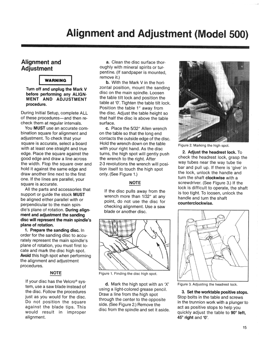

Lewis,
If you and your buddy do not have one already, download the Free 500 Summary Manual from Shopsmith directly. It is at http://www.shopsmith.com/getting_starte ... Manual.pdf
They too show using the long allen wrench with a sanding disc in a bit of a different manner than I mentioned. I have attached the page illustrating that from the manual for your review.
In it they say don't use the disk if it is 1/32" off. I don't use it if it is far less than that. More like .001" Keep a good flat one handy for alignment tasks.
As JPG elaborated, the test board needs to be flat and dimensionally true.
In all reality, it doesn't make a bit of difference either way if the board is 90° or even beveled at either of the ends, since neither end is used in the measurements in the single cut. The actual cut within it is used.
It does make a difference if the board is NOT flat on the face, back and edges and of a uniform thickness before you make your cut. That’s what JPG was referring to.
Everett
