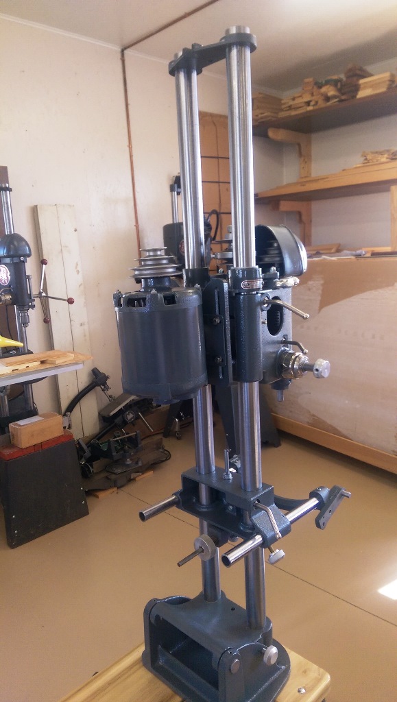

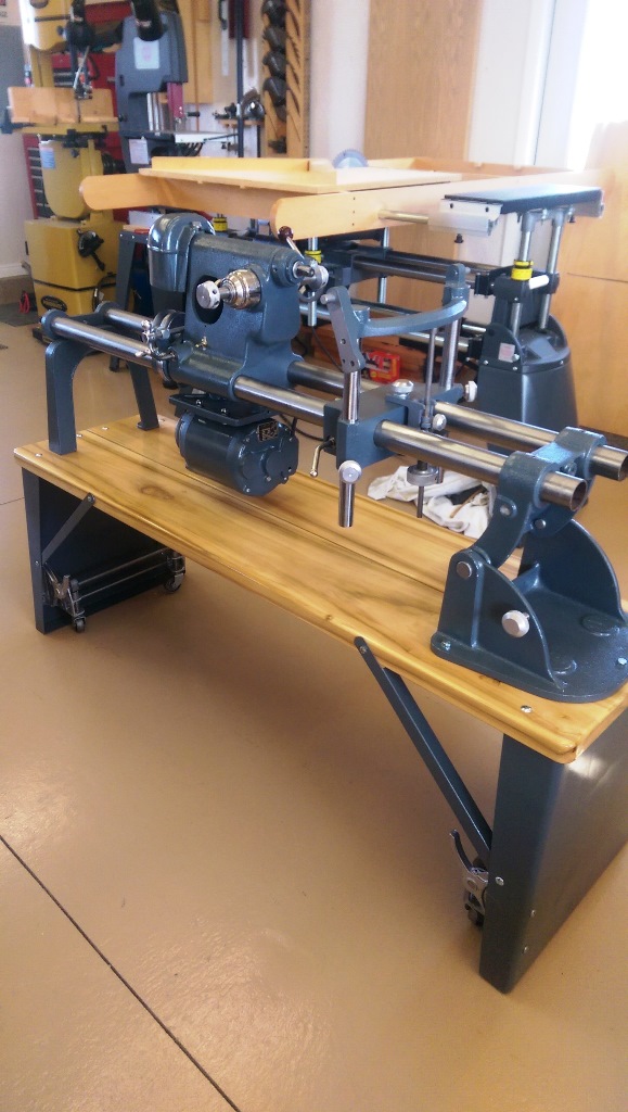

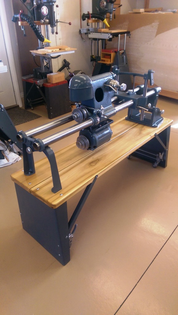

After a bunch of running around this morning, I got time in the shop to install the motor. Stainless steel hardware to attach the motor to the bracket. All non specific SS hardware is stainless steel. I also added stainless steel washers to all knobs and bolts where the head of the fastener bears on the machine.
I am installing a new 14 gauge power cord with ground. I am still looking for a local source for the crimp on ring terminals for the switch. 14 gauge terminals come in two ring sizes and the big box stores don't carry the smaller size that is needed. I also haven't decided where to ground the power cord to the machine.

Thanks!!! I need to order speed changer belts from Skip and polish the tables and this one will be done.
