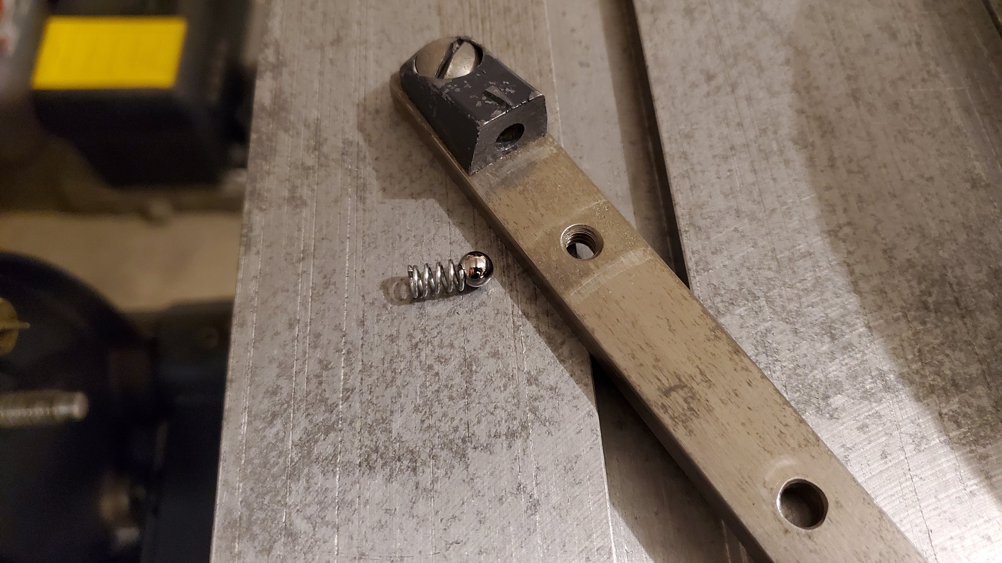

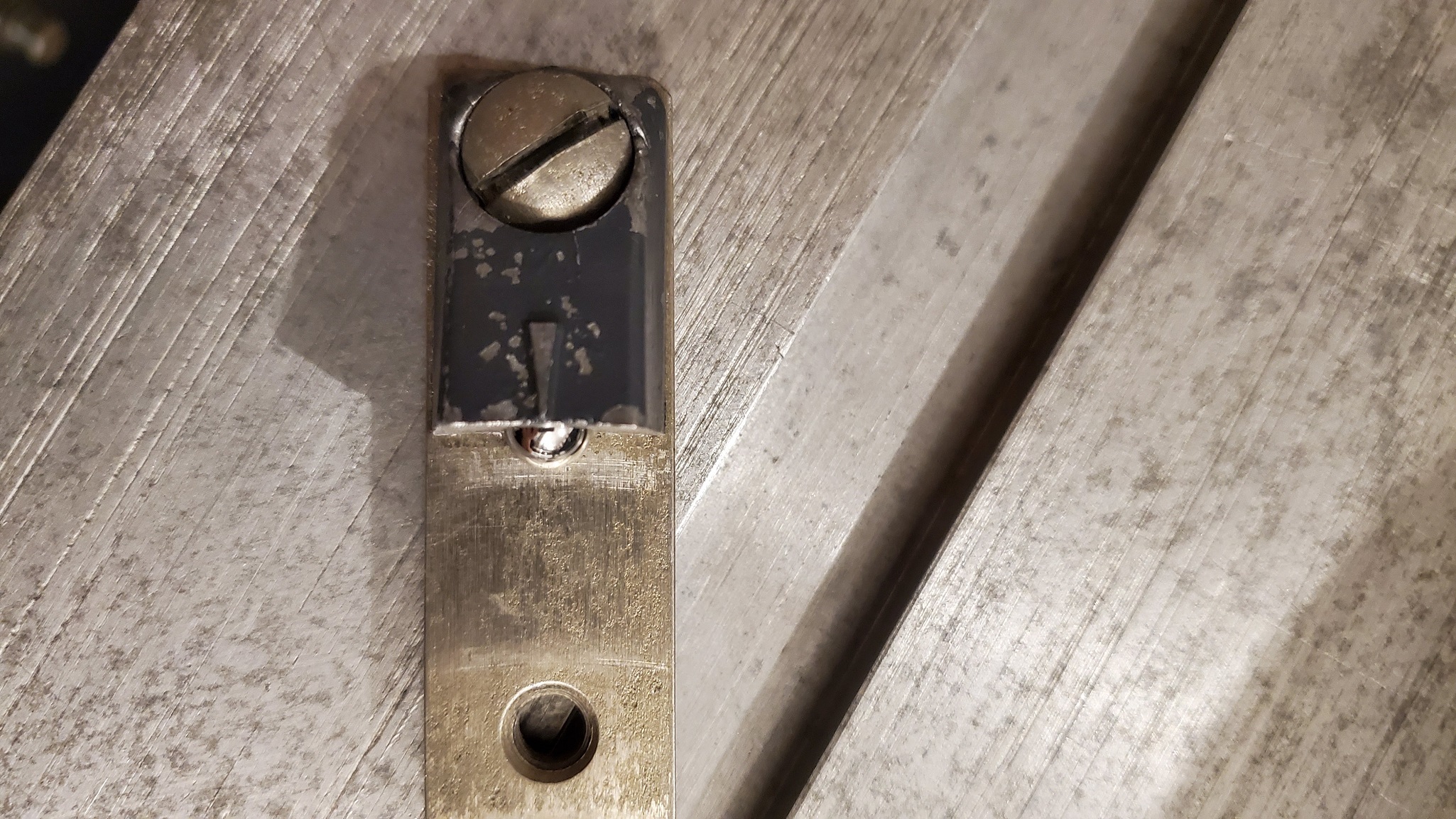

No worries. Hopefully you had a good vacation! Others on the forum have been great responding to my never ending list of questions as you can see. As for the missing miter parts, I'm thinking of trying a spring and steel ball combo like what I found in my spare craftsman miter. It shouldn't be that hard to find them in 1/4" D.

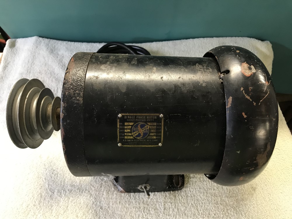

I do find it interesting that the motors do not need new bearings as often and I have not needed to replace that many. The A. O. Smith motors just seem to keep going and going. I even have two very early A. O. Smith motors (shown below) from My Shopsmith Model 10E's S/N 1033 and 1077 that the bearings are still good on. When you had the motor apart did you check to see how smoothly the bearings turned? That would be your best indicator.

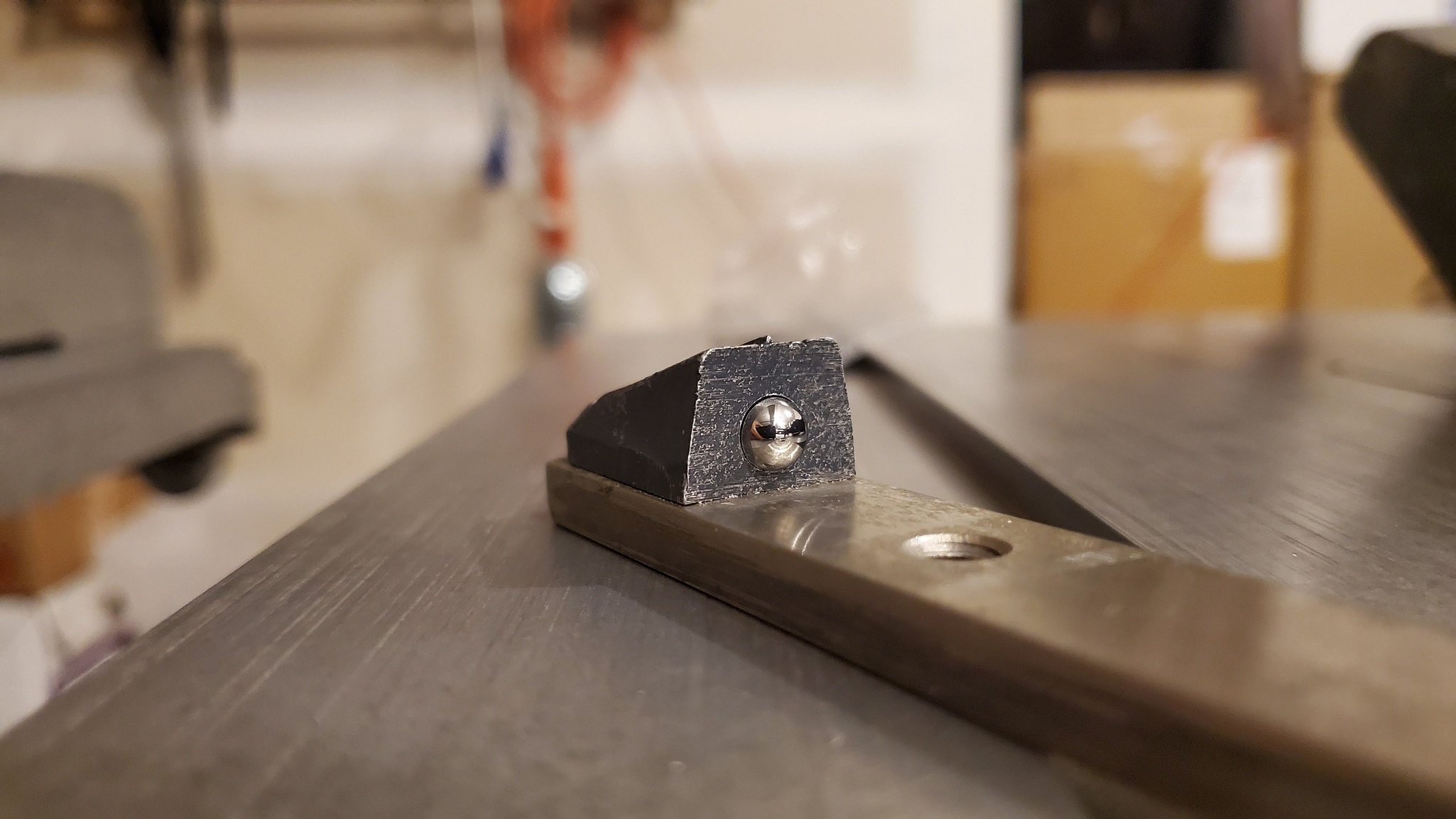

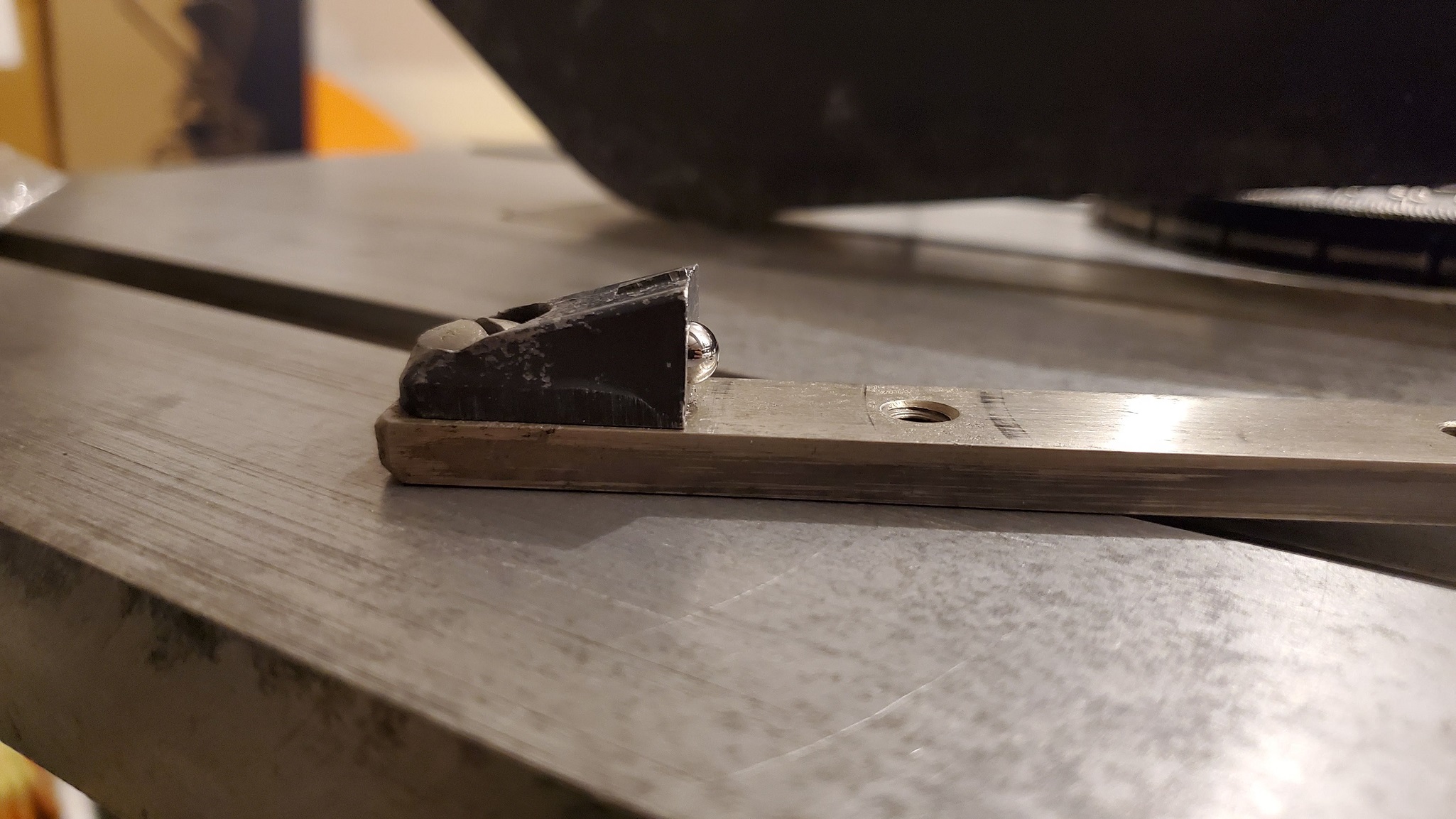

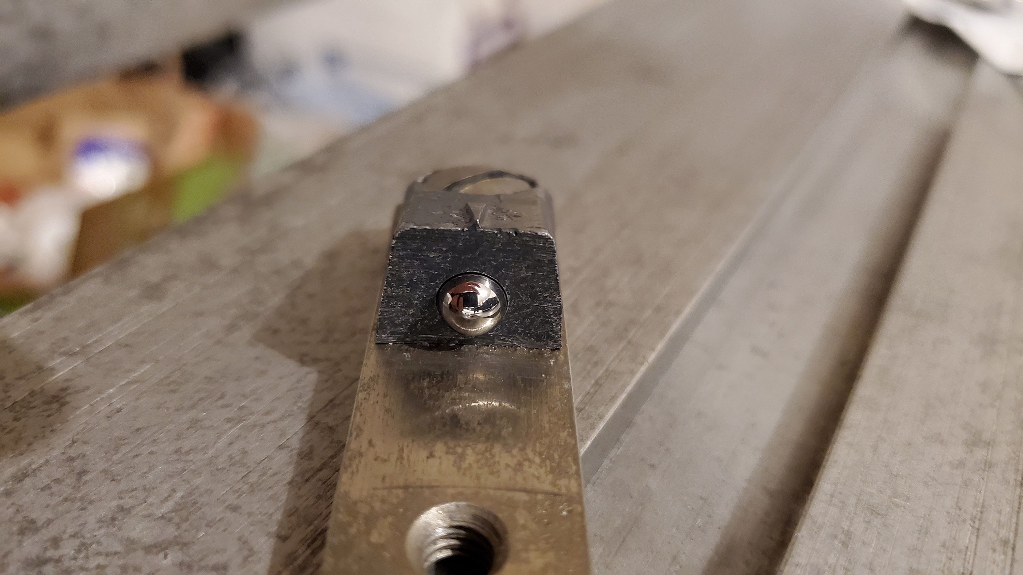

Miter update -
Here is what I ended up using.
1/4" diameter steel ball
<1/4" diameter spring cut to length. I went with a stiff spring so the ball sits in the hole and doesn't try and shoot out.

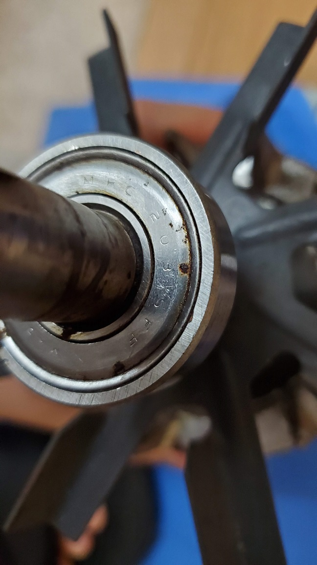

New issue - With belts, the SS was making a hissing sound that was intermittent at first and eventually became consistent with in a few minutes. I was able to pinpoint it to the motor, near the pulley. In no time, I had the motor apart and this time I separated the shaft from the motor cover to fully inspect the bearing. The side that was not visible before was covered in thick grease that I'm assuming leaked from the bearing?? I was also able to reproduce the hissing sound by turning the bearing (really fast).

Could someone confirm this is the correct replacement bearing for my motor?
Marking on old bearing - MRC 203 SFF
Replacement on Amazon - Mrc 203SFF Single Row Ball Bearing https://www.amazon.com/dp/B005YS780I/re ... aFbRR8QTE3
