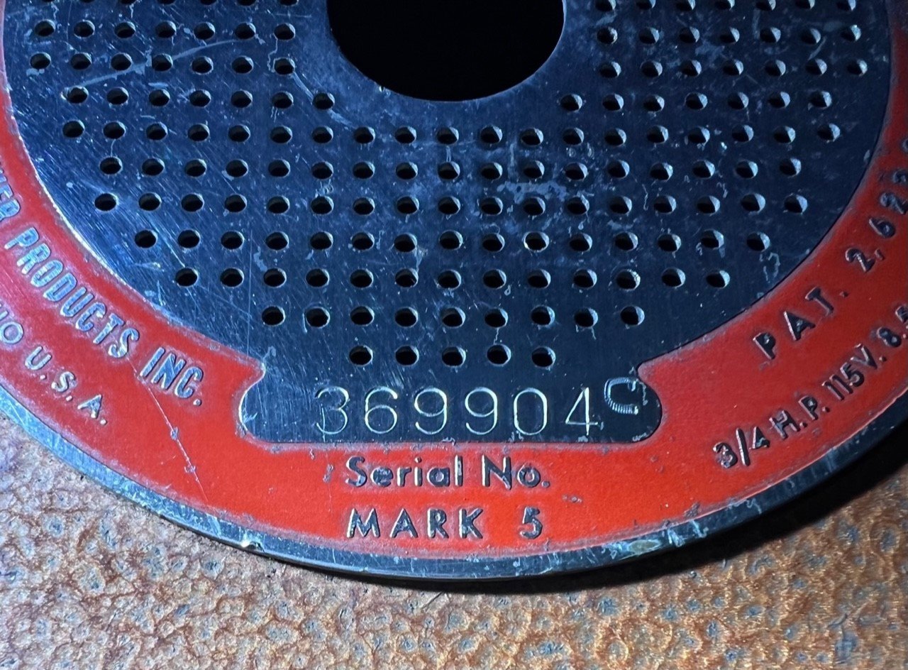

Units with a “C” at the end of their Serial number during this time require a special Quill.
The picture below is the Vent/serial number plate from one of those Mark 5’s. The suffix “C” appears to be hand engraved on the plate after the serial number.
_
Picture from John Dalton
How was this Quill “special” that differed from the Quill for the Gilmer or Poly V Drives. Was there any other differences? The answer comes from Forum Member John Dalton and his recent addition of a Mark 5 Goldie serial number 369904C made in March of 1961. John has shared information and pictures of those differences. The Headstock parts appear to be original and the V belt even has the Yuba name on it.

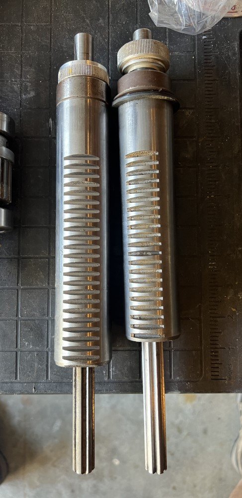

The Quill in his “C” suffix Goldie has a shorter outer sleeve. The picture below shows a Quill Assembly on the left from an earlier Mark 5 and the special Quill Assembly on the right.
_
Quills - regular and special.jpg (109.9 KiB) Viewed 71137 times

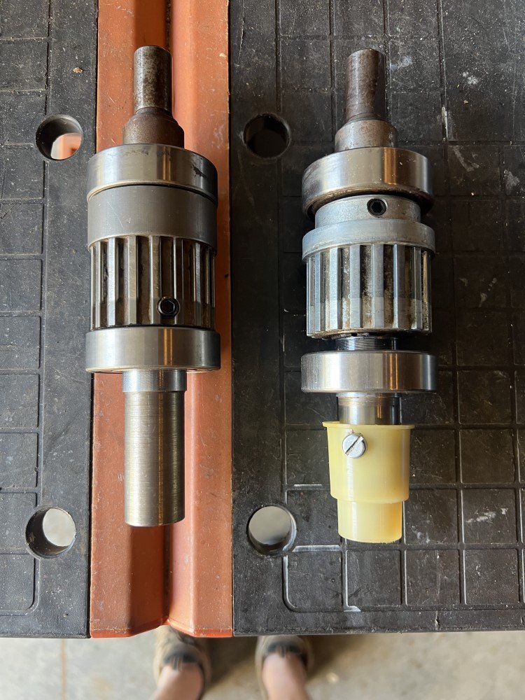

That is not the most notable difference though. The Drive Sleeve Assembly has the biggest difference. The center sleeve itself does not have splines but appears to possibly be using the nylon splined cap from the Mark 2 Drive Sleeve Assembly. This is similar in function to the Drive & Ring which is current part number 514083 used on all Mark 5/V’s since the change to the Poly V Drive in 1961 but with six splines. The cap for the Mark 2 and the one used in these Mark 5’s are attached to the Drive Sleeve with two screws. Below is a picture of an early non-clutched Gilmer Drive Sleeve Assembly on the left and the Drive Sleeve Assembly from S/N 369904C on the right.

Gilmer Drives - early regular and special.jpg (182.2 KiB) Viewed 71137 times
John didn’t have one to compare it to so below is a picture of a Clutched Gilmer Drive Sleeve Assembly. The plastic cap seen on this one does not have splines and is a simple friction fit.

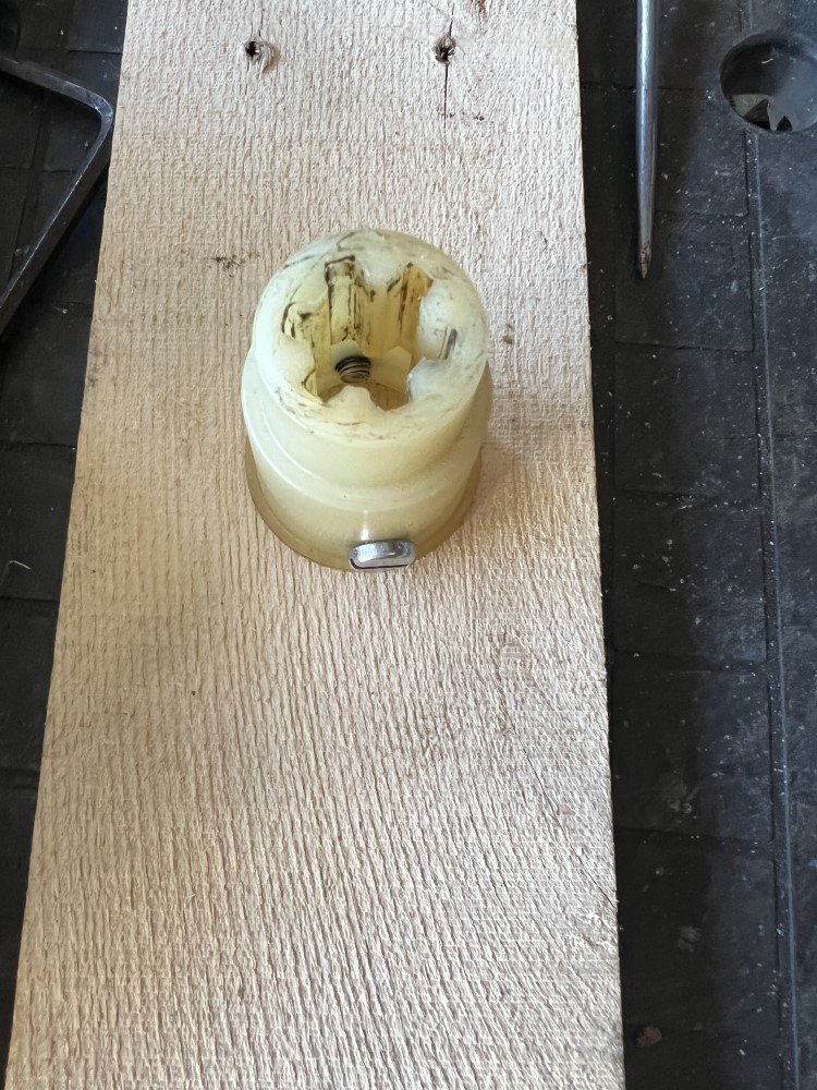

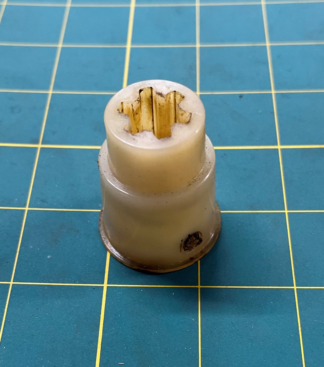

Below is the cap itself from S/N 369904C
_
Nylon Drive sleeve.jpg (210.62 KiB) Viewed 71137 times

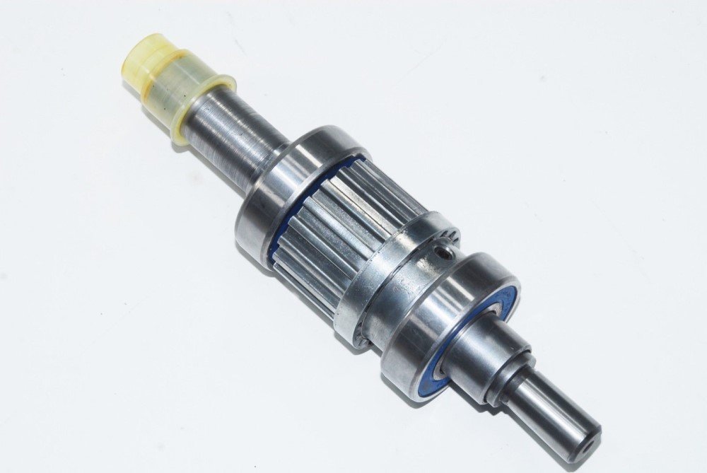

Below is the cap from my Mark 2
_
400026 Drive Sleeve Assembly part - spline end.jpg (169.47 KiB) Viewed 71137 times
We can only guess why these suffix “C” machines existed. Was it to use up the early 6 splined Quills and Gilmer clutched gears when the center sleeve from the Gilmer Drive Assemblies had all been used up. Using the cap from the Mark 2 Drive Sleeve Assembly appears to have made that possible. So why was it necessary to shorten the outer sleeve of the “special” Quill?

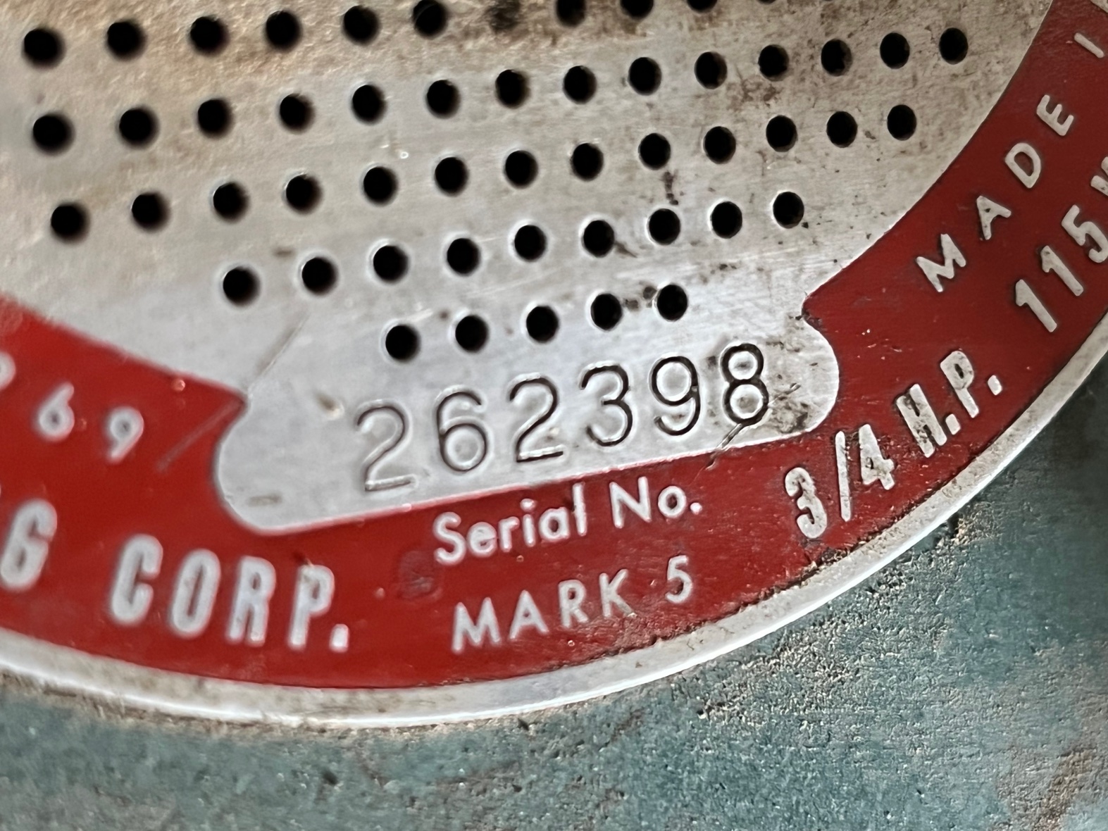

I have my grandpa’s shop smith mark 5 serial number is earlier than the ones on their site mine is 262398. They sent him the improved gilmer belt in August 1954

by chapmanruss
For anyone wondering about the Serial Number 262398 Davidhaal posted about above I would refer you back to the middle of page 3 where I discussed serial numbers and when they were made.
