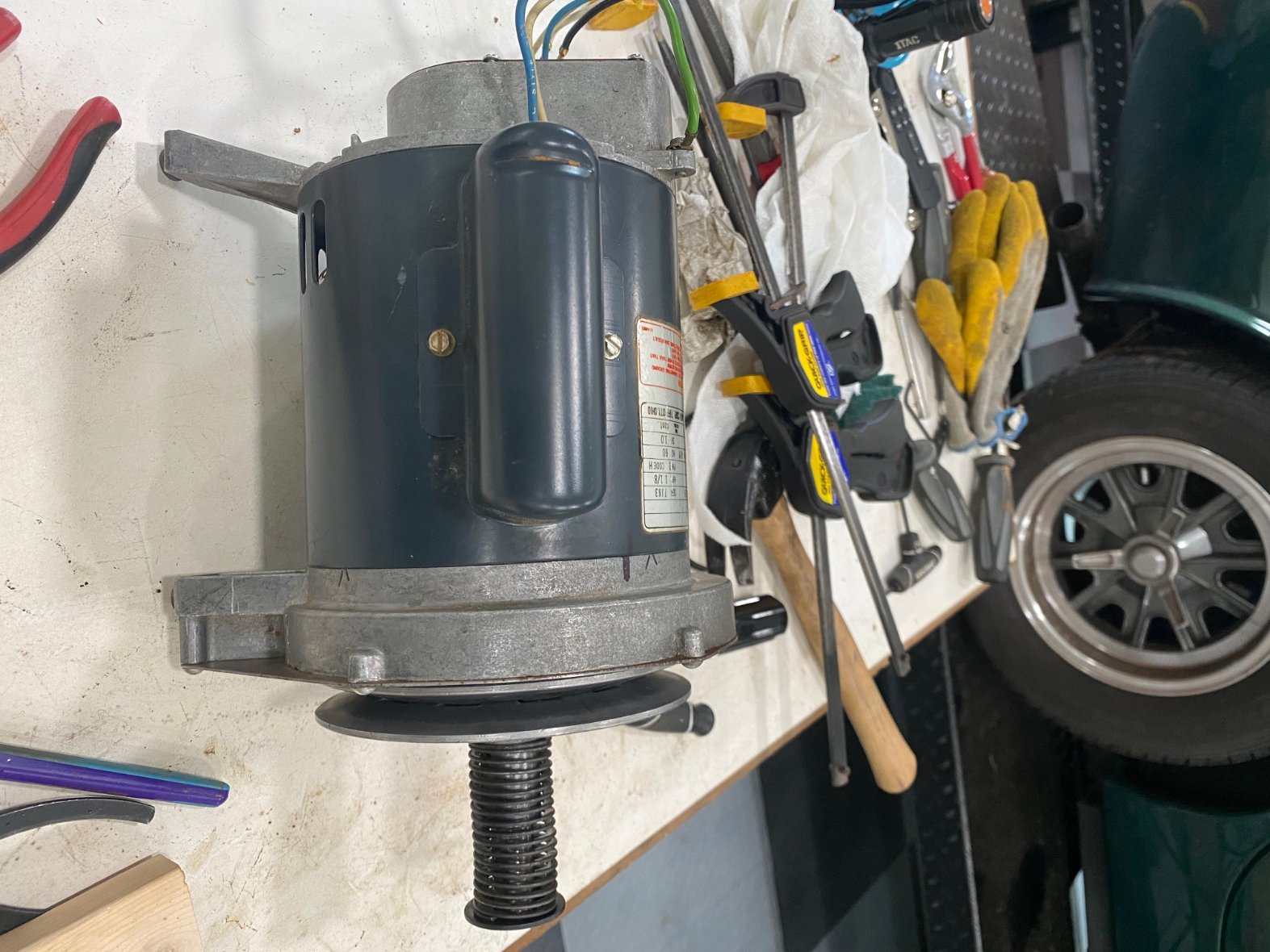

Got the motor out and vacuumed off, here's a test run, thoughts?
https://youtu.be/UQYvWRhpCSk
Posts: 35453
Re: Refurbishing a MkV 510
Sounds like firm positive start switch actuator. Motor running sounds good.
Did you attempt to blow out the internals of the motor?

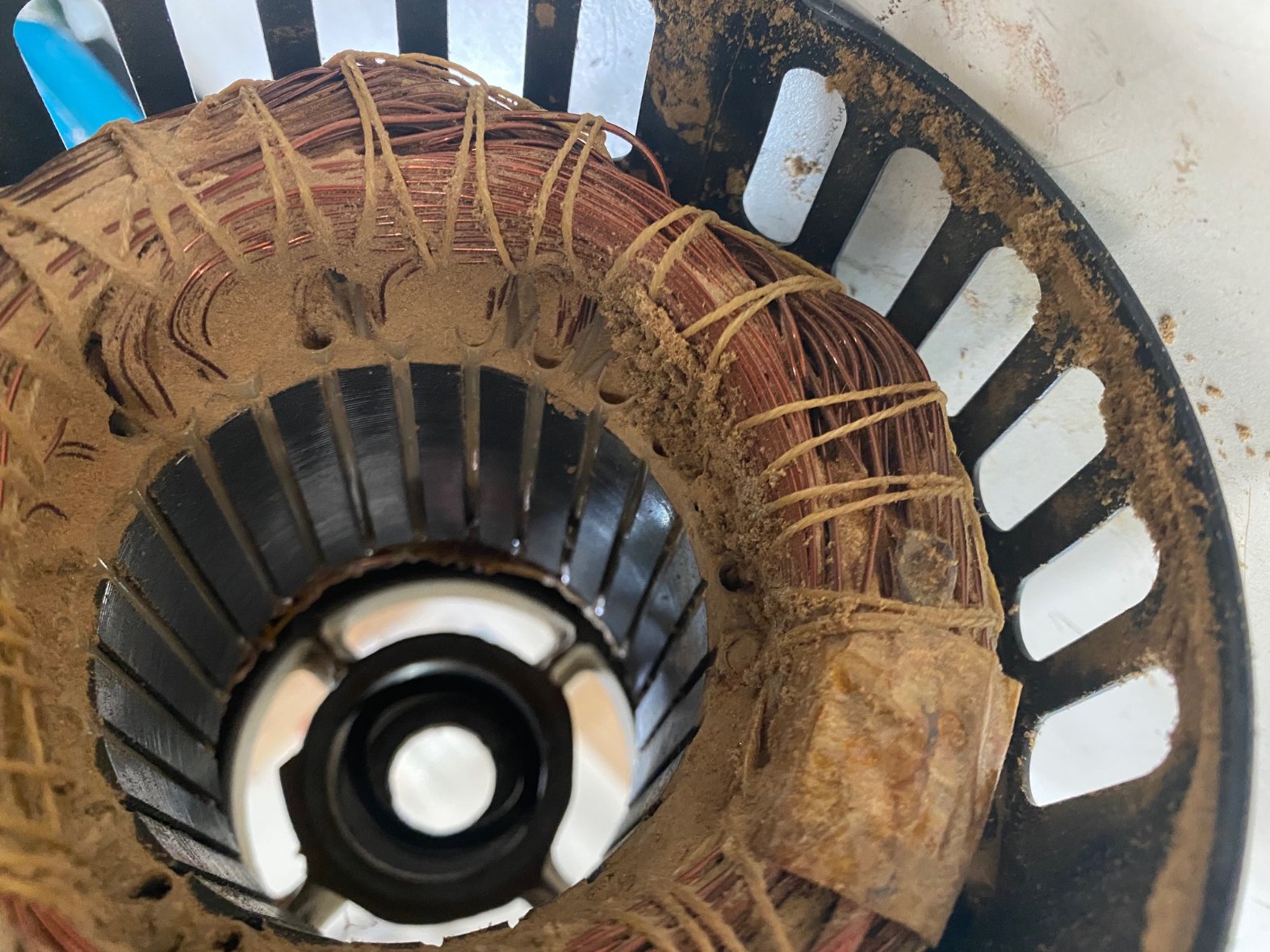

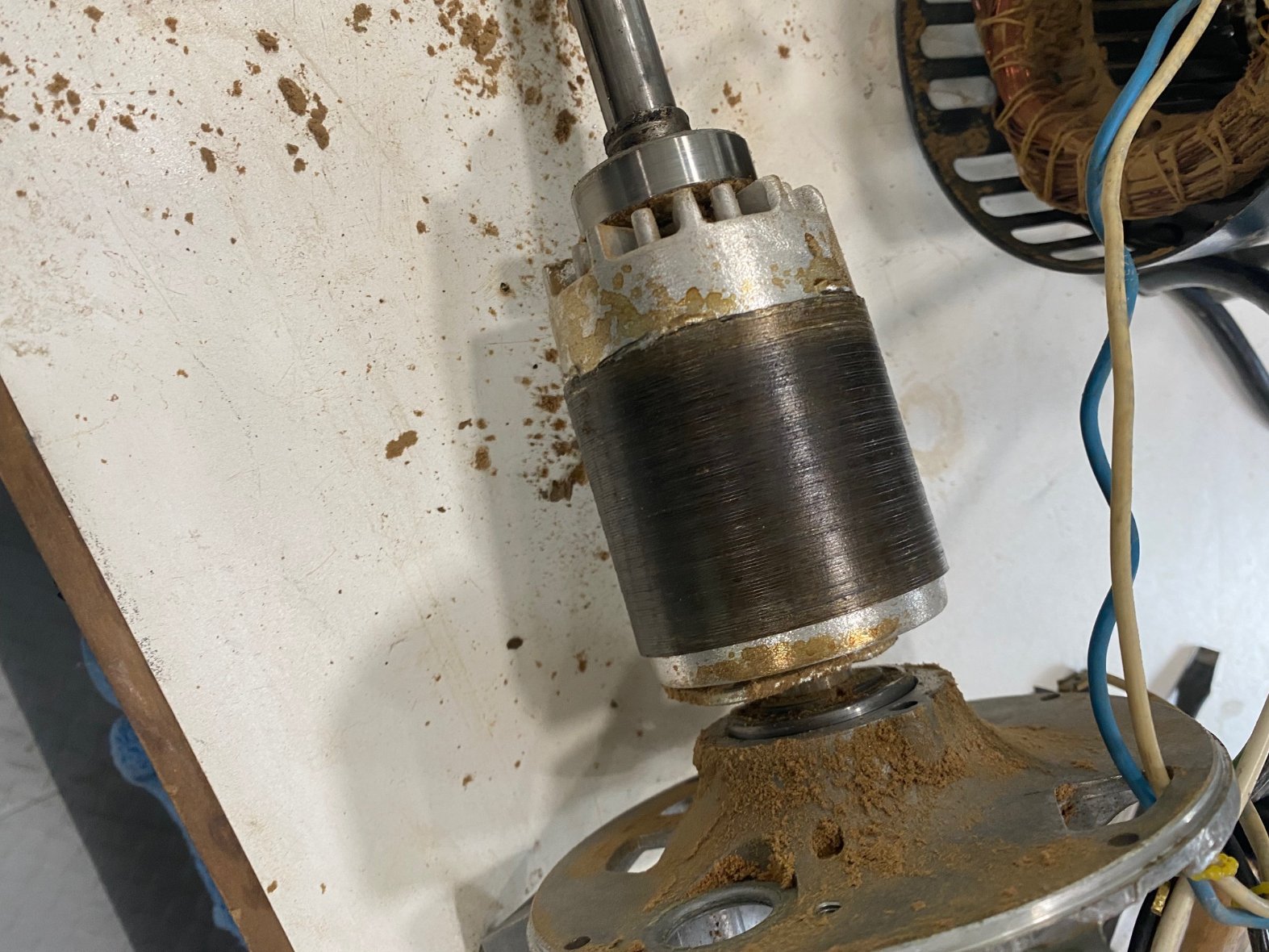

JPG wrote: Sun Sep 19, 2021 11:12 am Sounds like firm positive start switch actuator. Motor running sounds good.
I did, but there's a lot of sawdust still in there. I though it sounded good too. I didn't hear any bearing noise, I may get away with just taking it apart and cleaning it
Posts: 35453
Taking it apart and cleaning out the dust IS the next step.

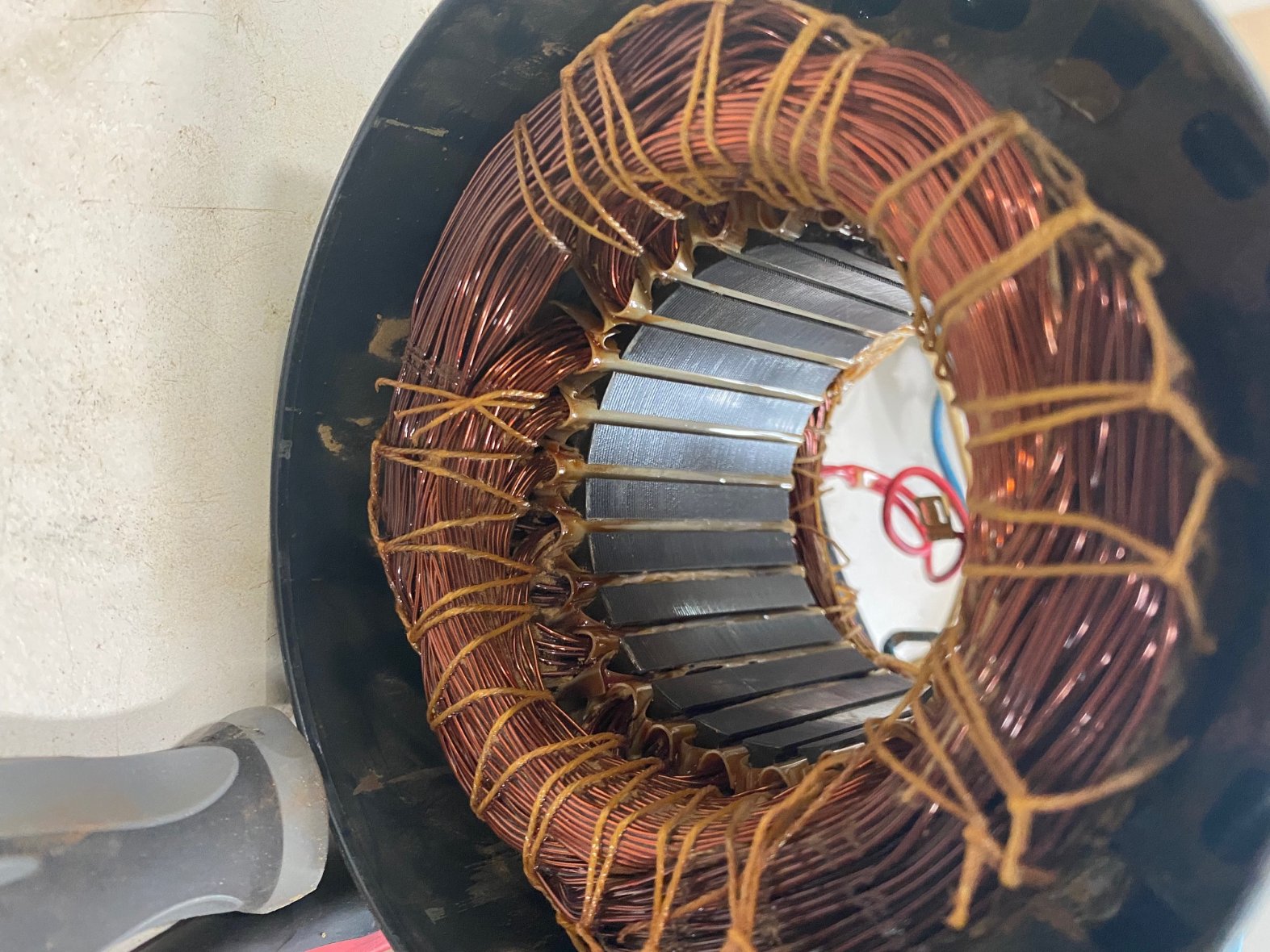

Well, apart, cleaned and back together in the same day. To my astonishment, it works....

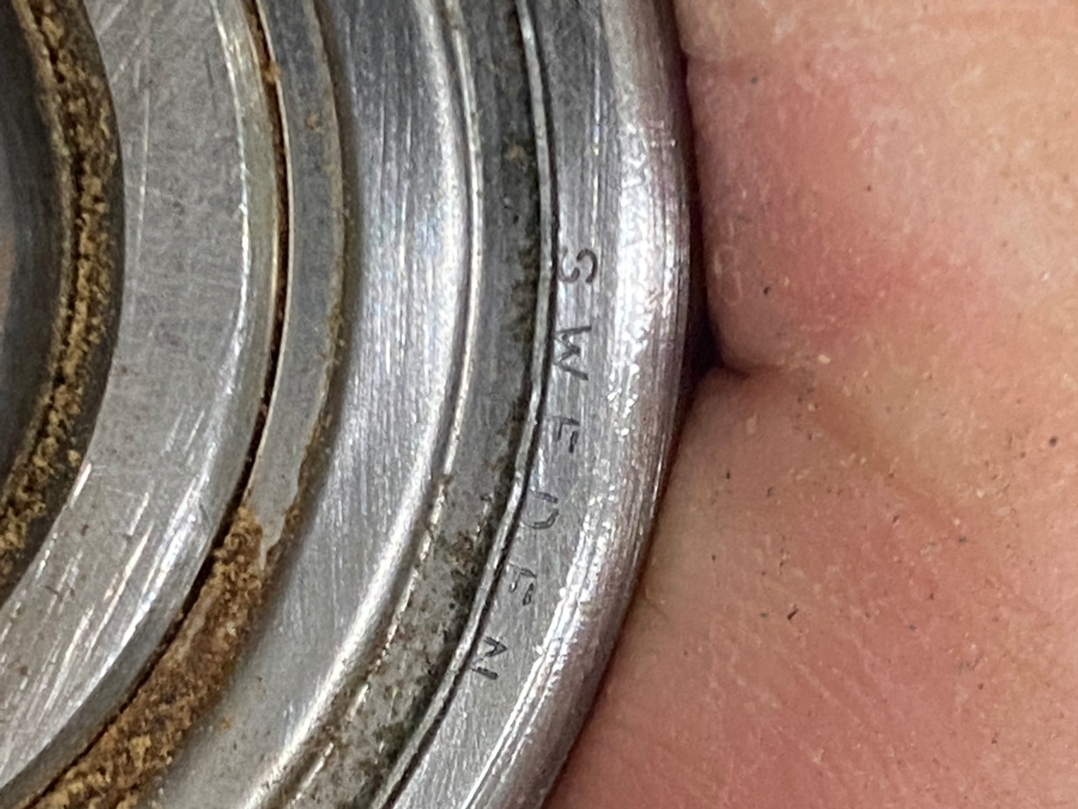

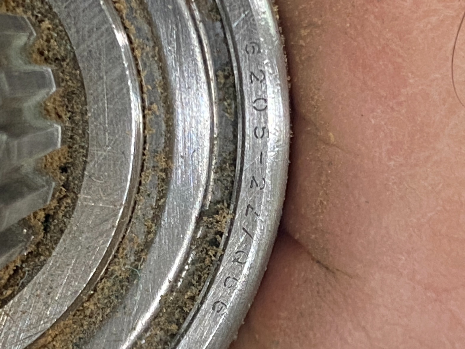

Hi guys, I’m confused about the poly v belt bearings I need. The bearing document refers to p/n 501297, but mine have a different number. Am I just overthinking this somehow?
Posts: 6553
Different manufacturers have different numbers. Who made the bearings in your machine?

jsburger wrote: Sun Sep 19, 2021 8:54 pm Different manufacturers have different numbers. Who made the bearings in your machine?
No idea, I presume they are original equipment.
Posts: 35453
Drive sleeve?
6205-2Z = 25 x 52 x15 mm double shielded
Replace with 25 x 52 x 15 2RS

JPG wrote: Sun Sep 19, 2021 10:01 pm Drive sleeve?
Thank you very much, got 'em on the way
