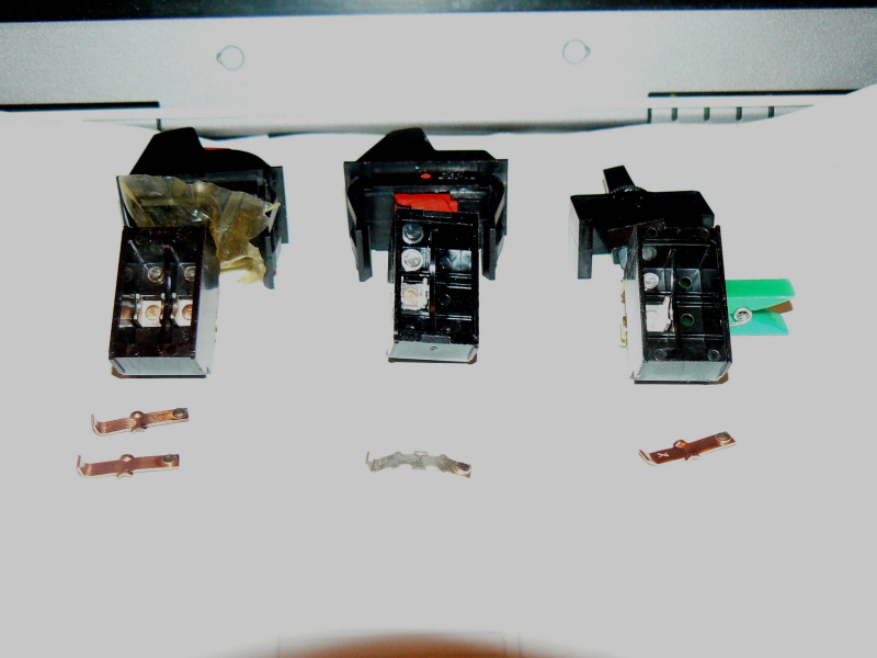

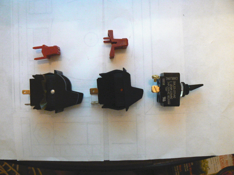

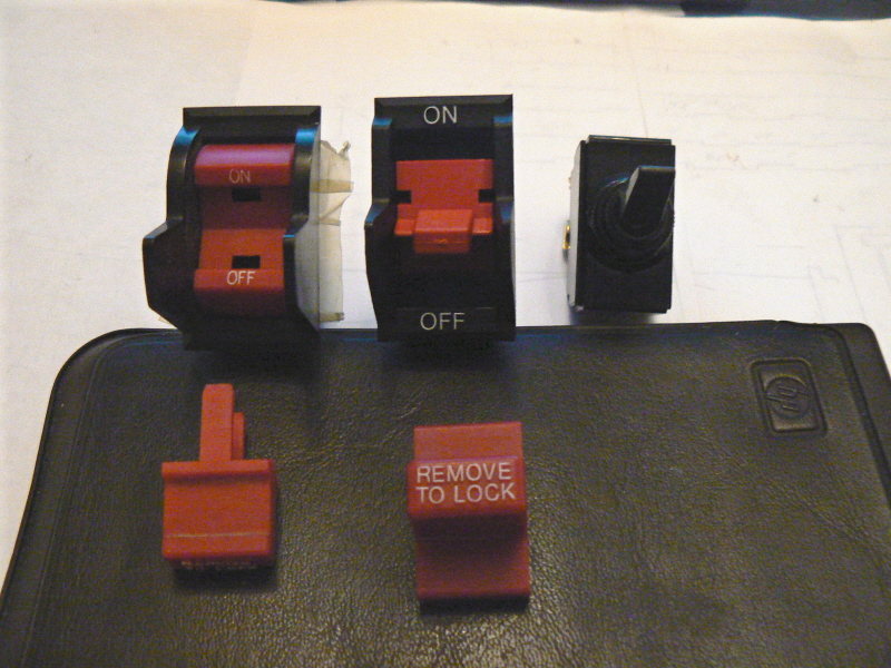

Picked up an ACE PN 3135878 'rocker switch' yesterday. I also picked up an ACE PN 33492 'toggle switch(non-metallic). The pix below show a SS switch and the two ace switches. The 'toggle switch' is of interest because the switch portion can be attached to a SS actuator. The 'toggle switch' is SPST. Ace PN 33493 is a DPDT, BUT is center off(3 position). I did not get one of those to determine WHAT makes it a center off.
The original SS switch is a 'McGill'. The Ace 3135878 is an EATON. The Ace 33492 is a Carling. The switch portion clamps onto the actuator the same on all three switches. The hole mounting of the SS and Ace 3135878 are identical.
The SS switch is on the left, the Ace 3135878 in the middle and the Ace 33492 is on the right in all pix.

This shows the differences in the actuator portion. The removable 'key' is different.
[ATTACH]4670[/ATTACH]
This again shows the differences in the actuators from the side.

This shows the guts of the switches. The contact arms(copper colored) of the SS and Ace 33492 appear identical. The Ace 3135878 appears more substantial and the contact button(s) are larger(implies greater capacity/life).
The actuators(inside that move the contact arms) although different will function interchangeably.
The rear termination is different on all three. The SS has 3/16" tabs, the Ace 3135878 has 1/4" tabs and the Ace 33492 has scew terminals.
SO; What does all this mean?
A) The switch portion of any of the three can be put on any of the other actuators. This AIN'T easy. Some would say IMPOSSIBLE! Requires extreme patience(try/try/try/try/ again and again). These parts just sit in position until you try to assemble them, then any sudden motion causes them to 'get out' of their assigned location! After putting one back together do NOT force anything(during assembly OR after). Take it back apart and start over!
B) Because of A, an option for a bad SS switch would be to replace only the electrical switch portion and continue to use the SS actuator. Termination needs to also be 'solved'. See C for white wiring directions.
C) The Ace 3135878 could be used on a 115V SS by tieing the neutral(white) wires together and connecting the other two wires to the new switch(again termination needs to be solved).

One last 'difference'. The SS switch is dust proofed with a membrane between the actuator and the switch. The 33492 has HOLES in the back which would NEED to be PLUGGED!!
