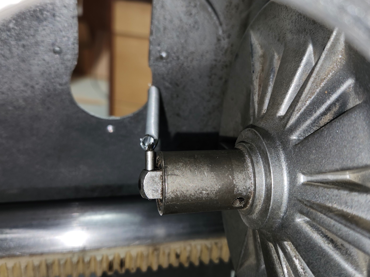

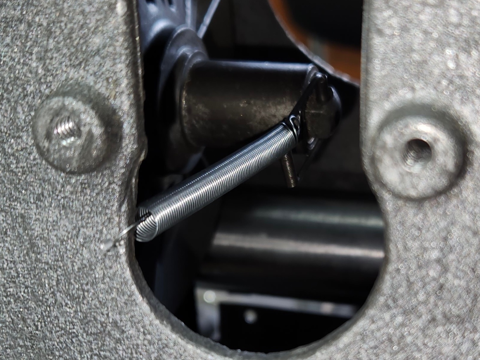

JPG wrote: Sat Oct 07, 2023 8:33 pm I consider the pinned follower to serve the same purpose as the wire loop on the m5. IMHO the pins only become relevant with sluggish response of the floating sheave due to either too fast adjustment of the speed dial or inadequate lubrication of the floating sheave. Main purpose is non-rotation of the inner race of the control sheave bearing.
While I’m waiting for my new eBay sheave and my new printed cam to arrive I’ve been giving this some thought.
For the first part, sluggish return to high speed would be a good indicator that it’s past time for lubrication. That makes it actually more of a good thing than a bad one.
The second part made more sense to me. You do want to prevent the inner race from rotating so I thought I’d try a spring between the button bearing’s bail and the headstock case. The one I have in the pics is very light and may need some tweaking but I think the concept works. The idea is enough tension to prevent spinning but not enough to create an axial pulling force on the bearing. I think it can be quite light as I don’t think it would take much to prevent spinning if the bearing is good.

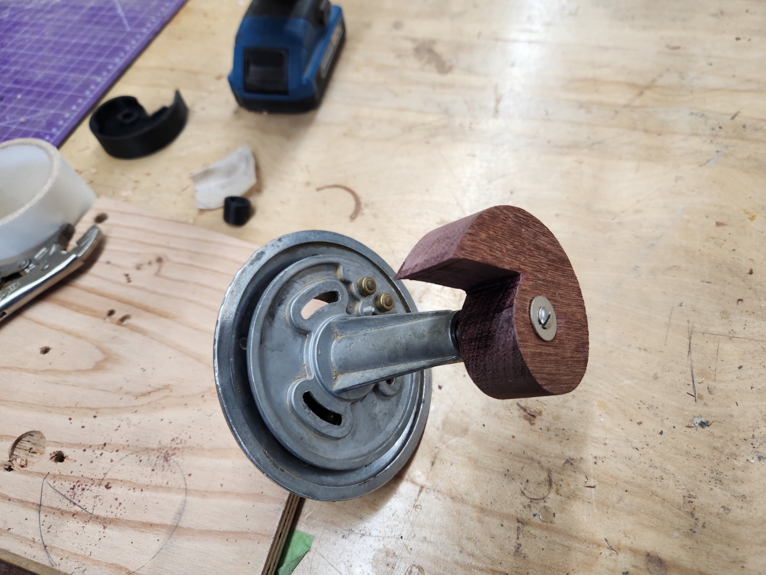

Good news / bad news. I got the 3D printed cam and immediately broke it while fitting the shaft.
So on to another angle of attack. I decided that the cam could be solid and much more robust if I was going to use a button bearing and have no need for a flanged edge. When you discard the U shaped follower and its roll pins the cam design becomes much simpler to reproduce. I decided to try some Purpleheart I had around and it only took maybe an hour all together to make what I think will work well. Time will tell. I’m still waiting for the eBay sheaves to arrive.
The finished cam is pictured here and a detailed step by step to make one is here.
https://photos.app.goo.gl/mV1QkEDC9PVcD54C6
