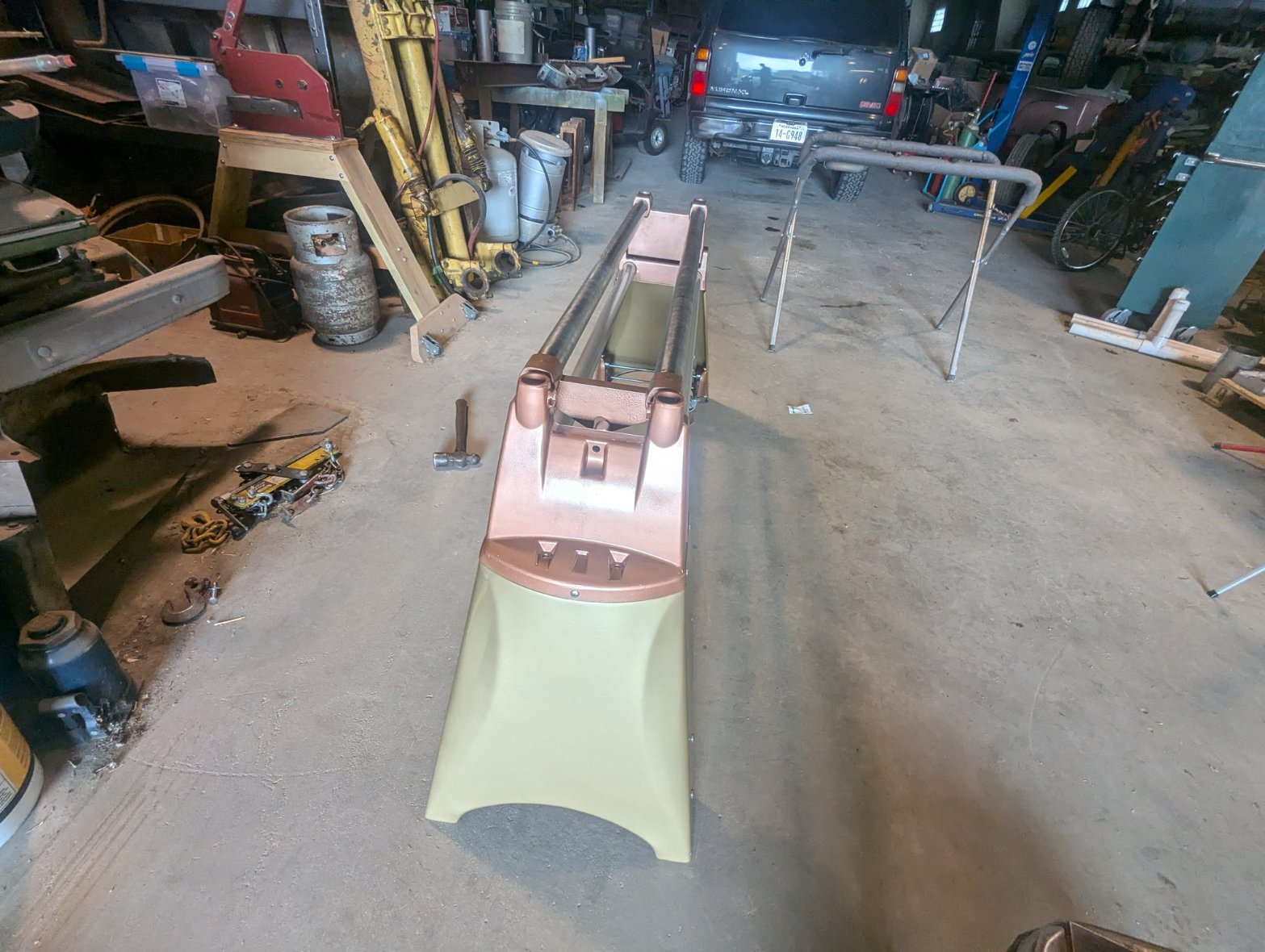

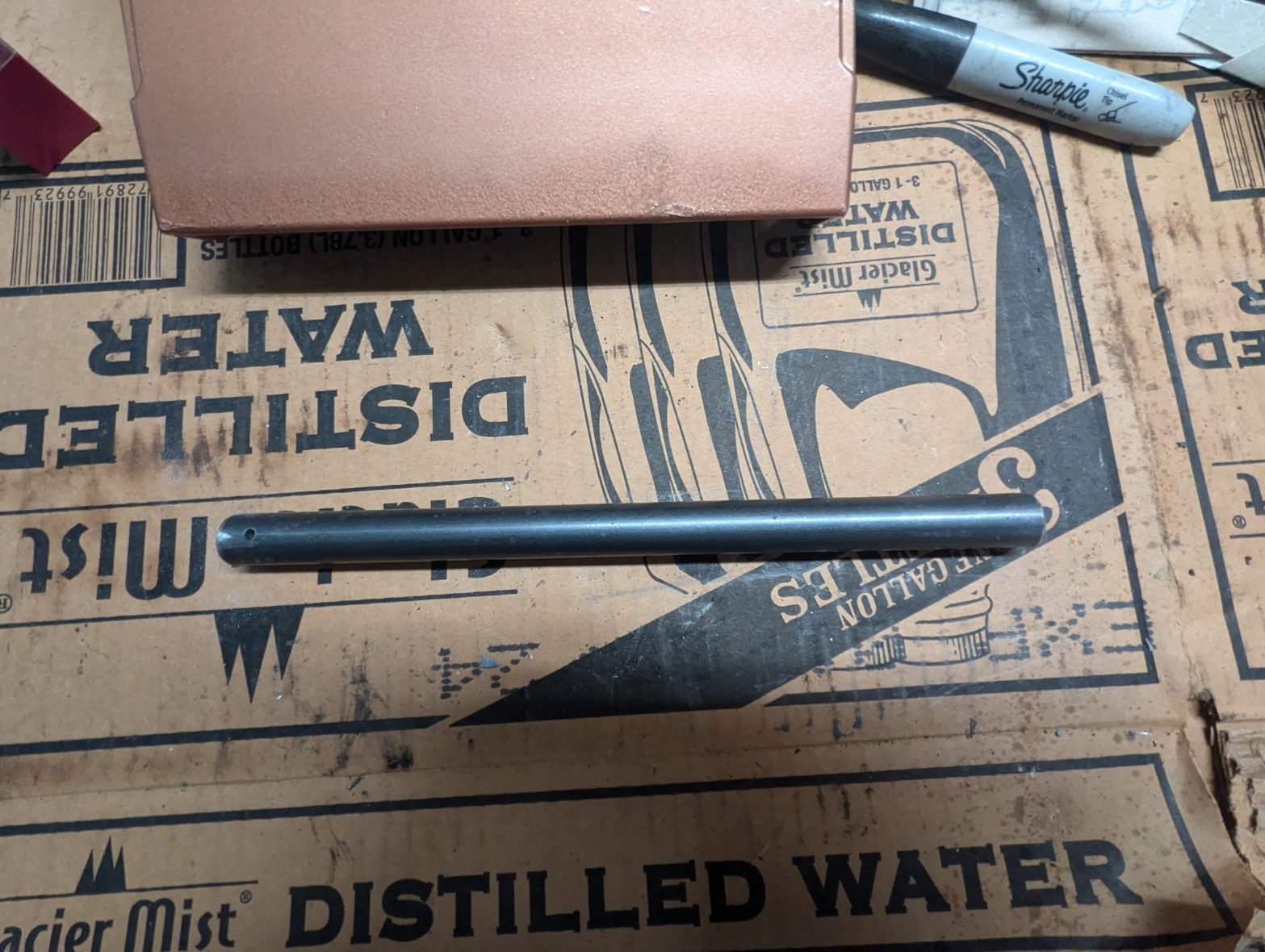

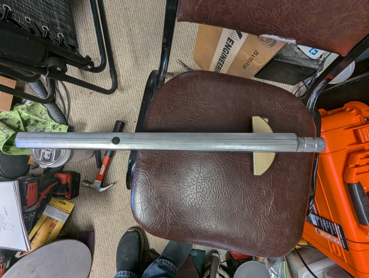

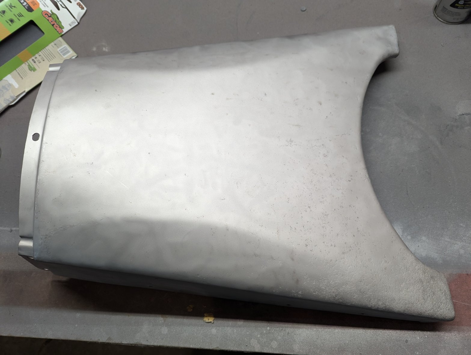

Re: Yet another "Goldie" Restoration
Made more progress this weekend.
I was able to get the side panels media blasted, primed and one of them I was able to get some color on. I don't have a pic yet of the color, I didn't have good lighting. I will get that in the next couple of days.
I also finished up the fence.
Finally, I made a new base arm pin for 3/4" stock.
Getting close to putting the base back together.

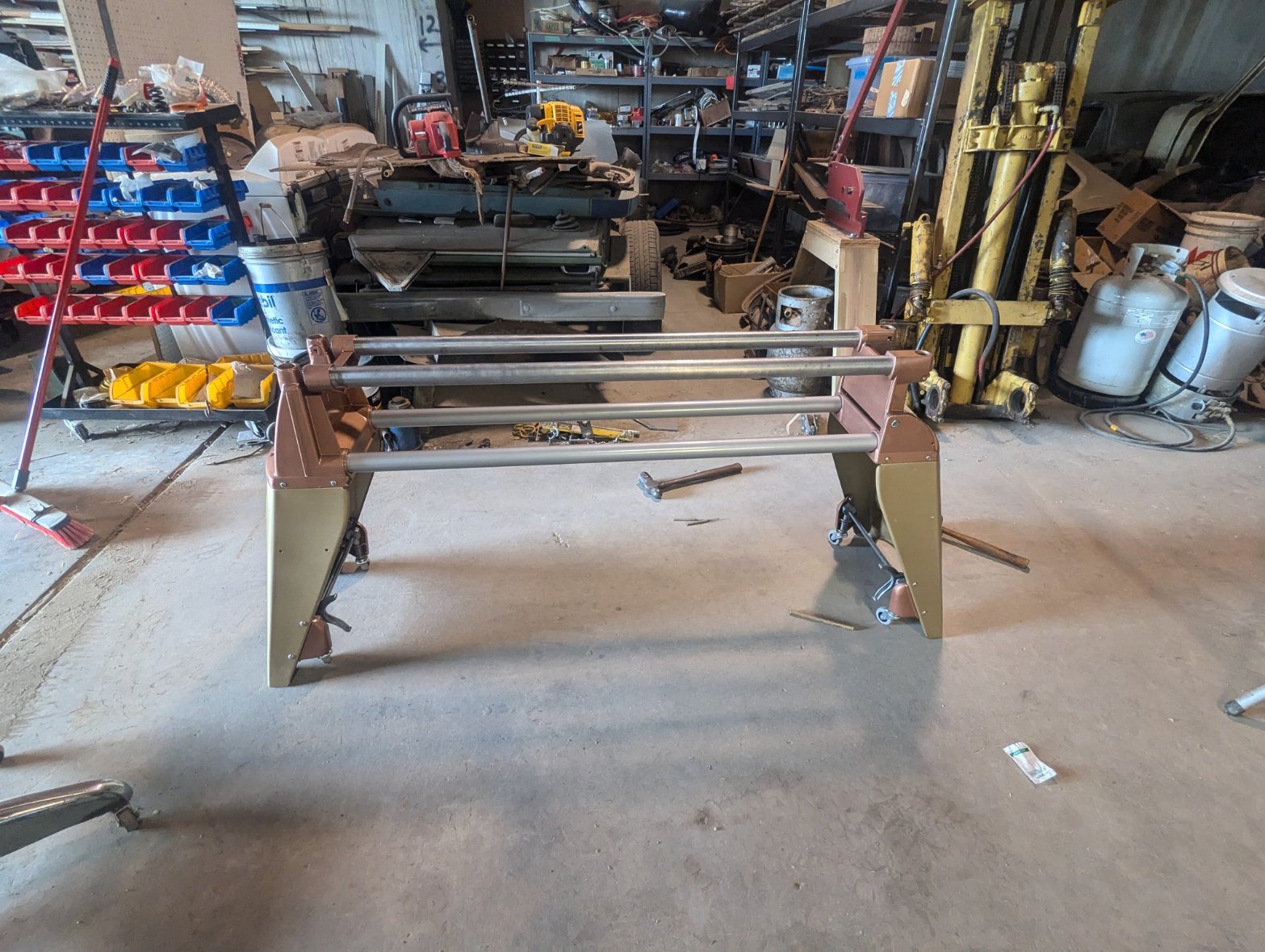

Finally started putting something back together.
Now on to the Carriage and Table Trunion.

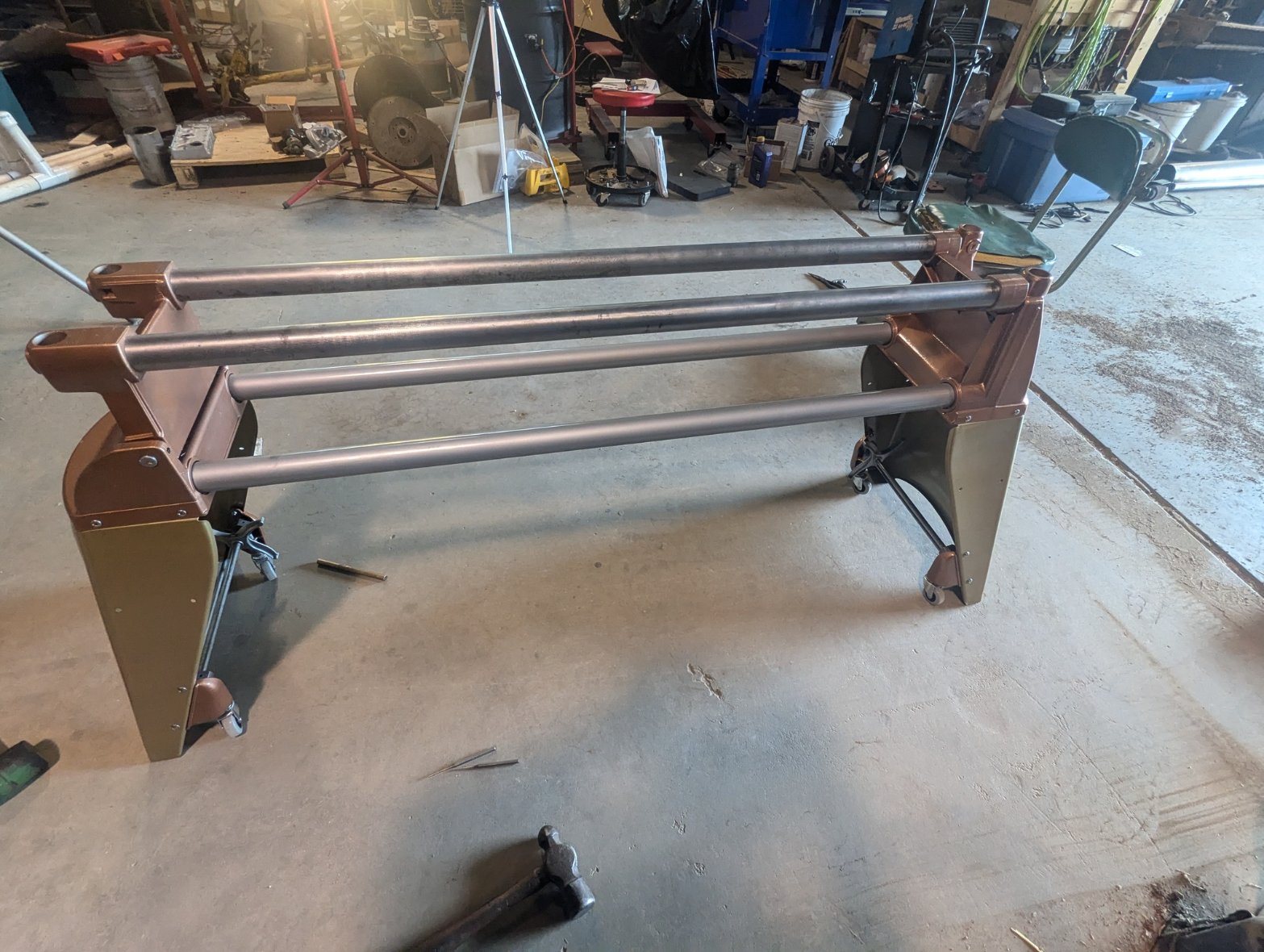

Here is a round up of the latest work.

- Posts: 35598
Looking VERY good, but The foot pedals are upside down.
I see that. When I got it, the castors were on the pedals were on the back instead of the front, so I flipped them. In my haste to get it back together, I didn't notice them being upside down. I think I should be able to just take them off and flip the "pedal rods" from one side to the other. I put them back together according to the marks I made on them when I took them apart.
Welp two steps forward and one back.
Thanks for the attention to detail, I want to get this right.
