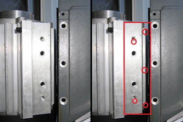

riot_nrrd wrote:Interestingly, the mounting rails on my motor seem to be drilled for only four mounting screws, rather than six... two per side, rather than three per side.
Since it is the outer four (only the middle missing), I am thinking of just hooking it up with four for now and calling Shopsmith in the morning... another option would be drilling and tapping two more holes (I think I have a metric tap and dies set somewhere to do that)....
Any one else run into this?
OK, Update - it looks like they actually did not attach and/or send the mounting adapter rails. The motor has the basic rails (with two threaded holes press the rail to the motor cleats, and another two threaded holes to mount the adapter to the rail), but no adapter to connect via two holes to the motor and three holes to the headstock. So not as simple as just drilling and tapping a new hole, unless I go buy some bar stock and make my own (non-precision measured) adapter.
So it looks like I have FOUND A BUG. :-)
Time to call and see how quickly that part can be sent....

The missing piece...
Post by riot_nrrd »
I got a request to show what the problem looks like.... so in case anyone else runs into this, here is what it looks like. The red drawing is intended to show the piece that appears to be missing....
[ATTACH]10373[/ATTACH]
There is also a spot on the case that should have a screw for grounding. Instead, the case has a hole that is partially drilled, but not threaded.

RiotNrrd - You definitely need to call Shopsmith! You are missing the outside motor mount aluminum blocks. Look at the video and this will become apparent. If there is no ground screw on the motor there's a big mistake.

Missing mounts - update
Post by riot_nrrd »
Talked to Shopsmith today.... it looks like when they get the motors in, they remove the bars, drill and tap them, and then reinstall. Someone for got the last step of reinstalling them, so they are sending a set.
As far as the ground, they suggested that I just tap the hole and they will send me the screw.
So other than not being able to play with my new toy yet, everything seems to be turning out fine.

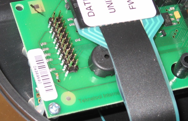

For those who are curious about the relationship with Teknatool, I think this has already been discussed, but in case there is any doubt:
[ATTACH]10377[/ATTACH]
