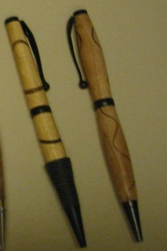

Ok I would like to see pictures of your inlays and a description of how you did them.farley wrote:thanks to this thread, I have made quite a few pens.
here is a pix of some of them.
also make pens for the troops (Freedom Pens) through the local wood turning club.
the biggest problem I have is drilling straight. I am going to try next using my teknatool chuck. Does anyone know if I put the wood in the center and tighten will it hold?
Did some acrylic turning also and a couple of inlay wood ones.
thanks all-
"Jerry! how many times do I have to tell you! Lick that knife before you put it back in the butter!" ..... Jerry Clower's Mother.
the picture above bottom row, last two on the right.
also attached it
the first one I just did a cross cut of the blank at an angle and then glued a thin piece of wood in it's place. biggest problem is having the wood the thinkness of the saw cut.
the second was more work.
before drilling the hole I cut length-wise a curved cut.
then I soaked veneer in boiling water for about 30 minutes to make it flexiable.
then I put in on the blank and clamped it.
then when dry I glued the piece right back in and clamped it.
then drilled hole and turned.
also attached it

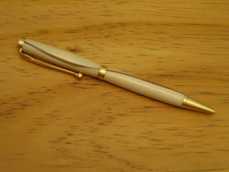

I took the inspiration form farley and came up with this.
[ATTACH]13308[/ATTACH]
Similar process but since the curve was not severe soaking was not required.
Scroll sawed a pine blank and clamped and glued 2 strips of walnut veneer for some color. Slimline in satin gold, finish is CA glue (Super glue) sanded to 600 then polished with Maguire's scratchX
Thanks for the inspiration farley.

Thanks, I like it too. Pine is a bear to turn though, super sharp tools are required because of the tear out. If using pine, turn until proud of the bushings and then get to final diameter with 80 or 100 grit sand paper, it takes a bit longer but you'll have a better result. You may also want to stabilize the pine as you go by applying liberal amounts of thin CA and letting dry.
I recommend Maple, ash or poplar for the lighter wood. I used pine for a very specific reason in this pen. I may use pine in the future for prototyping new designs as well because it is cheap.
