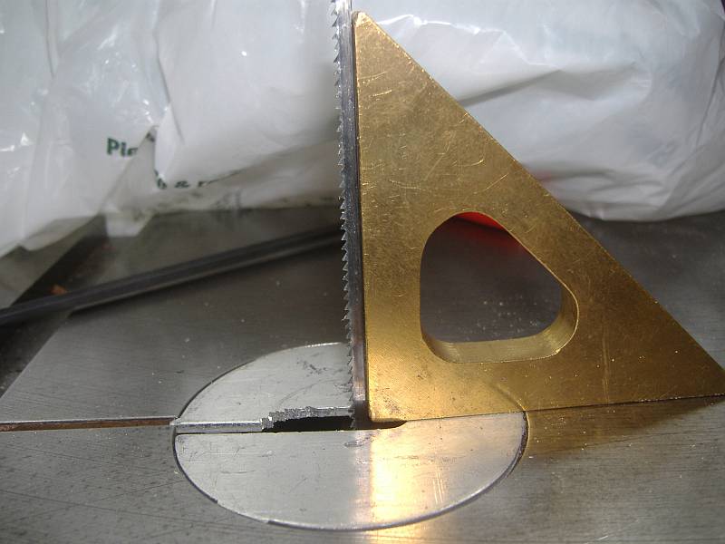

A couple of posts ago I was showing the Carter guide I had just mounted and adjusted. Then the days postings here mentioned this issue of the table and blade being off (from 90 degrees) when measuring front to back.
Reference this post:
http://shopsmith.net/forums/showpost.htm?p=109342&postcount=23
I still had the bandsaw set up with the new guide and all I had to do was re-tension blade and spin a few times to make sure the tracking was back.
When I checked this is the result:
[ATTACH]18337[/ATTACH]
Since the Carter guide requires a little tweaking at the top as part of the setup it just happened to fix the "out of square issue" too. Who would have thought. OK maybe a few people....

reible wrote:While wishing it were a cooler day outside I decided to work on some small projects so I could feel as if the day counted for something in the shop.
This is all due to the Carter guide (i.e the table is not shimmed)?
algale wrote:This is all due to the Carter guide (i.e the table is not shimmed)?
Table is not shimmed.
The Carter guide is set by going from not touching to forcing the blade forward. I do this by feel since I've had and used this system on my other bandsaw. With the top forced forward to what I feel is right also seems to negate the need for table shimming.
Since the design intent was to have the blade on an angle and assuming that is importation when re-sawing one still might want to add or remove shims when using 1/4" and wider blades and standard guides. Or with thinner blades when using the standard guides and cool blocks, and doing deeper scroll cuts.
I still do not have the hours on the shopsmith to have a feel for how much extra tuning needs to be done when changing tasks. Some people here who have had there saw for years probably have a much better feel for this.
