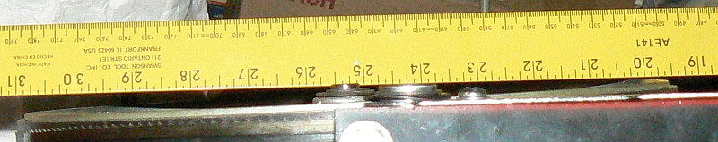

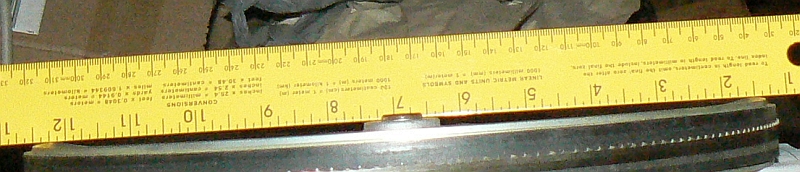

Bandsawwheelcant
I add this as a clarification(hopefully) of a way to verify the upper wheel 'cant'.
The band saw is laid on its back so the straight edge is positioned by gravity. A vice grip pliers is clamped to the 'lower' end of the straight edge and holds the straight edge by way of it acting as a pendulum.
[ATTACH]20621[/ATTACH]
The straight edge rests against the 'top' and 'bottom' rim of the lower wheel as well as the lower wheel hub(avoiding the end of the shaft)
[ATTACH]20622[/ATTACH]
The upper wheel cant is apparent by observing the approximate 1/8" space from the upper wheel rim bottom and the approximate 1/4" space between the upper wheel top to the straight edge. The straight edge does not contact the upper wheel hub.
The proper cant is indicated when a 1/4" properly tensioned blade has it's back riding 1/8" from the back edge of the tire.

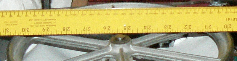

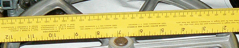

[ATTACH]20623[/ATTACH]
The last two pix show the straight edge position relative to the hubs.
[ATTACH]20624[/ATTACH]
[ATTACH]20625[/ATTACH]

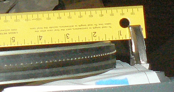

The blade is not tensioned in these pix. The band saw is the same as that reassembled above. <<<< Whoops! It is the bandsaw from the reassembling thread, not this thread!
