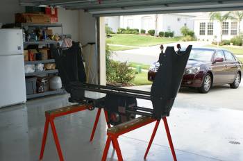

How far off the floor are the legs in the two raised positions?
wa2crk
Posts: 3080
Location: Leesburg, Fl
Post by wa2crk »
turn it upside down this way and you won't need a helper.
[ATTACH]14781[/ATTACH]
Bill V
SS upside down.jpg (67.34 KiB) Viewed 2340 times
k8tp
Posts: 22
Joined: Wed Nov 02, 2011 12:27 am
Location: Seattle area
Post by k8tp »
wa2crk wrote:turn it upside down this way and you won't need a helper.
Bill V
You can do that single-handed? :eek:
robinson46176
Posts: 4182
Post by robinson46176 »
k8tp wrote:You can do that single-handed? :eek:
Yes, works very well.
robinson46176 wrote:Yes, works very well.
Even with one arm tied behind yer back!(balance is important:D)
Actually much easier with two hands!;)
