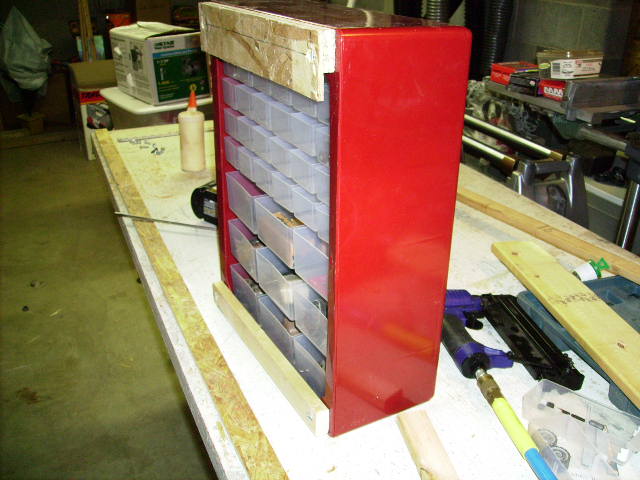

Still crawling along...
Here I am mounting a hanger cleat (glue and screws) on the back of a small parts cabinet.

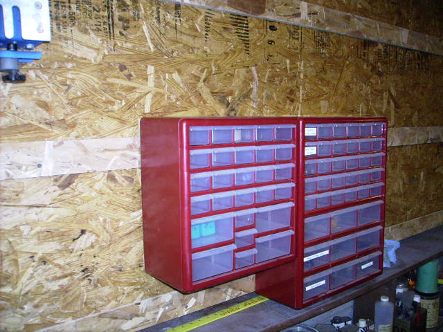

Here are two of them hanging on a panel, not in their permanent home but ready to be moved anywhere in the shop. I still have about 3 more of the larger ones unused yet. I bought them on a special deal at Wal-Mart maybe 2 years ago. One reason I bought several was because they matched the Shopsmith dark red so well (No not purple
[ATTACH]16339[/ATTACH]

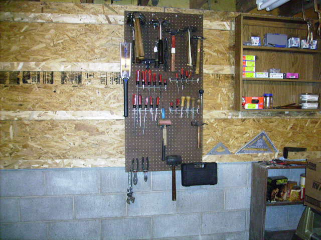

Here is tool panel I just put up. I still have about 8 or 10 of these 2' x 4' .25" tempered pegboard panels that were bought on a deal maybe 20 years ago. I will make up maybe 5 or 6 more on cleats to spot at various locations around the shop. Since they tend to carry a good bit of weight I mounted the cleat on the top of the back using four .25" countersunk head stove bolts (in addition to Titebond II and .75" air staples) with the nuts out on the front. I will probably completely shuffle the layouts a half dozen times before I am satisfied with it.
That is one of many reasons I like this wall system so much.
[ATTACH]16340[/ATTACH]
[ATTACH]16338[/ATTACH]
