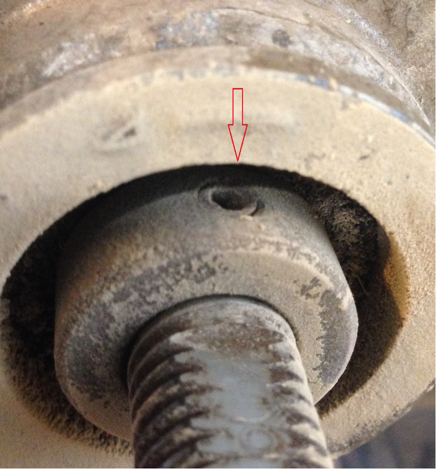

How do I oil the sheaves? I am unable to remove the belt assembly cover. It seems a ring with a hex key set screw is over the right output arbor shaft. Thanks
Re: The Ultimate Sawsmith Radial Arm Saw Thread
It sounds like there and arbor or some other accessory on the right shaft, loosen the set screw and remove that arbor/accessory. then remove the cover.bob84 wrote:How do I oil the sheaves? I am unable to remove the belt assembly cover. It seems a ring with a hex key set screw is over the right output arbor shaft. Thanks
See the manual page 12. http://vintagemachinery.org/pubs/791/3287.pdf

I am trying to oil the sheaves and thus need to remove the belt guard cover.
I can remove the four screws that hold the belt guard in place. However, a collar ring is held on by this hex set screw and not being able to get the hex set screw off the arbor prevents me from getting the belt guard cover off.
There is not enough clearance to get a hex key wrench into unscrew the hex set screw (see red arrow in the picture).
Anyone know what is the size of the hex set screw? Or what is the procedure to remove the hex set screw and belt guard cover. If I knew the size of the hex set screw I thought I would grind off an hex key wrench to the correct length to fit between the belt guard and into the collar.
