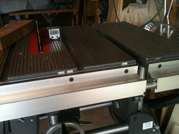

table tilt lock - another way
I have yet to implement Dusty's fix due to ongoing projects - more fun than maintenance I will admit.
So I adjust the table to 90 deg, raise the table to cutting height and lock it to the right aux table with 3' tubes.
[ATTACH]27015[/ATTACH]

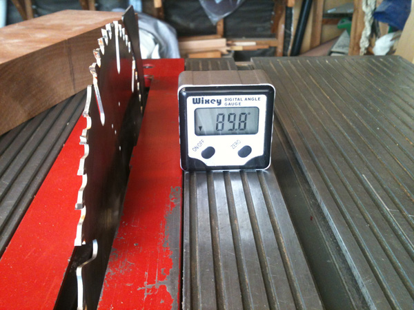

I had left the Wixey on the table to see how much the angle changed in raising the table to the desired cutting height and tightening the tubes. It did change a wee bit:
[ATTACH]27016[/ATTACH]
As I was locking the aux table, I noticed that slight up or down pressure on the aux table would make a minor change in the table angle. Perfectly reasonable.

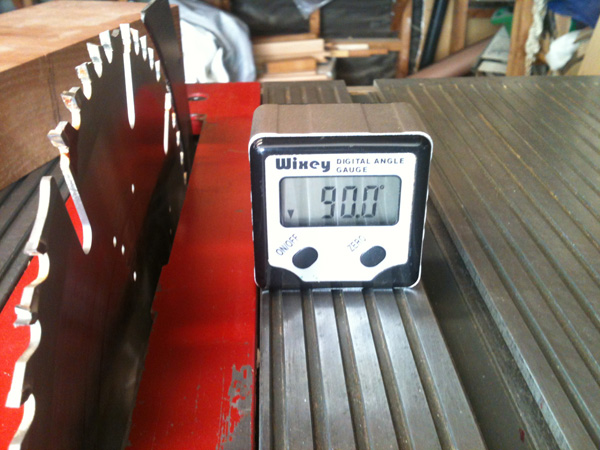

By really only using pressure on the aux table tube I was able to lock the table back to the 90 deg originally set.
[ATTACH]27017[/ATTACH]
Since the aux table movement is so small I do not believe the table is being 'warped' and will use this method from now on.
Even with a fix for the tilt lock I think that I will always use aux table support when a 90.0 degree cut is needed.
I have to trust something and Wixey gets it.
