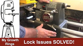

Shopsmith Headstock Lock, Carriage Lock and Jointer Fence Issues and Mysteries SOLVED!
Post by Chad »
Watch it here: https://www.youtube.com/watch?v=tSpYlXF ... B&index=42
The Shopsmith Headstock and Carriage lock are cool little mechanical marvels, but they might not work quite as you expect. In this video, I'll walk through their use and tell you about an issue I had with my jointer right after I turned the camera off last week.
Here's "The Shopsmith Mark V 5-Point Safety Check (+1)" video: https://youtu.be/Y2DApzMn2yg

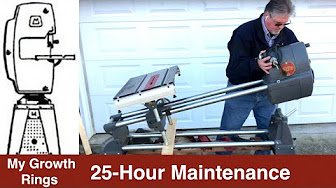

Removing & Lubricating a Shopsmith Mark V Headstock & V-Belt (Critical 25 Hour Run-Time Maintenance)
Post by Chad »
Watch it here: https://www.youtube.com/watch?v=UT6vfZsJ7OI
Every 25 hours of run-time your Shopsmith Mark V's headstock needs to be oiled in two places. This can be done with the headstock on the machine, but to make this a little easier to film and to show how easy it really is to remove for more in-depth maintenance, we'll go ahead and pull the headstock off. While it's off we'll pull the V-Belt, just to show how easy that is, for the day when you'll eventually need to replace yours.
Products used in this video (in no particular order):
- Here's the oil I use to lubricate the sheaves: https://amzn.to/32IkpAQ
- "Shopsmith Toolbox" AKA: Long 5/32 Inch Cushion Grip Hex T-Handle T-Key Allen (hex) wrench: https://amzn.to/3n5iezc
- Powdered Graphite: https://amzn.to/3kbTpj1
- Small magnetic parts tray: https://amzn.to/32K5shy
- Super-handy magnetic base flexible gooseneck LED light: https://amzn.to/3pyb20z (Pair) https://amzn.to/2IHis0C (Single)
