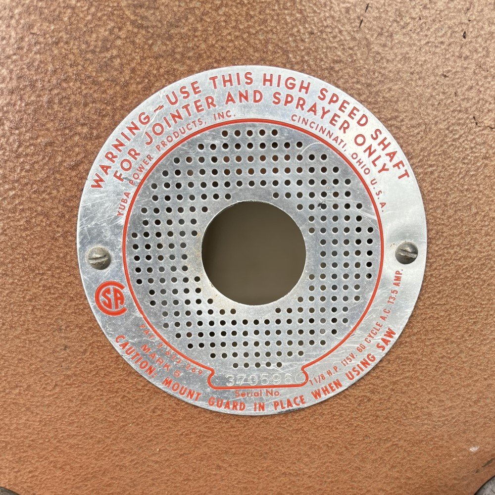

Today I am back on the subject of the Goldie Mark 5 with the C suffix for the serial numbers discussed on page 9. Why you may ask. Well Saturday I bought one and can do some comparisons myself which may add to the information we discovered with John’s Mark 5 Goldie serial number 369904C. Mine is serial number 370596C and the Vent/Serial Number Plate is shown below. When the Gilmer Drive changed to Poly V Drive the Serial numbers above 371347 are Poly V and began in May 1961. This means there were at least 1443 “C” units made going by John’s serial number and the serial number at the change.
_
John’s Mark 5 Goldie was made in March of 1961 and mine was made in April 1961. The first thing I notice when looking at the Vent/Serial Number Plate of mine compared to John’s is his lists a ¾ HP Motor while Mine lists a 1-1/8 HP Motor which by the way is an A. O. Smith 1-1/8 HP Motor. This puts the change from the ¾ HP Motor to the 1-1/8 HP Motor between March and April of 1961.

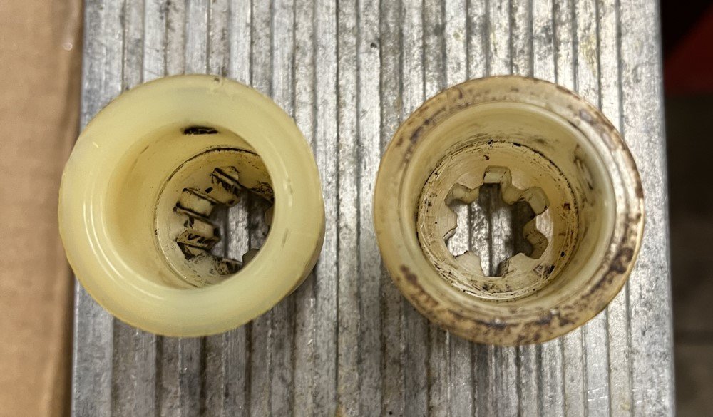

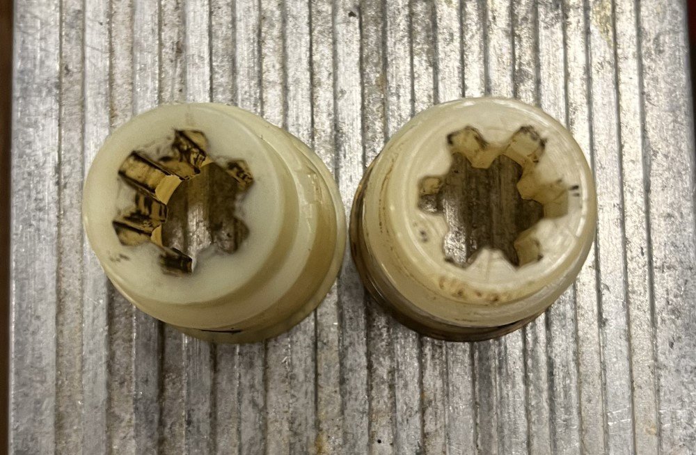

I did compare side by side the Drive used on this “special” C Drive Sleeve Assembly with the one from a Mark 2. They do indeed look the same but are not interchangeable. The shaft on the Mark 5 C Drive Sleeve Assembly’s outer diameter is smaller than that of the Mark 2. In the pictures below the two are side by side with the Mark 5 one on the left and the Mark 2 one on the right. From the Quill end in the top picture they look the same but in the bottom picture you can see the difference in the diameter.

Sorry these parts do need some cleanup work as part of their restorations.

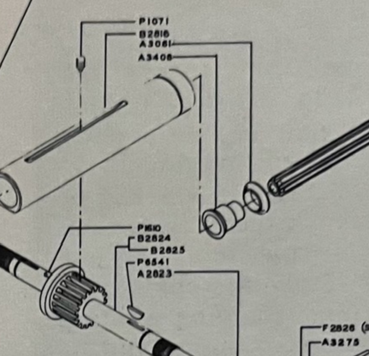

chapmanruss wrote: Sat Mar 27, 2021 4:01 pm 1959 The nylon cap was added to the drive sleeve to reduce noise. (Note: this change 1st shows up in the 10:56 Manual and is not in the 10:55 Manual)
Russ - you know much I love minutia of this sort in the history of the Shopsmith! Well, my efforts to restore Serial Number 298187 should provide you another point of reference on the above topic.
So, my prior experience restoring Greenies is with the earliest models (1954 and “pre-1954”). But when I pulled apart this machine (dated approximately June 1955), I saw a nylon collar on the drive sleeve that has only been attributed to later models:

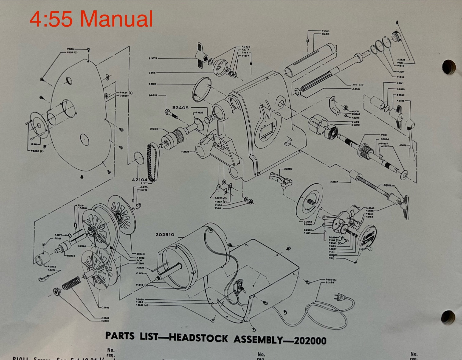

And since you mentioned the appearance of this innovation in the later manuals, I next went back to the archives to see if there was any reference to this feature in the printing of the manual targeted for this manufacturing date. Sure enough, in the 4:55 printing, there it is…
Surprisingly, the feature disappears in some subsequent manuals (8:55 and 10:55 printings), only to reappear in the 10:56 printing as you mentioned above, albeit drawn in a different location and with a different part reference number.
I wonder if any early ‘56 model owners could confirm the disappearance of the nylon collar on any of that vintage of machine…

chapmanruss wrote: Thu Mar 14, 2024 1:01 pm the nylon collar is A3408 in the exploded view but is B3408 in the parts list.
…actually, it’s B3408 in the older (4:55) manual, and A3408 in the newer (10:56) manual. Parts list and exploded view are consistent within each printing. ;)

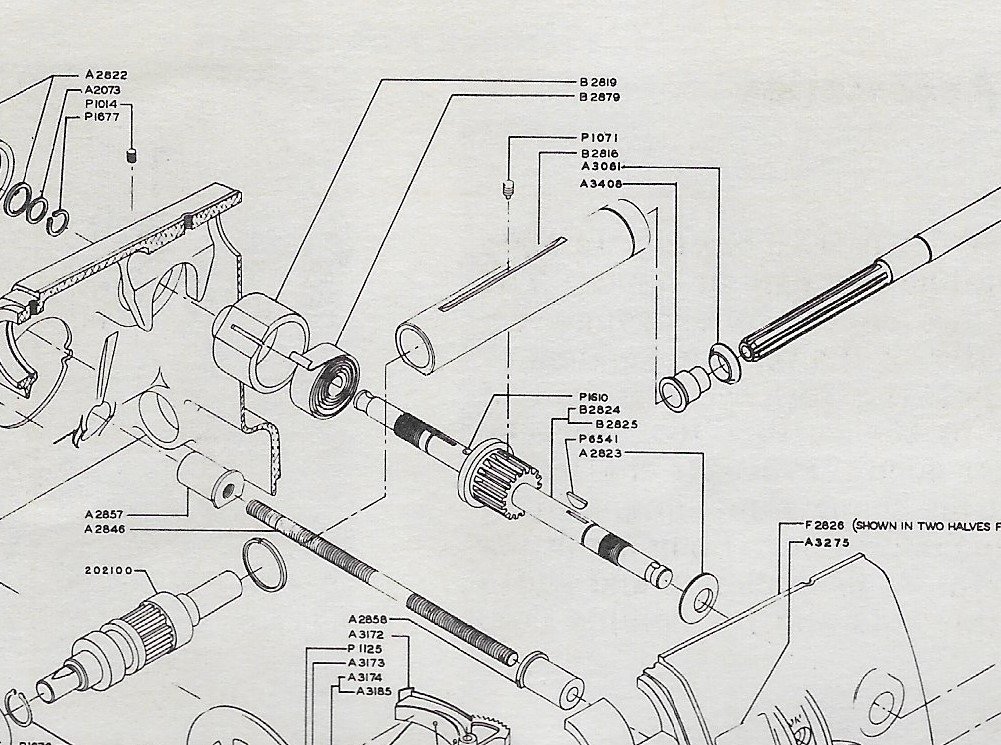

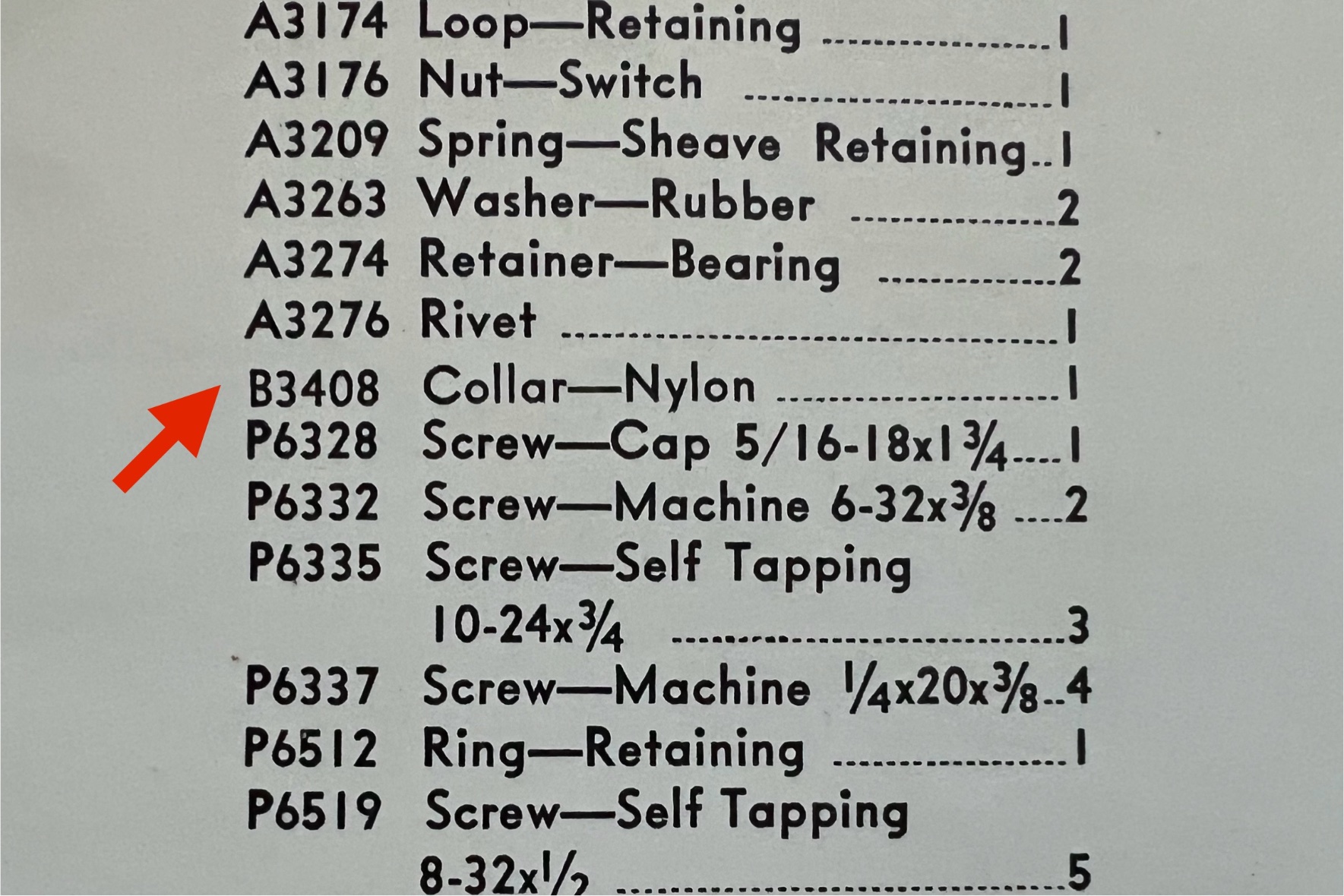

Below is page 26 of the 10:56 Owner's Guide. The nylon collar is A3408 in the exploded view but is B3408 in the parts list. That is what I was referring to.
_
Sm Page 26 r.jpg (188.45 KiB) Viewed 69705 times
Note in the close up below it is A3408
