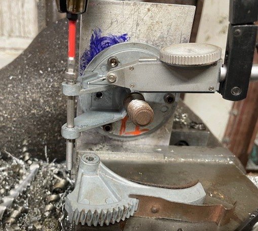

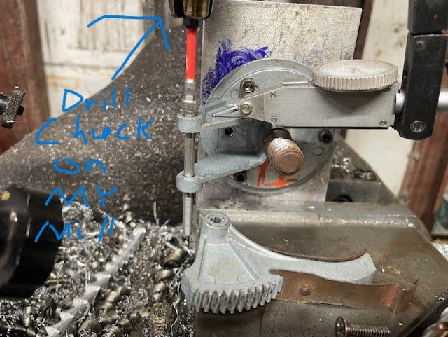

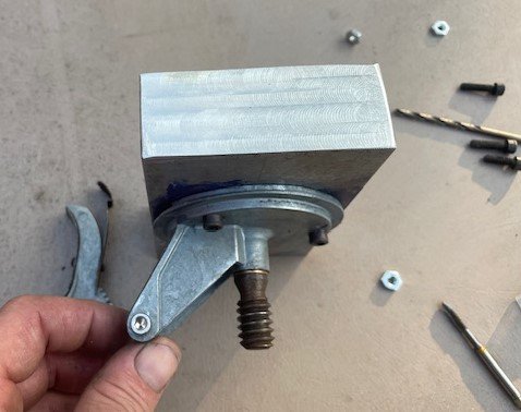

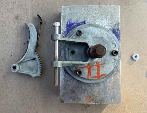

A little more progress.
I machined a Block to mount this to /so I could straighten the arms.
I used my mill/drill as the press.

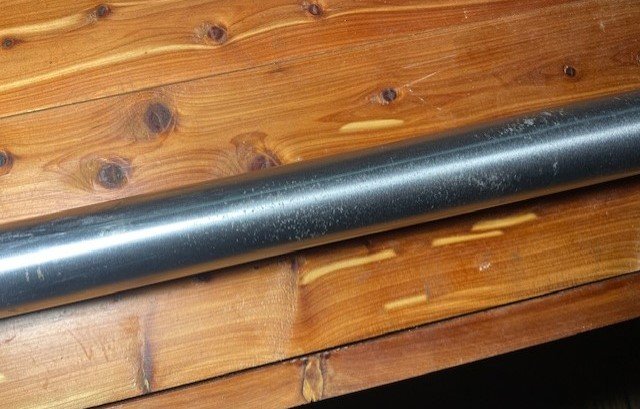

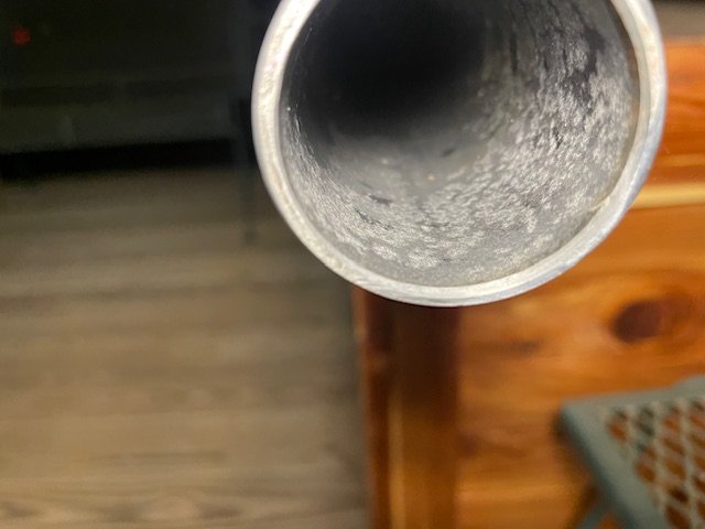

Front/top way tube out of the Bath.

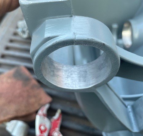

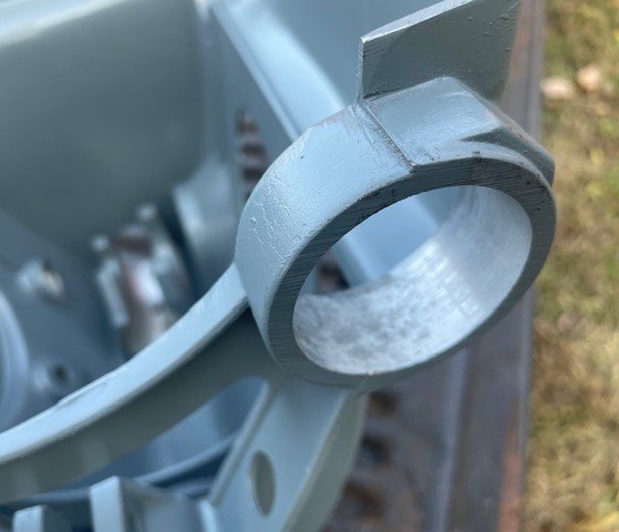

Tonight's progress.
Time is changing and some of the pictures are poor quality.

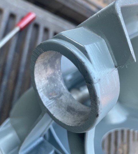

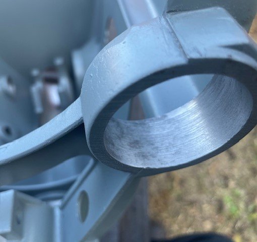

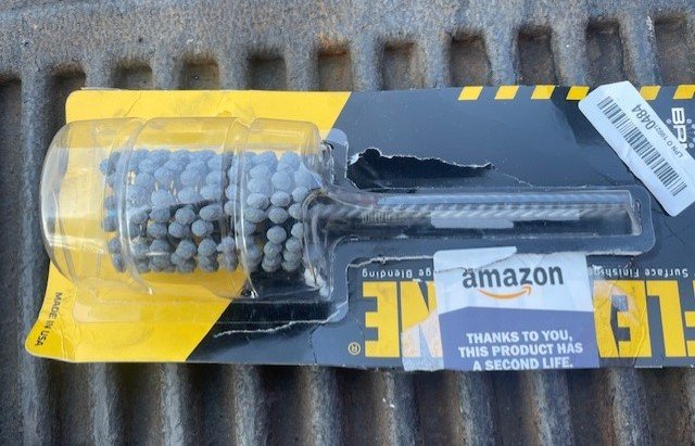

This is a before picture of when I hand honed this bore with a 800 grit Silicon carbide Hone that is pictured below.
After Picture .
I was impressed that It did not take much, if any material.
It just smoothed the surface up.
Before picture of this bore.
Then this is an after picture.
I used the Vice Grips to drive this hone thru the bore smoothly.

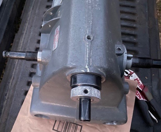

And now Preassembly of Headstock.
I Have A Question???
What putty to use to fill these 3 Set Screws back in with?
After Picture .

- Posts: 4209
Re: Restoration of Mark V / produced on 11/84
Since you have to remove or a least back out the Set Screw to remove the Quill for maintenance don't bother refilling that one with putty ever. It should not have been done by the factory originally. As for the Quill Return Spring and Collar lock set screws, they don't need removing nearly as often, if at all, but just in case why bother filling them up with something that most likely will need to be removed sometime in the future. Refilling those set screw holes with putty is one thing I do not replace to make it as it came from the factory in my restorations. Just my two cents worth.
All SPT's & 2 Power Stations
Me too, so that's four cents. Especially the quill guide setscrew, which I back out regularly to wax the quill and bore.chapmanruss wrote: ↑Wed Oct 30, 2024 1:46 pm Refilling those set screw holes with putty is one thing I do not replace to make it as it came from the factory in my restorations. Just my two cents worth.

Thank You.chapmanruss wrote: ↑Wed Oct 30, 2024 1:46 pm Since you have to remove or a least back out the Set Screw to remove the Quill for maintenance don't bother refilling that one with putty ever. It should not have been done by the factory originally. As for the Quill Return Spring and Collar lock set screws, they don't need removing nearly as often, if at all, but just in case why bother filling them up with something that most likely will need to be removed sometime in the future. Refilling those set screw holes with putty is one thing I do not replace to make it as it came from the factory in my restorations. Just my two cents worth.
I value your opinion.
I was thinking along the same lines.
This putty was (To keep the not so Knowledgeable person from making a mistake) installed at the factory for people that are not aware.

This is Definitely worth 4 cents.DLB wrote: ↑Wed Oct 30, 2024 7:22 pmMe too, so that's four cents. Especially the quill guide setscrew, which I back out regularly to wax the quill and bore.chapmanruss wrote: ↑Wed Oct 30, 2024 1:46 pm Refilling those set screw holes with putty is one thing I do not replace to make it as it came from the factory in my restorations. Just my two cents worth.
- David
I was thinking of how to keep the Teeth of the Quill clean.
