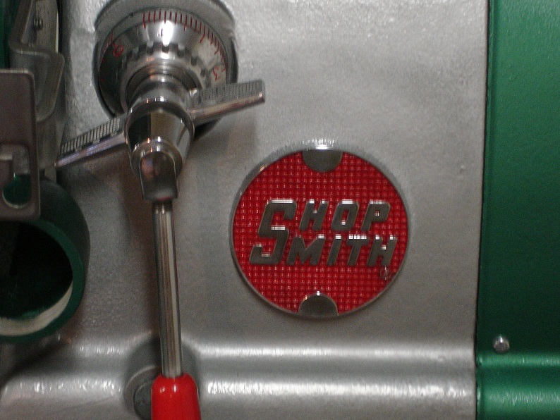

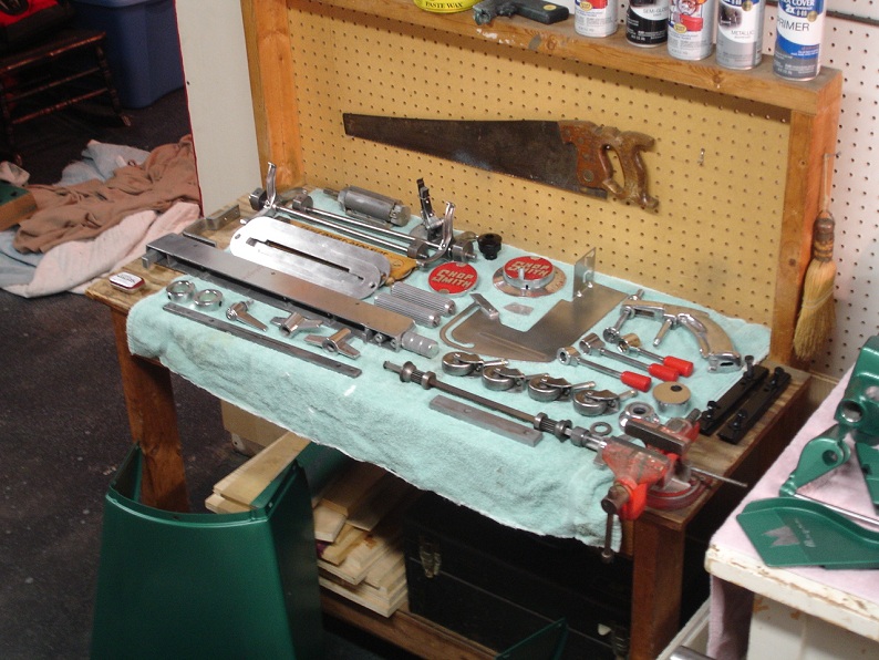

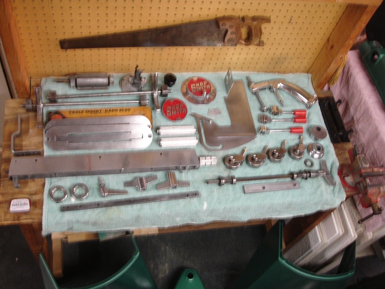

donalexander wrote:Great job. I'm curious what you're doing to get the speed control to shine better than new? I'd like to do it to my 510 (soon to be 520...well, as soon as SS gets around to filling my order).
Don
Polishing all the aluminum was the most time consuming part. Not too hard, but it took a lot of patience. First step was to take everything apart so I could work on the individual pieces. I started with a coarse metal sandpaper and worked my way through to the finest paper I could find. I then moved on to using my dremmel with a polishing compound. For the next and final round of polishing I bought a polishing set and used my drill mounted in a vise. (I now use my shopsmith unit for this step - I am able to get a higher speed and a better, faster shine) Finally I buffed it with a soft cloth and now try to keep a light coat of paste wax on them. To paint the speed control and the parts with numbers I used red model paint and a small brush, after several coats I had a nice deep color. I always kept a paper towel nearby that I had dipped in mineral spirits. If I made a big mistake that easily wiped it off. The attached pictures show many of the aluminum pieces from the main unit that I did.
