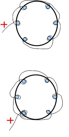

I have a couple of questions about the electrolysis process. Hopefully they will contribute to the discussion and not be a thread-jack.
First, when wiring the anodes together, do you make a complete circuit or not? Does it matter since the circuit essentially completes through the solution?

If your using more than one electrode as the anode (+), all you need to do is connect them, for example, one piece of wire. No need to run a second piece back to the positive lead.

mickyd wrote:If your using more than one electrode as the anode (+), all you need to do is connect them, for example, one piece of wire. No need to run a second piece back to the positive lead.
If I am understanding correctly, a setup like the top picture is ok, and a setup like the bottom picture is not necessary.

TECHNICALLY, for the process of electrolysis, there is no difference between the two. In both pictures, the rods (+) are all connected together and in turn are connected to the positive terminal of the power source.
The circuit is completed via the solution to the negative lead which is connected to the item to be derusted. Avoid making direct contact between the rusted item (-) and the anodes (+).

hobbydad wrote:If I am understanding correctly, a setup like the top picture is ok, and a setup like the bottom picture is not necessary.
[ATTACH]8698[/ATTACH]
--Loren
Your correct. Both methods are ok but the extra connection on the last photo isn't required.

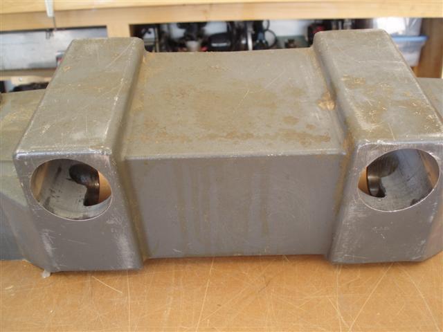

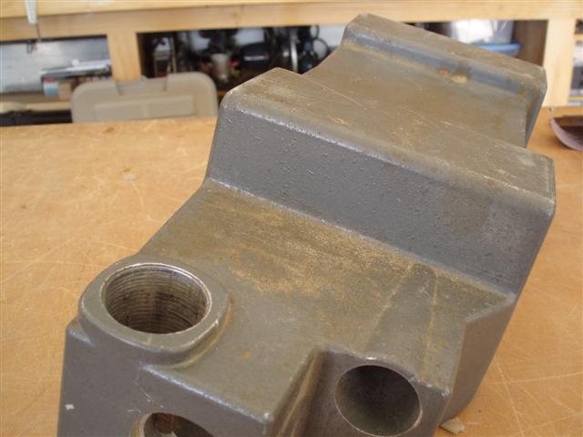

The carriage that was scheduled for electrolysis is an ebay special and it looks horrible. No corrosion. Just somehow stained and somewhat rusty (corroded).
It was to be an experimental restoration before I start on something more valuable.

dusty wrote:The carriage that was scheduled for electrolysis is an ebay special and it looks horrible. No corrosion. Just somehow stained and somewhat rusty (corroded).
[ATTACH]8699[/ATTACH] [ATTACH]8700[/ATTACH]
You can try it dusty but from what I've read, you need to visually check it often for pitting. My aluminum table insert was in the tank for a total of ~45 minutes, checking it every 10 minutes and in the end, wire brushed quite nicely with no sign of pitting. With your part having paint on it, I don't know how long it will take to remove the paint and get down to base metal. If you have nothing to loose, and you have time to babysit the process checking it often, give it a shot. I'd be really interested in your results. My thinking is even if it pits the aluminum, texured paint will hide it. And even if the way tube bearing surfaces get pitted, so what.
