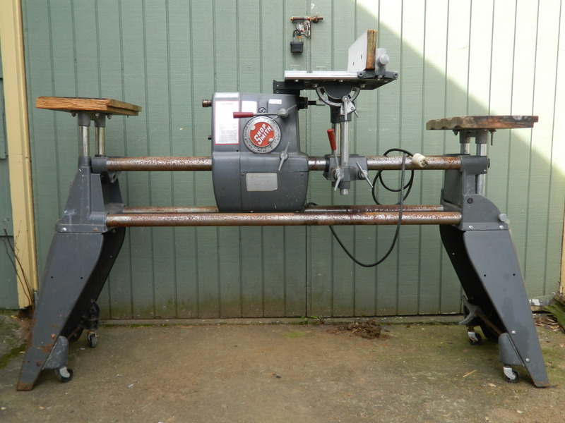

I've been looking for a Shopsmith off and on since I saw pictures of them in the book Workshop Lust but never could connect until last weekend. My son wants to make Nutcrackers to add to his Mom's collection for Christmas. Never one to miss the opportunity to justify a new tool purchase (that's what projects are for, right?) I immediately started looking for a lathe. As I looked on CL one morning a Shopsmith had just been posted, no picture. After the kids were in school we headed out there.
here's the driveway pic:
[ATTACH]16630[/ATTACH]
AFTER making this purchase I found this forum, so I really didn't know what I was getting, but I found this place through a link from OWWM.com, so I sort of know the drill. A couple of things I could see right away, one was the amazing amount of corrosion and pitting on the aluminum table.

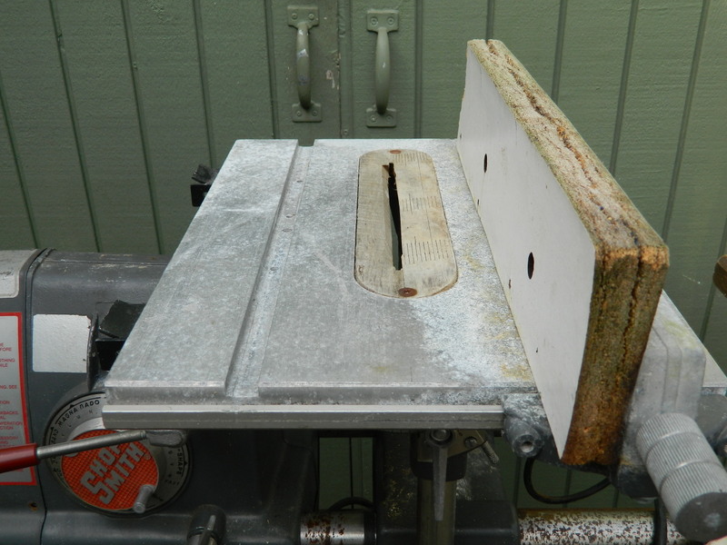

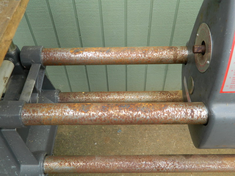

I attribute this corrosion to the piece of laminate bolted to the fence. the machine had been stored in a barn so the way tubes have rust like this:
[ATTACH]16632[/ATTACH]
Gotta make a long spooge tank or try some evaporust- can't even move the carriage.

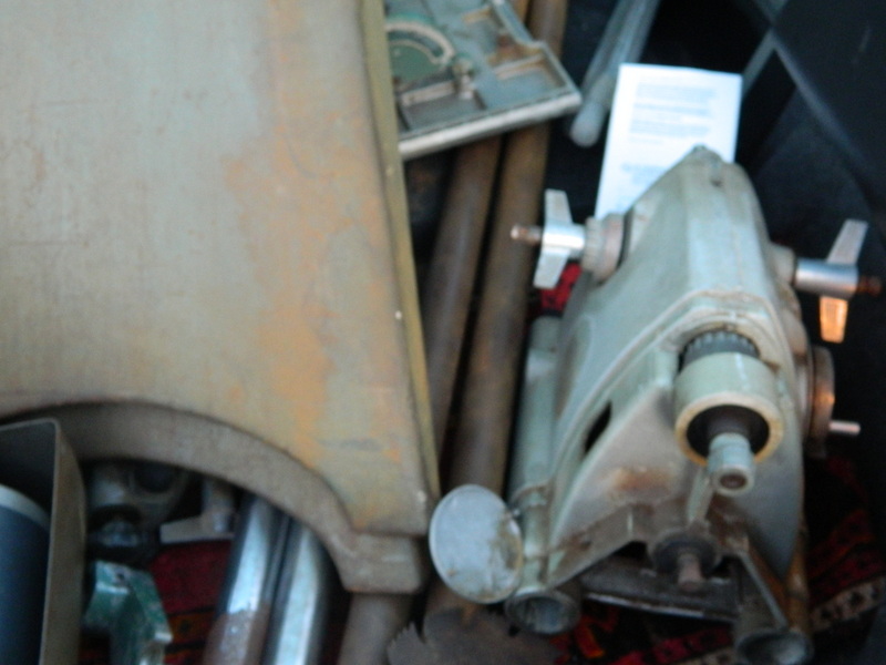

The next day I notice someone selling some Shopsmith parts including a table which I more wanted than needed since my first intention was a working lathe. It turns out that the PO has an entire Shopsmith already disassambled with a bad motor. So I went to see and by now I know more what I'm looking at- it's an old Greenie without the opening behind the headstock logo. The PO sez the motor didn't run well or bogged down and a local shop quoted $75 to clean contacts (?). This is how it looked in the back of my vw:
[ATTACH]16633[/ATTACH]

If the motors are running they are both salvageable.
I had problems with my motor "bogging down" until I rectified a few issues.
Number 1 is alignment this is by far the biggest cause for poor performance when sawing.
Number 2 was proper speed selection. Try a slower RPM with a slower feed rate on more dense materials. Slower RPM means more torque.
Number 3 Sharp Blade/Tools I don't care how powerful a machine is, if the blade/cutting tool is dull it will only make heat and perform poorly.
I recommend new bearings in both of them. Should be able to do for less than $50 per machine, depending on your bearing preference.
I also recommend replacing the belts while you have everything torn down. I don't know if the table on the first is salvageable or not. As long as you have one table that fits both all you really need is one. The bench tubes and way tubes should be salvageable.
Pick whichever has the best runout for the lathe/drill press. Don't even bother checking the runout until bearings are replaced.
